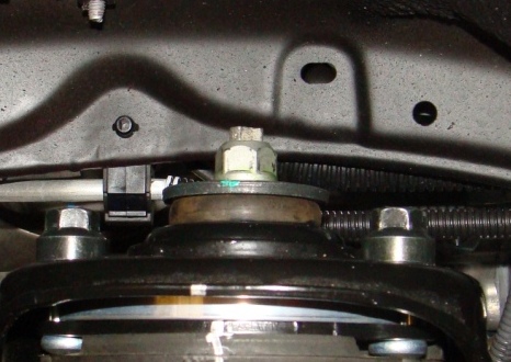

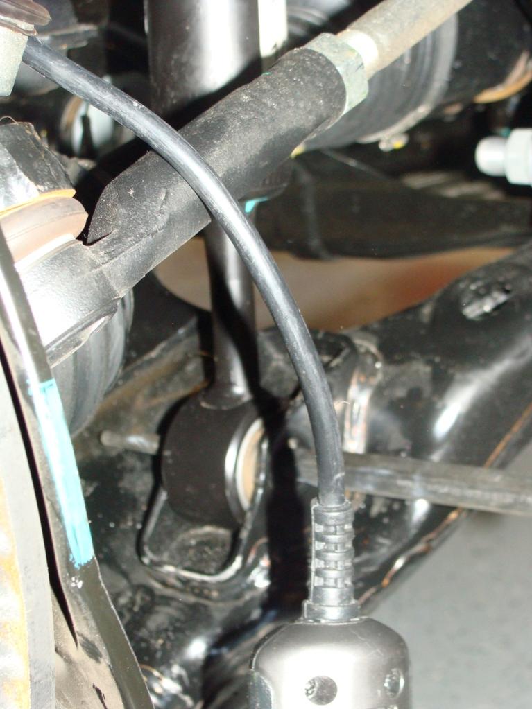

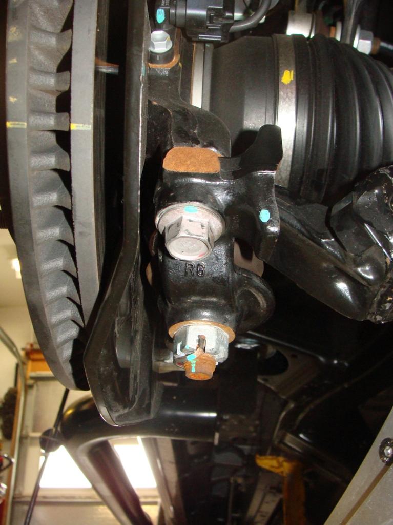

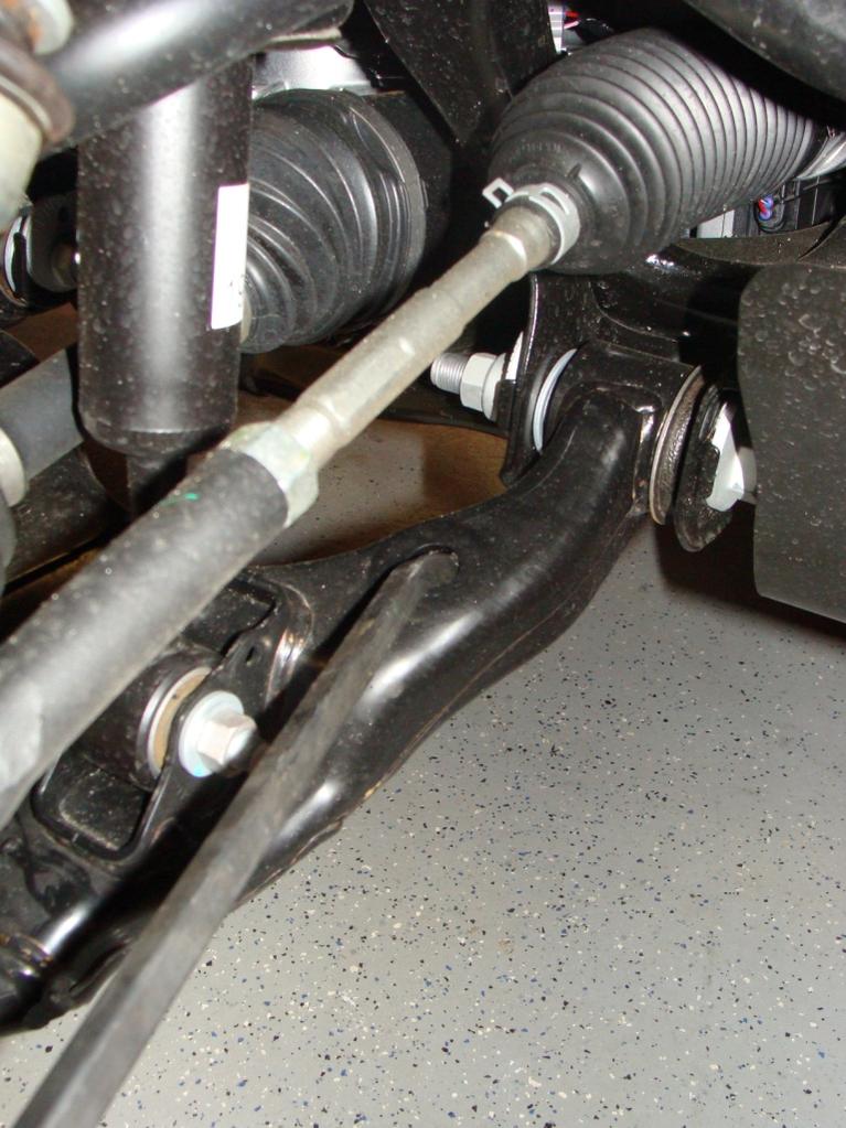

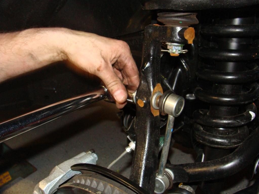

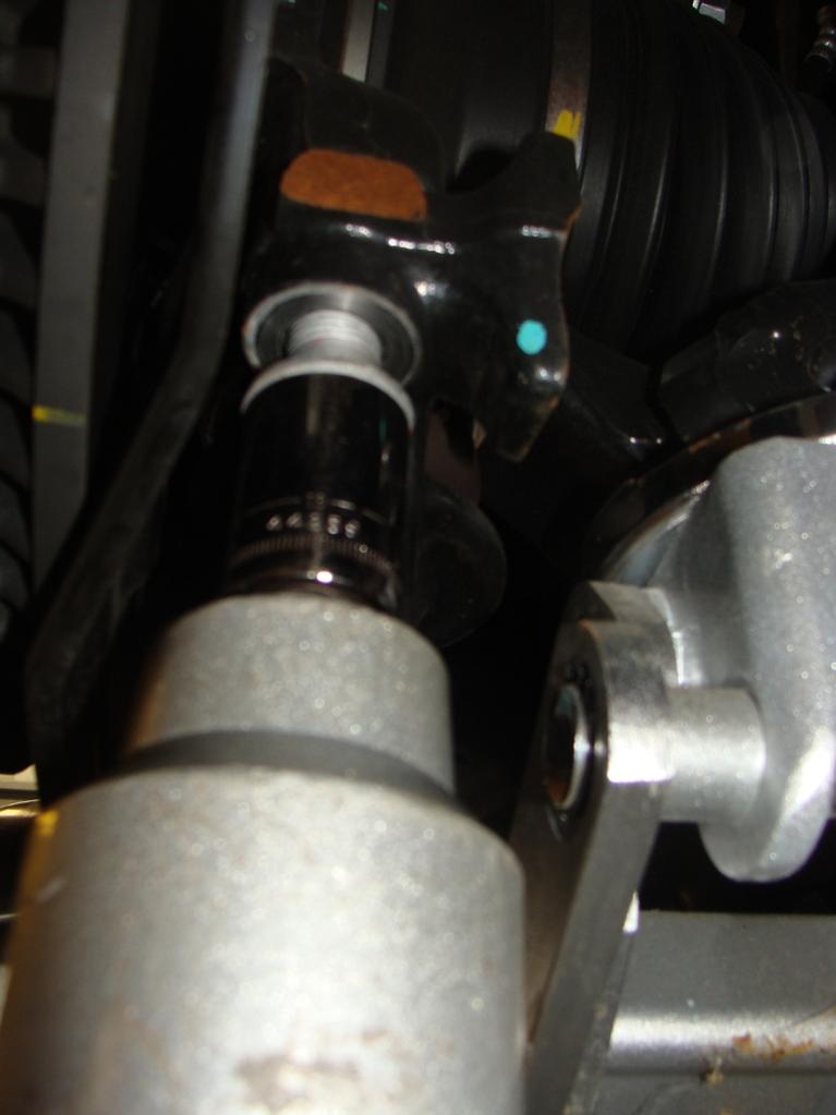

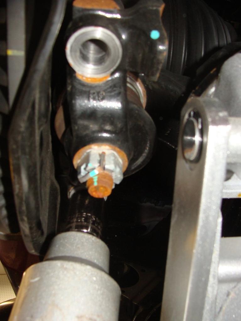

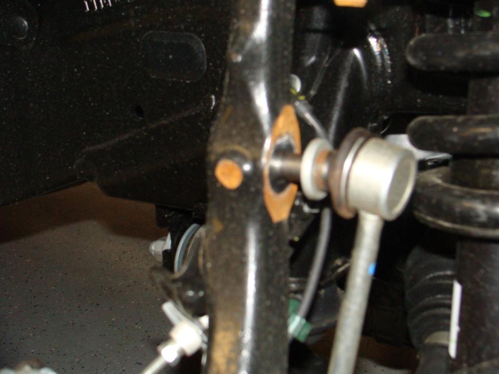

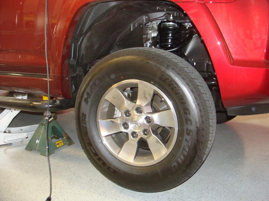

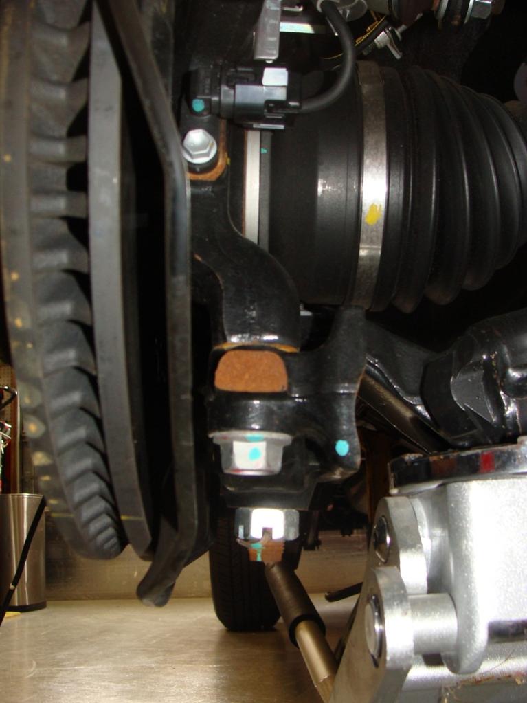

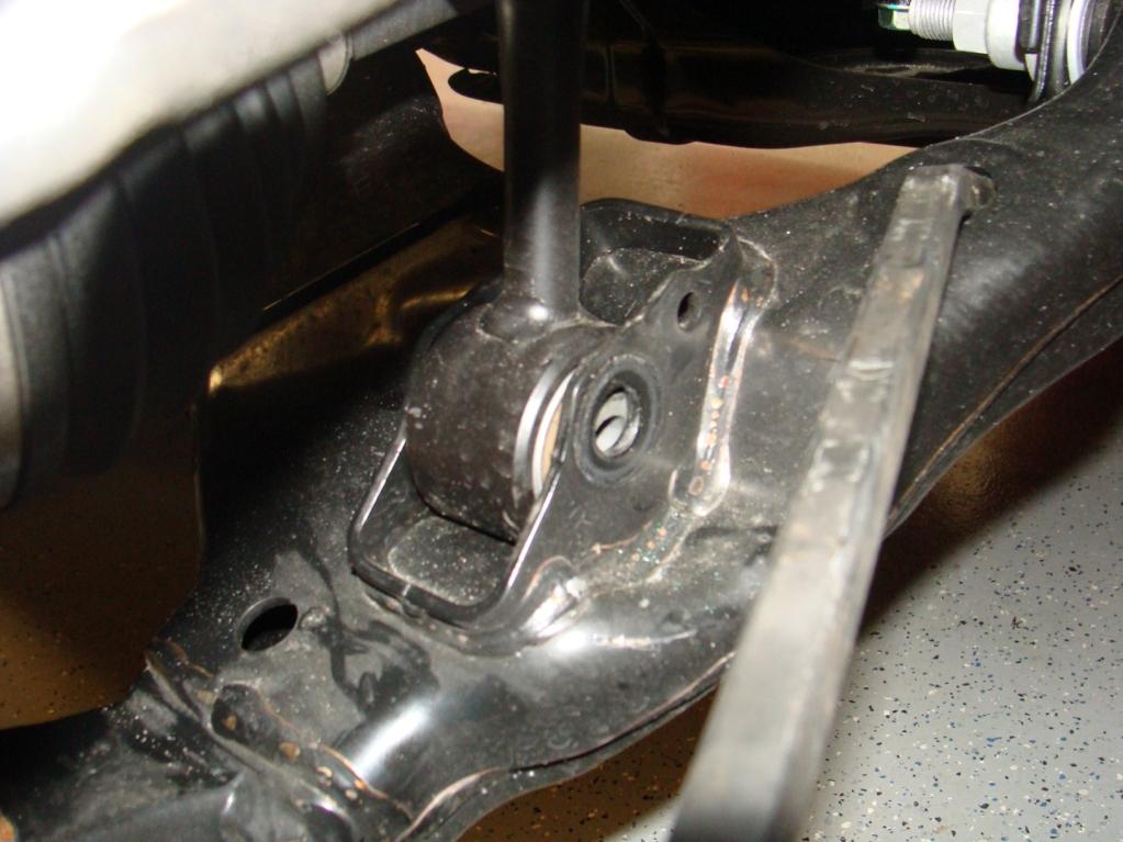

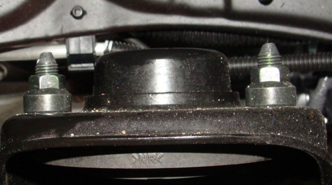

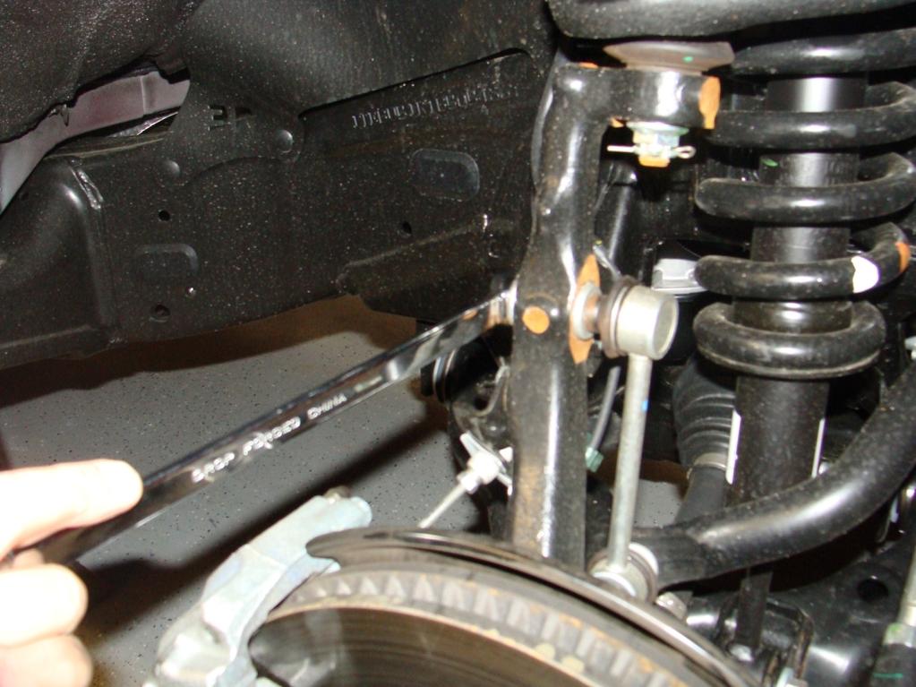

Step eight: Remove the nut and disconnect the stabilizer link from the steering knuckle. You may need to use a 6mm allen wrench to hold the stud if it rotates with the nut.
Step nine: IMPORTANT NOTE about this step: In step 6, we put the jack under the lower control arm. It should still be there. If somebody takes these next 2 bolts out without being careful and following directions (to quote Antman) "it could wind up being a bad, bad day." Remove the two large bolts just behind the rotor (but not the odd shaped one between the two of them). Now you slowly lower the jack to release the spring pressure.
[continued on next post]

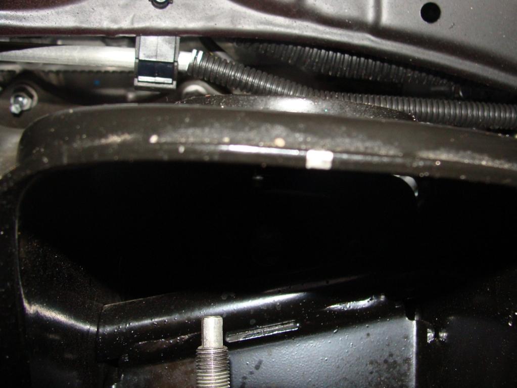

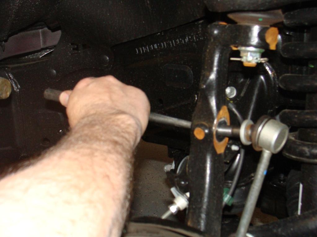

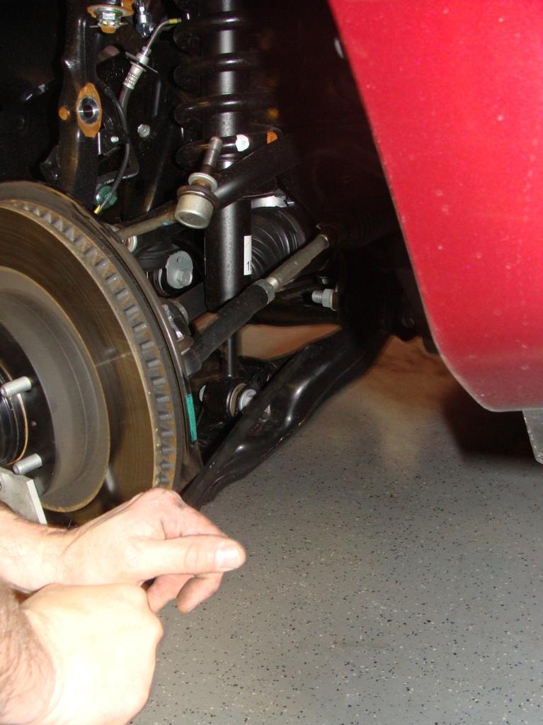

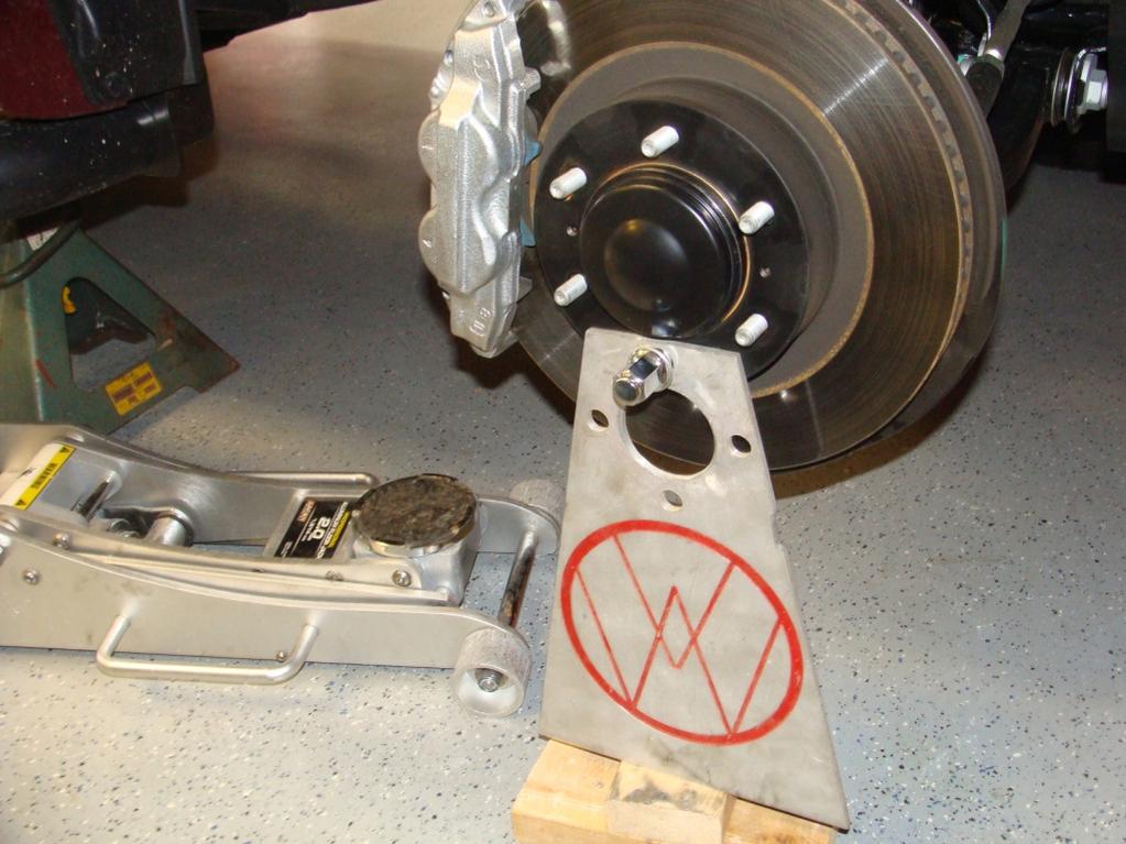

Modification: Toytec Top Plate Spacer Lift (cont.)

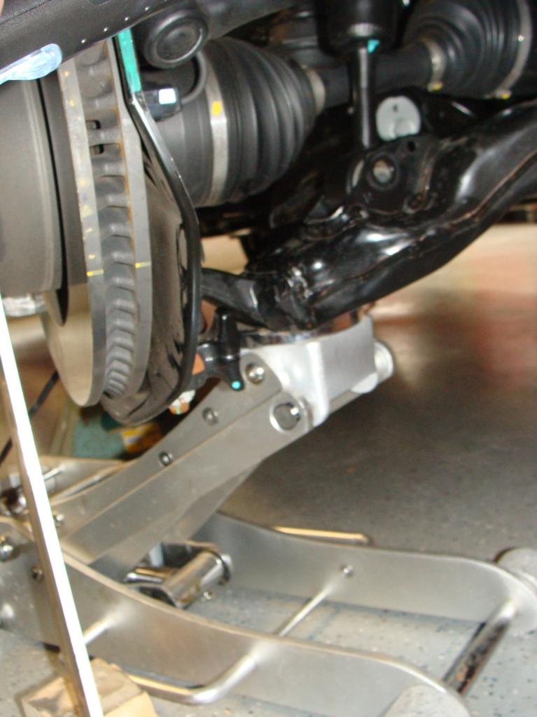

Step ten: Prop up the rotor so it doesn’t fall and ruin your CV joint.

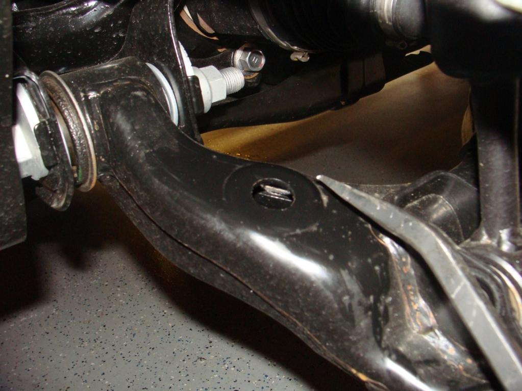

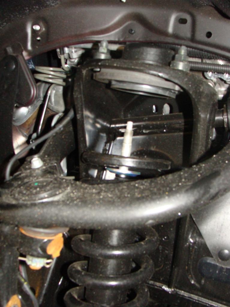

Step eleven: Insert a pry bar into one of the holes in the arm where the bottom of the shock absorber is mounted and push down on it to relieve the pressure on the bolt at the bottom of the shock.
(note, these pry bar openings are on both legs of the suspension system...you can use either side)
Step twelve: Remove bolt, nut, and washer from bottom of shock absorber.
Step thirteen: Apply downward pressure to pry bar again, and work the shock and springs out of the top support.
Step fourteen: This leaves three nuts that you have to remove from the three studs holding the top cushion in place. Here are two of the three studs in question (third is in the back):
Step fifteen: Loosen nuts from studs…but DON’T take it apart yet.

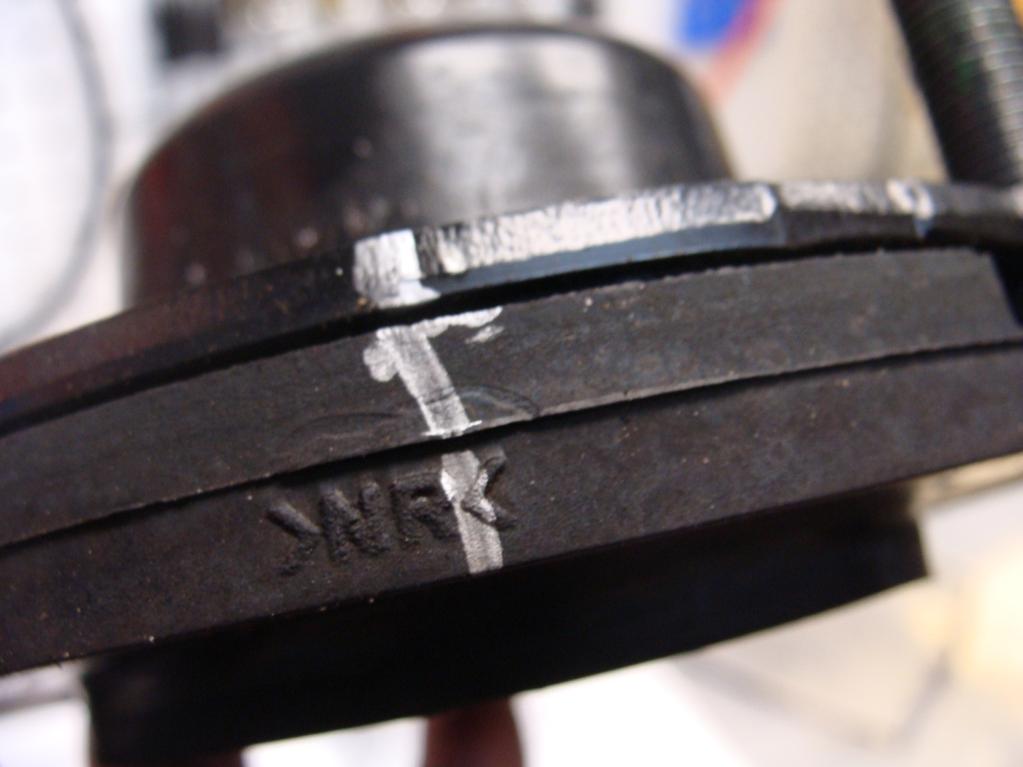

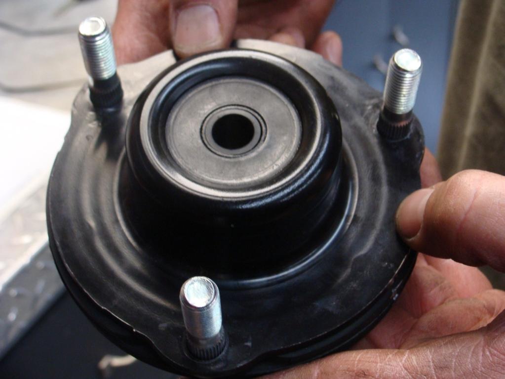

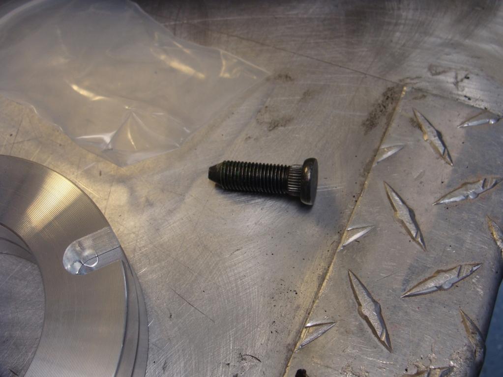

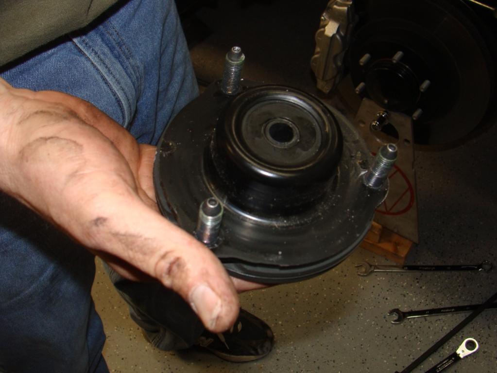

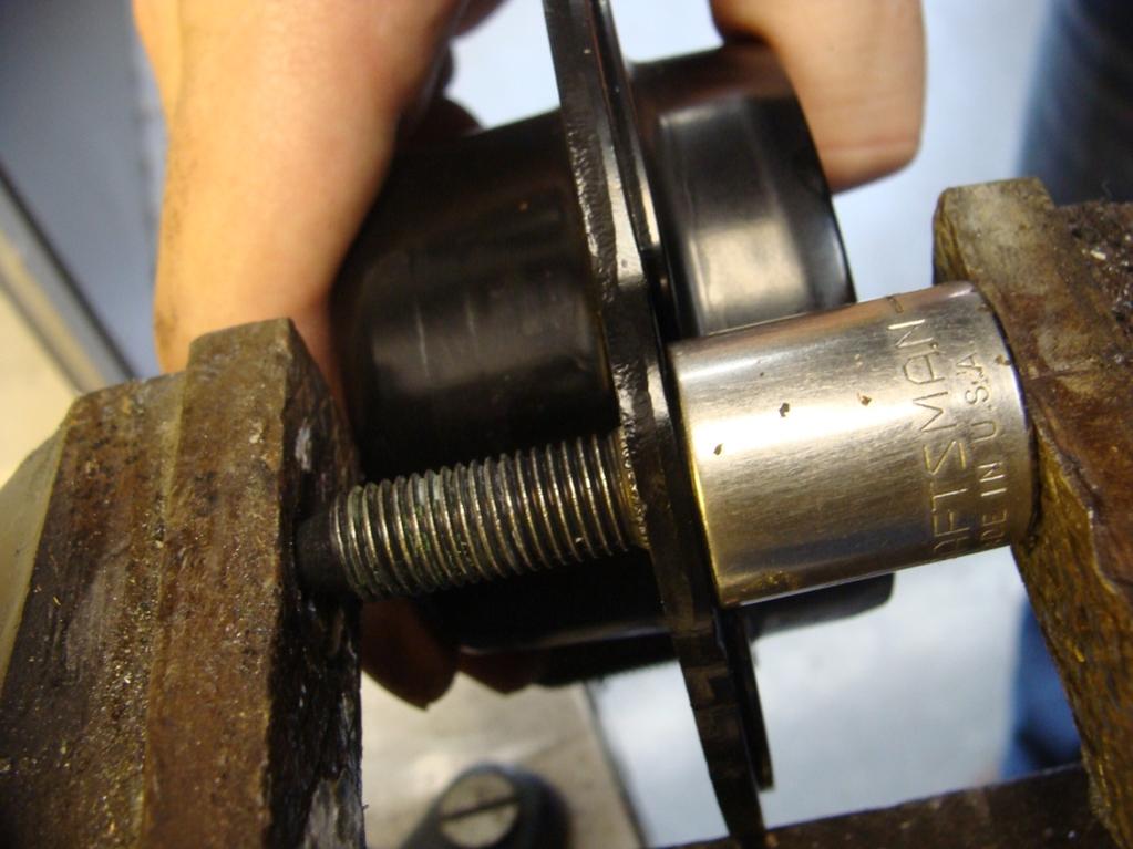

Step sixteen: Before disassembling this cushion from the top of the shock absorber housing, hit it with a silver Sharpie or something that can mark alignment for reinstallation.
Step seventeen: Remove nuts from studs and take out cushion assembly.

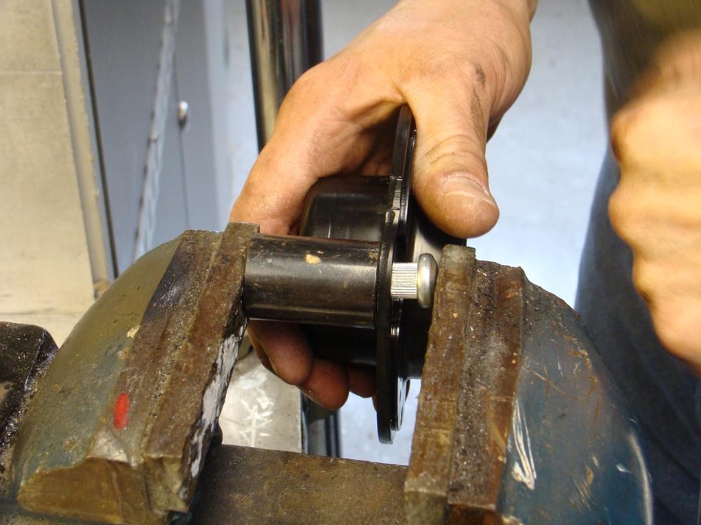

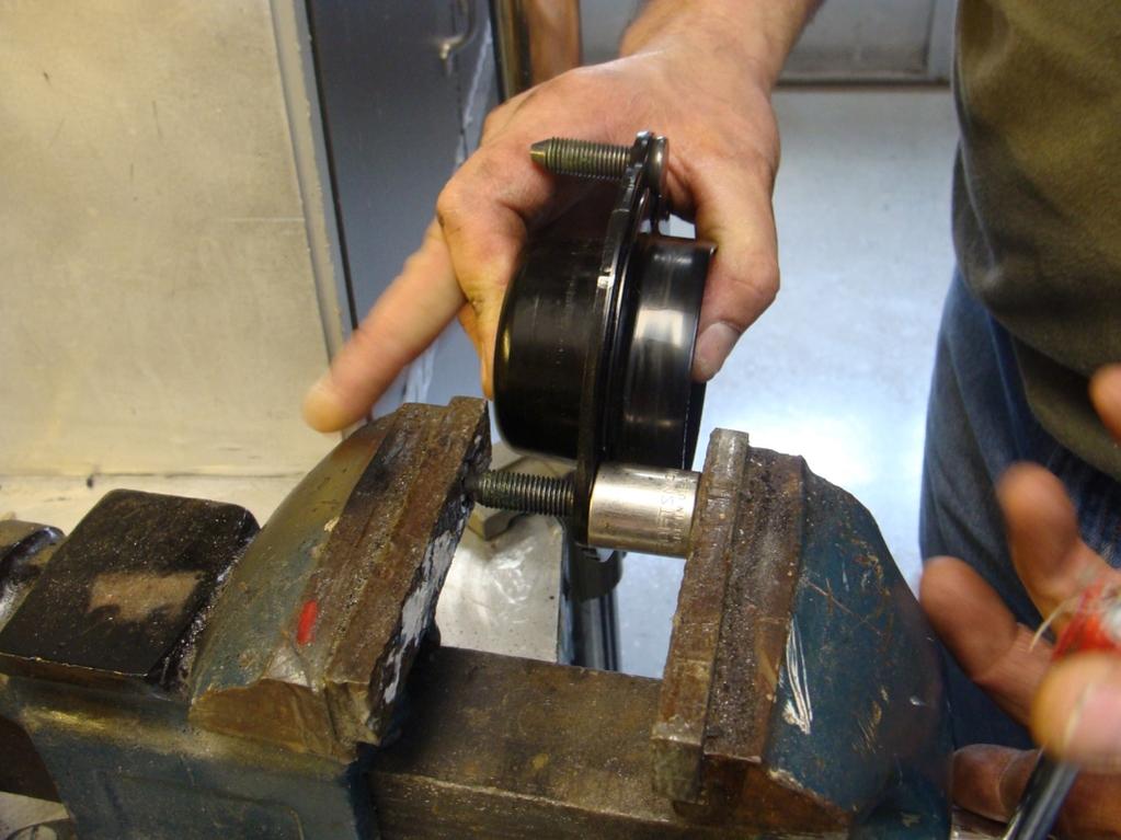

Step eighteen: Press out OEM studs from rubber cushion using a vise.

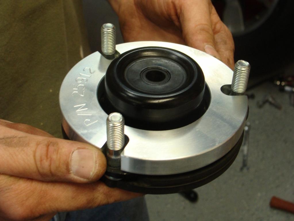

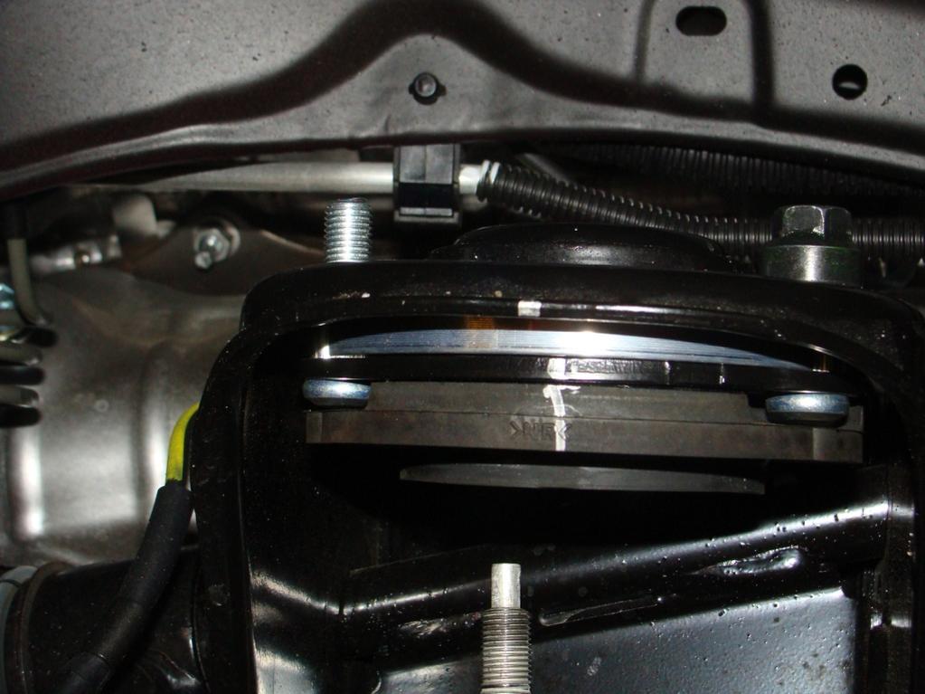

Step nineteen: Press new studs (from Toytec) into holes.
Step twenty: Place metal spacer lift onto assembly.
Step twenty-one: After getting alignment (silver sharpie marks) right, reinsert shock absorber cushion assembly (with spacer) into top of shock absorber housing. Tighten the three nuts to 47 ft-lbs.
Step twenty-two: Work top end of shock absorber back through hole in top of housing and “seat” coils onto rubber shock absorber cushion.
Step twenty-three: Work pry bar again, and apply pressure to allow the bottom of the shock absorber find it’s seating location.

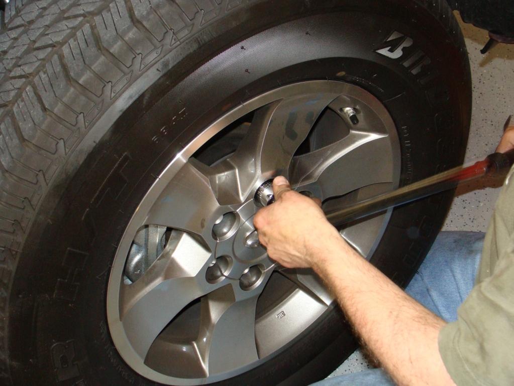

Step twenty-nine: Reattach wheel, but don’t overtighten.
Step thirty: Lower truck and remove jacks and jackstands. Torque six wheel lug nuts to 83 ft-lbs.

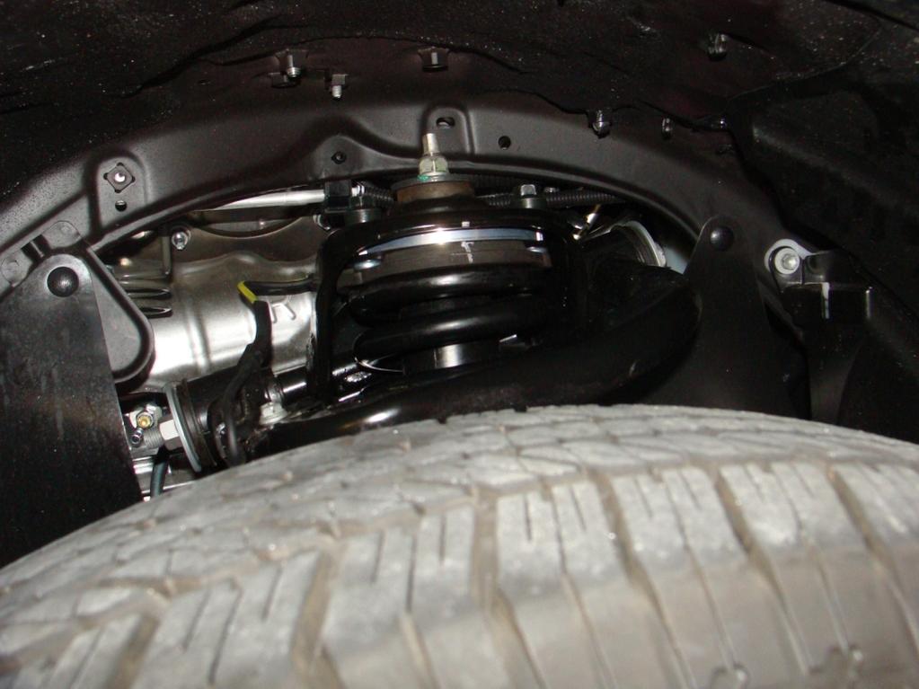

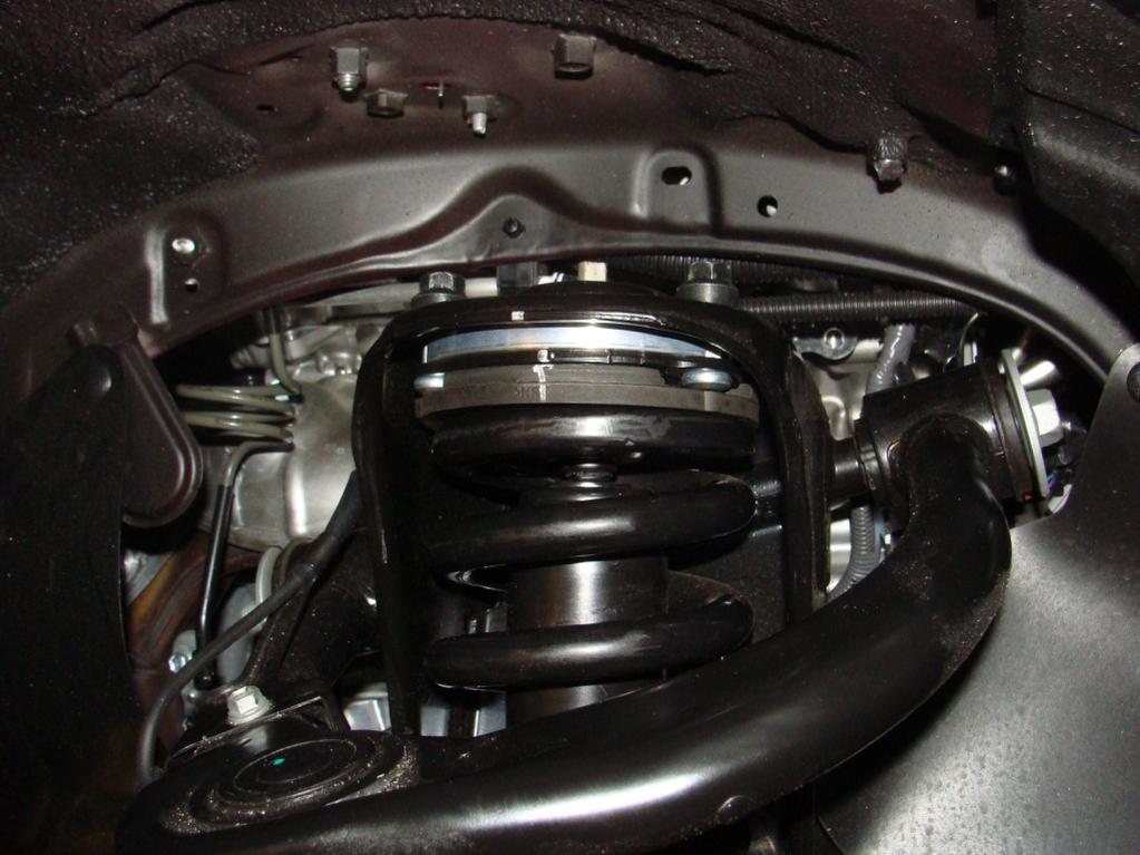

Here’s a picture of the installed spacer.
It started raining on Thursday night, so I haven’t had a chance to take an “after” picture for a before and after comparison. All measurements are from the ground to the bottom of the fender.
Before:
Front Driver Side: 34-3/4 inches ** Front Passenger Side: 35-1/4 inches
Rear Driver Side: 36-1/2 inches ** Rear Passenger Side: 36-1/2 inches
After:
Front Driver Side: 36 inches ** Front Passenger Side: 36 inches

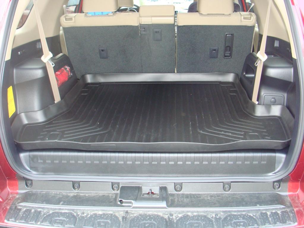

Reason for Doing It: I put some totes in my truck last week, and got some pebbles and dirt on my carpeted floor mat…so I decided that wasn’t cool
Benefit: No stained cloth floor mat; Better protection for underlying carpet; looks good.
Cons: Same as with the floor liners - Losing the “4Runner” logo’ed floor mats; they’re a little pricey, but I believe that they pay for themselves with the long-term cleanliness you’ll get from the switch.
Other Products Considered: NCAA Logo Cargo mat, Weathertech Cargo Liner (my first choice, but not available for models with third row seating)
_____________________________
OK. We’re back to the “low-hanging fruit” type of mods…I replaced the cargo mat!
I want to say that I am very, very happy with my Weathertech DigitalFit Floor Liners that are in the rest of the truck. I went right back to their website to purchase a cargo liner and…they aren’t compatible with my truck because I have 3rd row seating. If they had one that I could use, I would have bought it hands down.
Once I got the Husky product, I feel even more strongly about that opinion.
Don’t get me wrong – the Husky product is much cheaper ($77.95 versus $137.95), and is sufficient for what I need. It lines up nicely with the cargo area, and provides good protection for the carpet. I would have paid the extra $60 because the Weathertech product feels more…substantial.
I mentioned that I noticed a little “mounding” near the edges of the Weathertech product where the liners were bent a bit in the box. Well, the Husky liners are made with a stiffer, thinner, and cheaper plastic material (as opposed to the more rubbery feel of the Weathertechs), and it came rolled up in a box. And when I pulled it out it stayed in the shape of…a rolled up cargo liner. However, the Husky folks knew this would be true, and included very simple instructions for how to address the issue. They said to lay the liner out in the cargo area, and put something with some weight on it (they suggested a book) around the edges for 15-20 minutes on a warm-ish day, and that the liner would find its way back to its original shape. This was a little frustrating, because the liner has a raised edge I had to ply (just a little) into its vertical position. I also elected to put 4 toolboxes around the edge, and I left it for a day rather than 15-20 minutes.
The results were quite impressive, I must say. The liner now fits flat in the cargo area and accounts nicely for the space. I am happy with the purchase, as I feel it’s the best available option for folks with the 3rd row seating option. And since it’s in the cargo area, it doesn’t have to look as nice as the Floor Liners.
