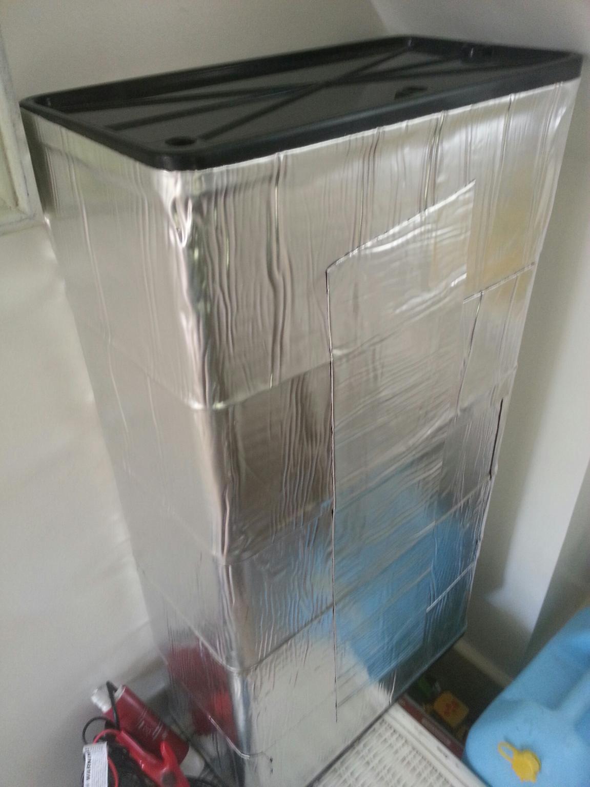

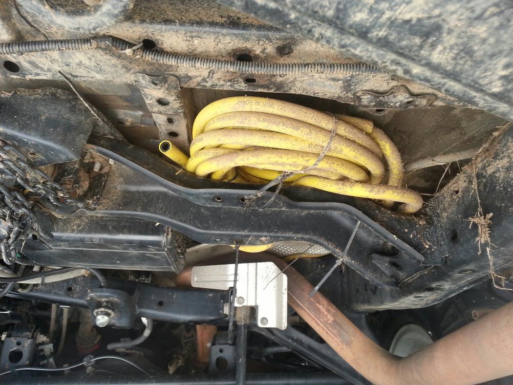

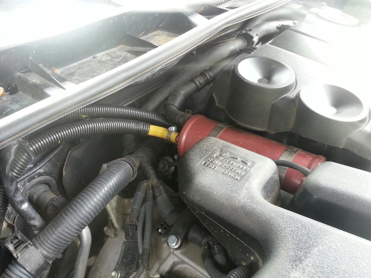

Here is some pictures of the current setup and the way its going. As some of you know my shower on longer trips has been via the heat exchanger with a bucket. So adding a tank means no waiting for hot water or need to find water.
A great deal of help has come from "TheJosh" build.
1E... I like the possibility of a bladder, a lot!
