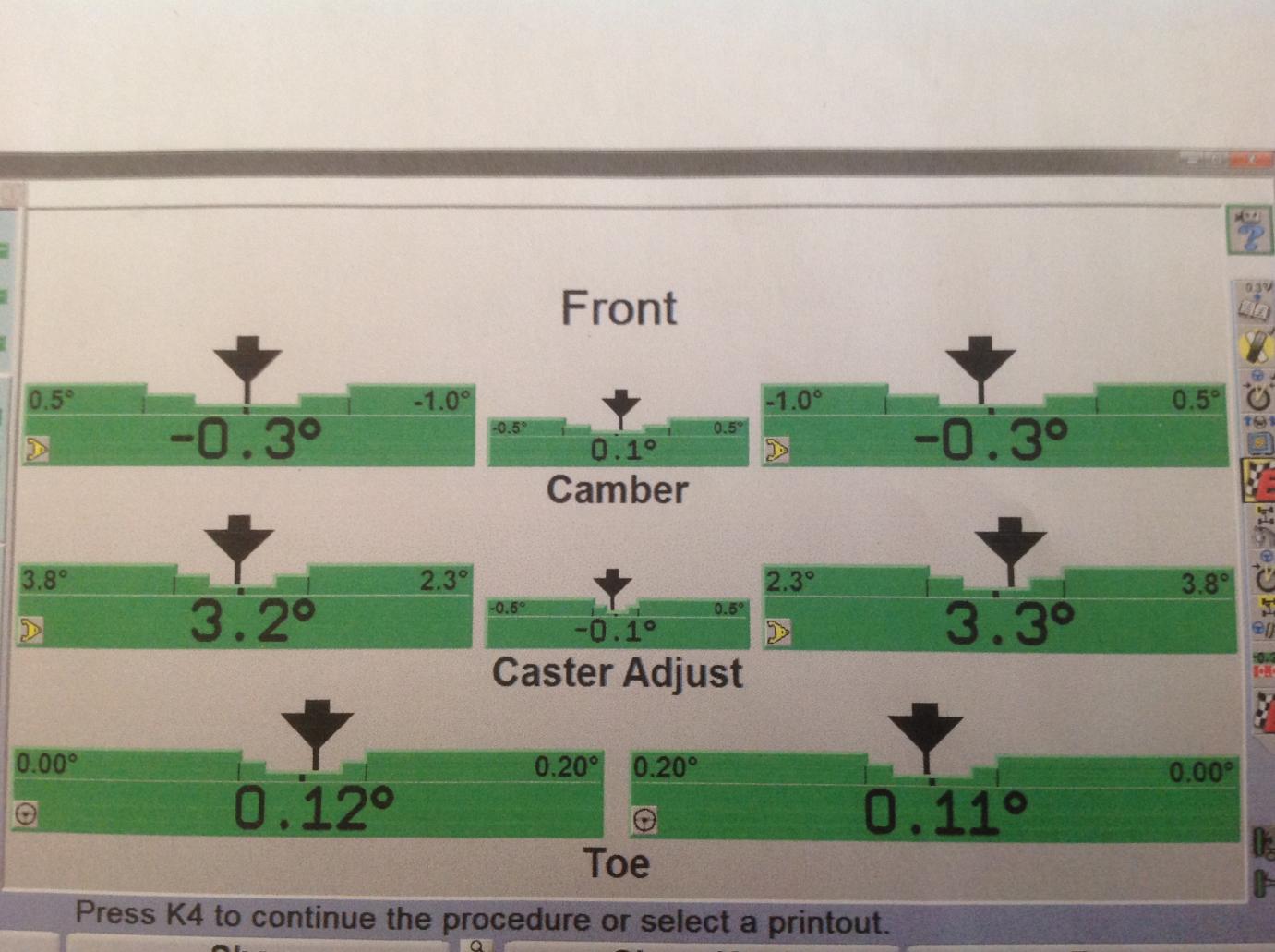

After reading all 14 pages, I first of all set my LCA cams as recommended, pushing the wheel as far forward as possible. THEN:
1. Sent it to G on the star plate for the most possible firewall clearance *running 315's*
2. Maxed SPC camber adj all the way in (toward motor for negative as possible)
3. Torqued that nut to 150lbs and and off to the alignment shop.
Castor was acceptable at 2.3 Passenger and 2.0 Driver, toe was perfect, but my wheels still sat like this: \ / I could not achieve the camber I needed.
After chatting with Tom in tech at SPC (who is amazing and drives a 3rd gen), he crunched some numbers for me. backing off to "F" would give me a full 1* neg camber back on EACH wheel and would only cost me 1/10 of an inch of clearance in the back. Not to mention would get Castor numbers up as well.
I did that, took it back in to get the toe re-adjusted, and my numbers are bad ass.

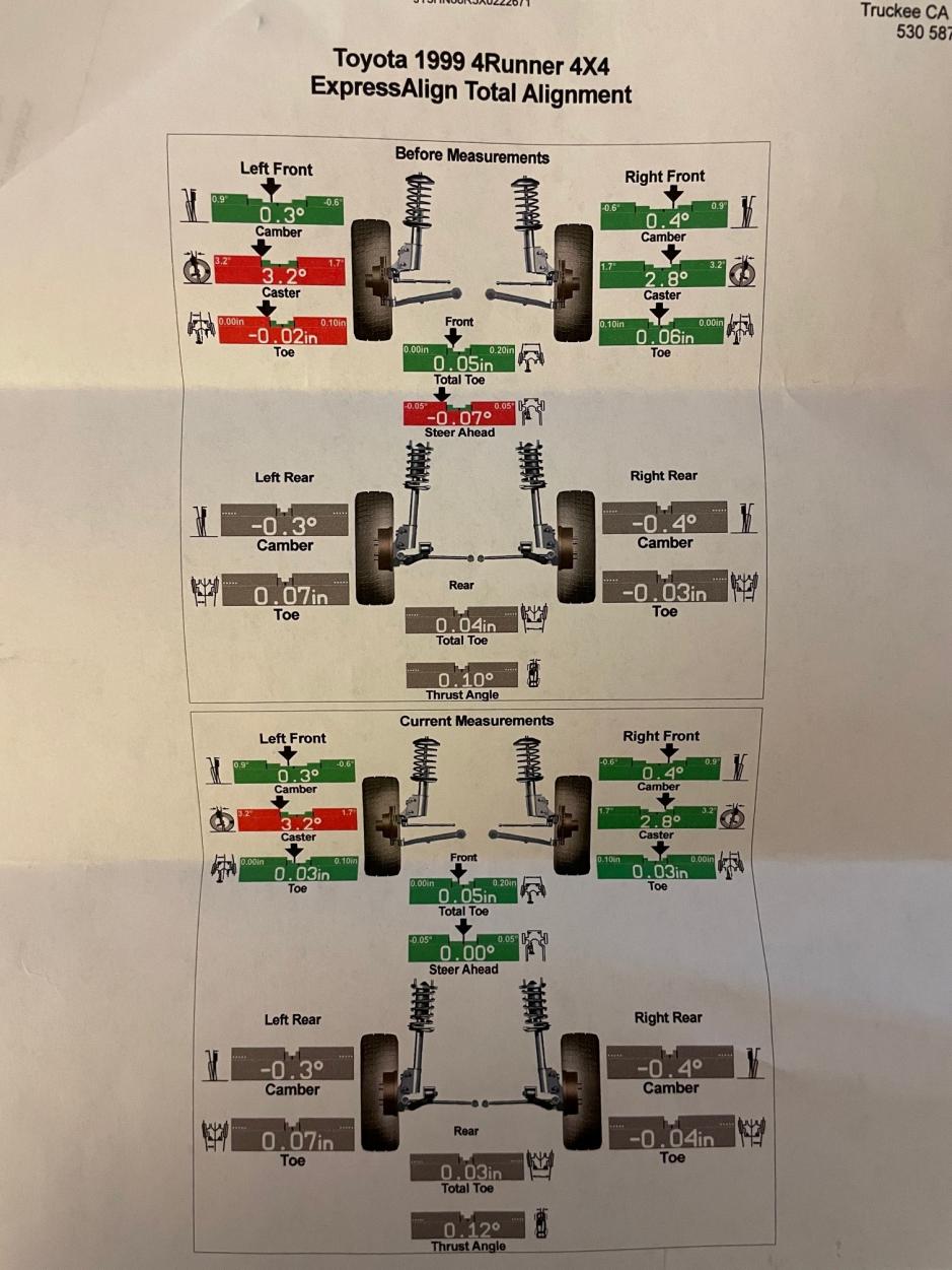

I have to be honest - I have no idea how to interpret this. The 4Runner seems to drive & track well - maybe it has a bit of understeer.
Thoughts on these numbers?

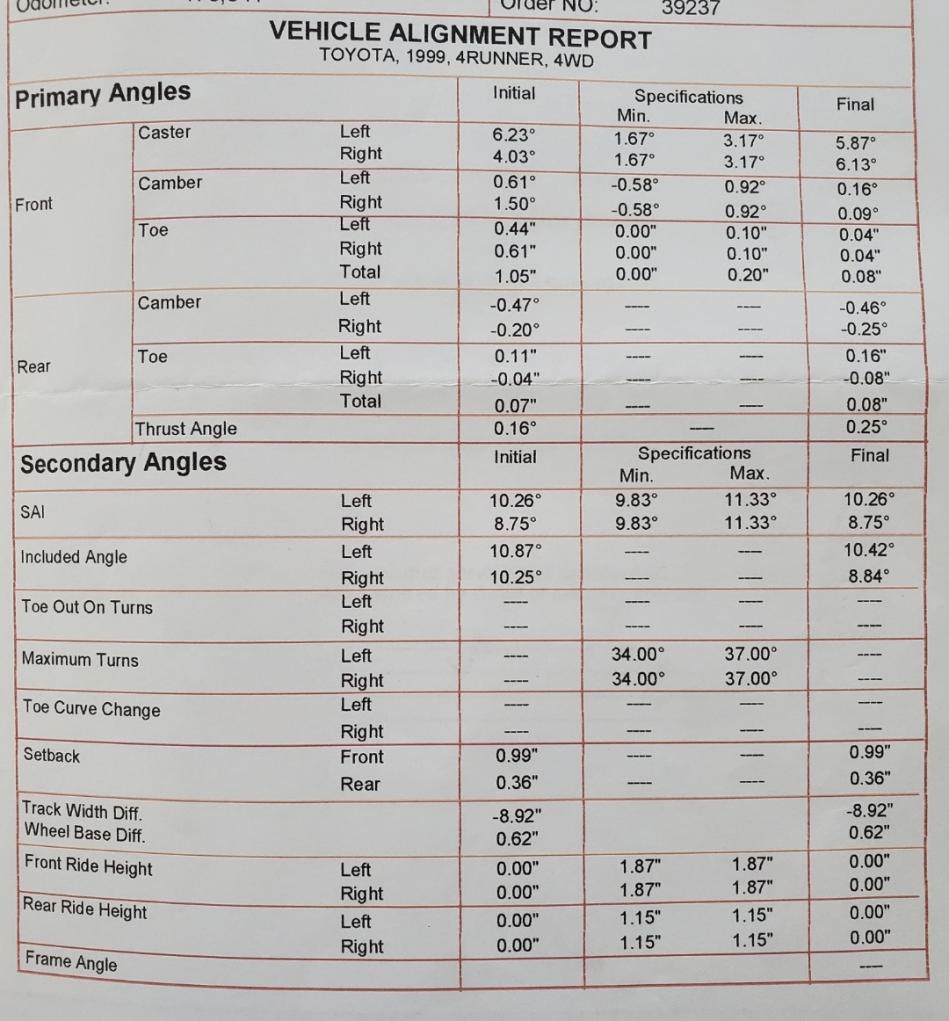

I have to be honest - I have no idea how to interpret this. The 4Runner seems to drive & track well - maybe it has a bit of oversteer.
The numbers in the "min/max specification" column is the range your caster, camber & toe should fall within. Looks like your camber & toe numbers are within that range but the left camber is slightly higher than the max range. Your caster numbers are noticeably higher than the max range. If it drives well and there's no rubbing I'd be good with that.

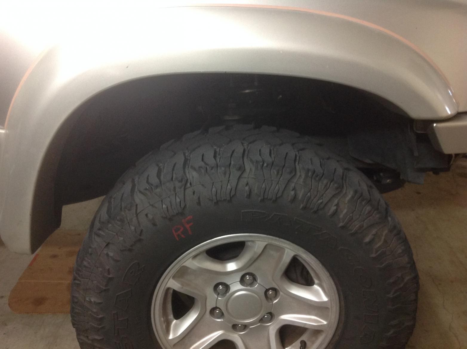

Toyota LCA bushings this week SPC D position 285-75/16 5 stars 1.25" spacer 2.75" lift.
Alignment yesterday in n out got me this for $193.00 I like in n out.
70-80 mph feels good city driving good return to center bit slow acceptable.
Get it off-road see how it goes soon.
3" clearance wheels straight. Yea I know time for VC gaskets n half moons :)
