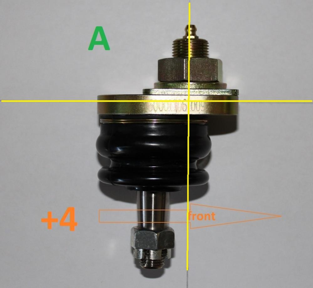

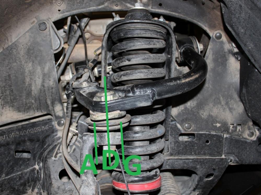

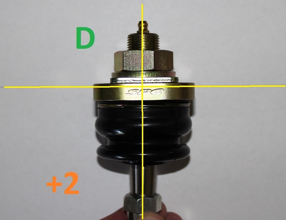

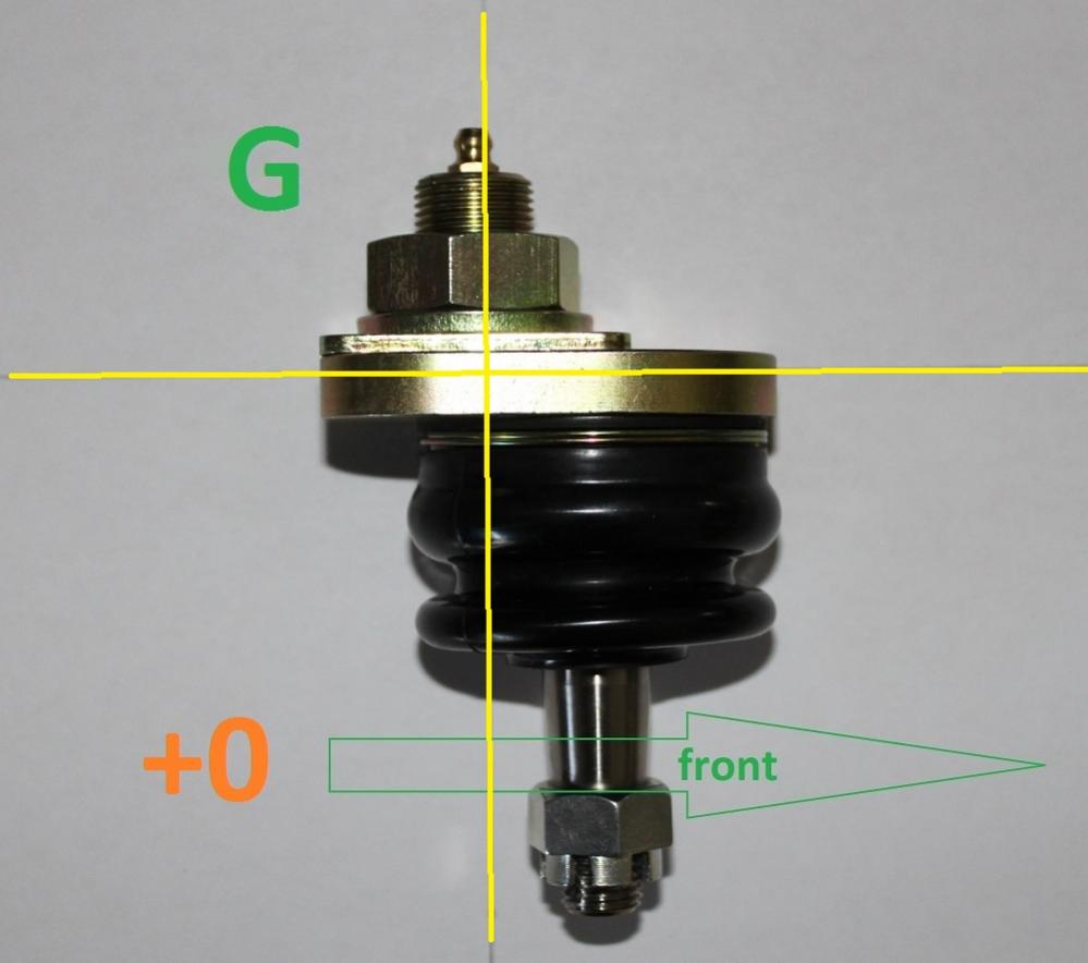

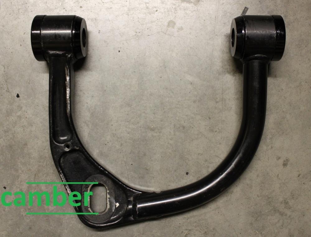

I was getting my head around the relation of more positive caster and the body mount. Thought i would drop them here in case it helps someone.
Orange numbers are the caster.
Green letters are the SPC setting.
/cheers
