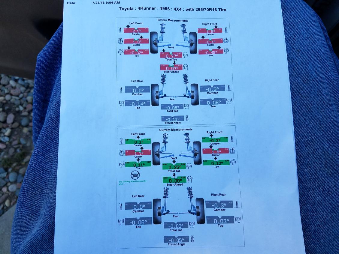

[MENTION=116877]fourfive[/MENTION] thanks for the help. I've been fighting alignment shops almost two years since my spc install. On stock control arms I had about 1.5* caster and zero rubbing. I've had rubbing issues on the spcs on settings A-E. Two offroad alignment shops recommended A and got me 4-5* caster and still slight rub on the street.
Just finished with alignment on the G setting. Pretty much puts the spc arms in stock uca location. They had to max the lca's to get me 1.5* caster. Pushed tire way out. So much room at the pinch weld now. I could easily run some 35's with the clearance now.
Again thanks so much!!
Thats awesome man. Glad to hear the G setting worked out for you too. I've wanted to mention my experimenting on the the different caster settings and having the best outcome on G for a while but kept putting it off because I didn't think it would go over too well with others since I have not heard or read of anyone else on G. Also the rationale for being on G can be a bit confusing initially & didn't want it to appear that I was giving bad information especially since i realize that my experience may not generalize to everyone else with SPCs. Your alignment numbers look almost identical to mine.
