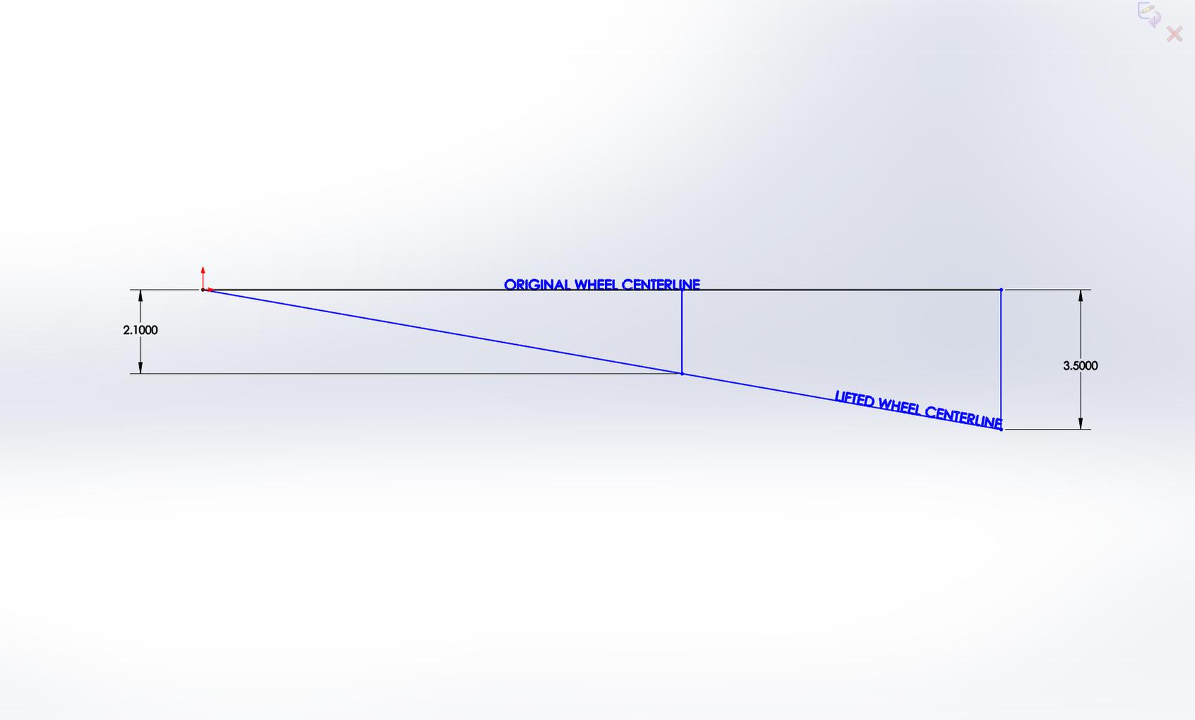

Triangles
jwkilgore is on the right path. I felt that an image would help explain further.
The pivot point for your lower control arm is fixed on the frame. The top spring seat is also a fixed position. If the distance between the spring seat and the lower control arm connection with the bottom of the shock increases the result that the wheel will move down in relation to the frame. This results in the truck being lifted higher. Since the shock/spring assembly is between the pivot point and the wheel, the wheel will change height in relation to the frame by more that the height change made by the shock/spring "lift". Again, I hope the image helps more than what I wrote.

Icon said they were preset at 2.1 and perhaps they misspoke or I misunderstood. In either case I misrepresented my lift by casually stating 3". It's not as Demello told me it's a somewhere between 2.1" and 2.25" That tire information is helpful as well. - Thanks!
Exactly, this is a simple illustration of the principle that jwkilgore and others have stated and a visual version of what I was stating above. Here's my quick NOT TO SCALE sketch:
