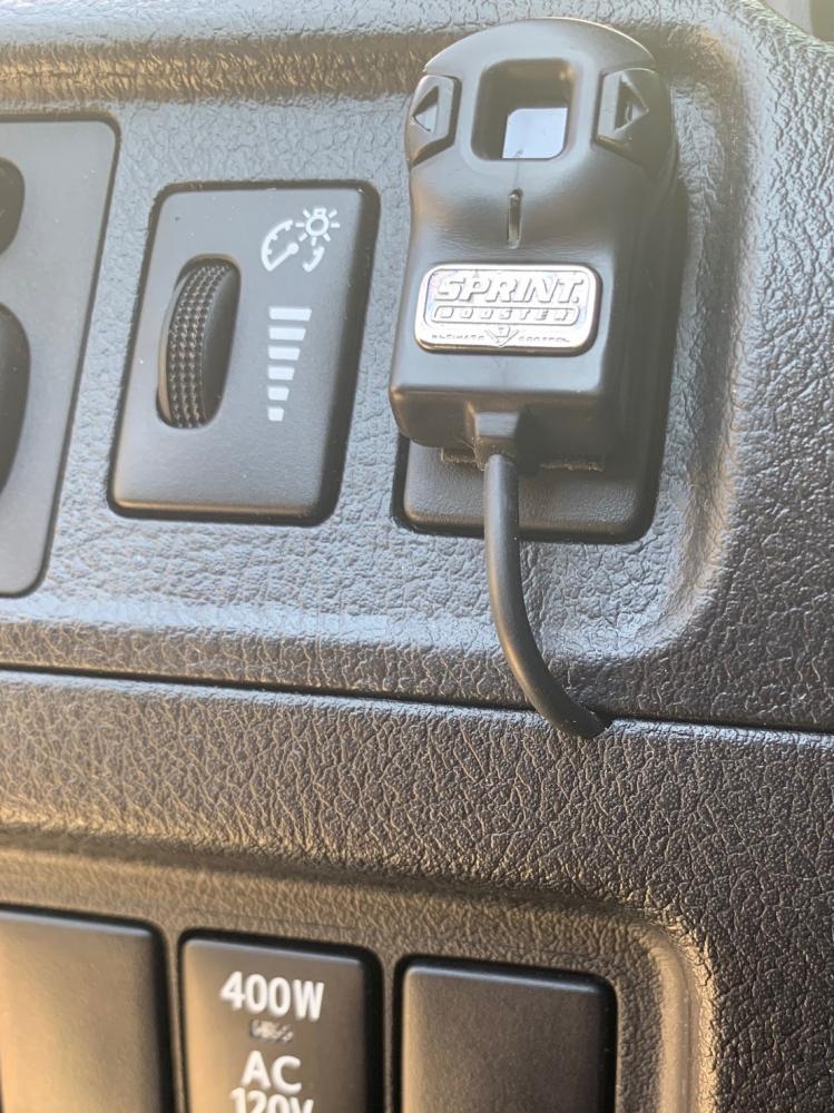

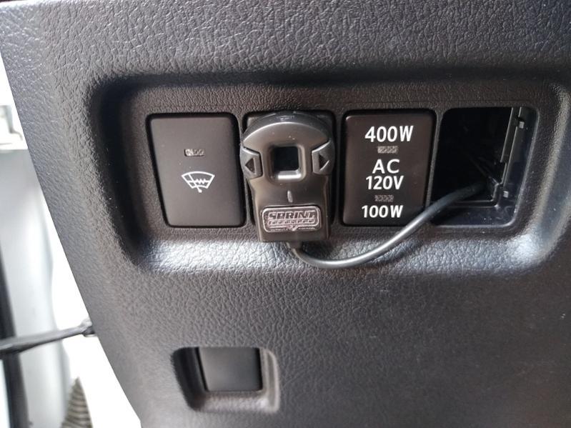

So I wanted to put this in one of the empty switch boxes. The wire however for the Sprint booster is at the bottom so you either have to remove the blank all together and then the Sprint Booster is too small to be able to stick to the sides or you have to drill a pretty big hole near the bottom of the blank switch to get the connector and wire to fit through it which probably won't work. So this is what I did. Any other suggestions?

I drilled a rather small hole in a switch blank, took the two wires out of the white connector, slid the cable through the hole, then re-installed the wires into the connector. You have to be careful doing this and make the sure wires are in the correct order. The hole is a little bit above the bottom so it’s hidden when the SB is installed over it. The location of the hole was kind of dependent on the ribbing structures on the backside of the blank, where I could fit a drill bit easily. With a severe bend to the wire under the velcro attached SB body it’s barely noticeable and it’s securely attached.

Thanks. Did you have some sort of tool to get the wires back in? Looked very small to try and pull the wires out and then try and put them back in and crimp it down.
You don’t take out the wires themselves, but the pin which is crimped to each wire. There’s a tiny retainer tab on one side of the connector. One for each pinned wire. I took a tiny flat blade jewelers screwdriver and carefully bent it up a little while lightly pulling on the wire. It comes out of the connector with the crimped pin. Notice the orientation of the pin so you can reinstall it in the proper direction. When you do it will seat itself with a click. Be very gentle.
If it’s a different style pin and connector than the one I have you may have to push down on the metal tab retainer of the pin itself to remove the pin and wire from the connector. Then reform the retainer tab a little before reinstalling back into the connector.
If you’d like, post a clear closeup photo if you can of that connector and we can verify what to do. But once you remove the connector from the SB it will probably make sense. Good luck. Let us know the results.

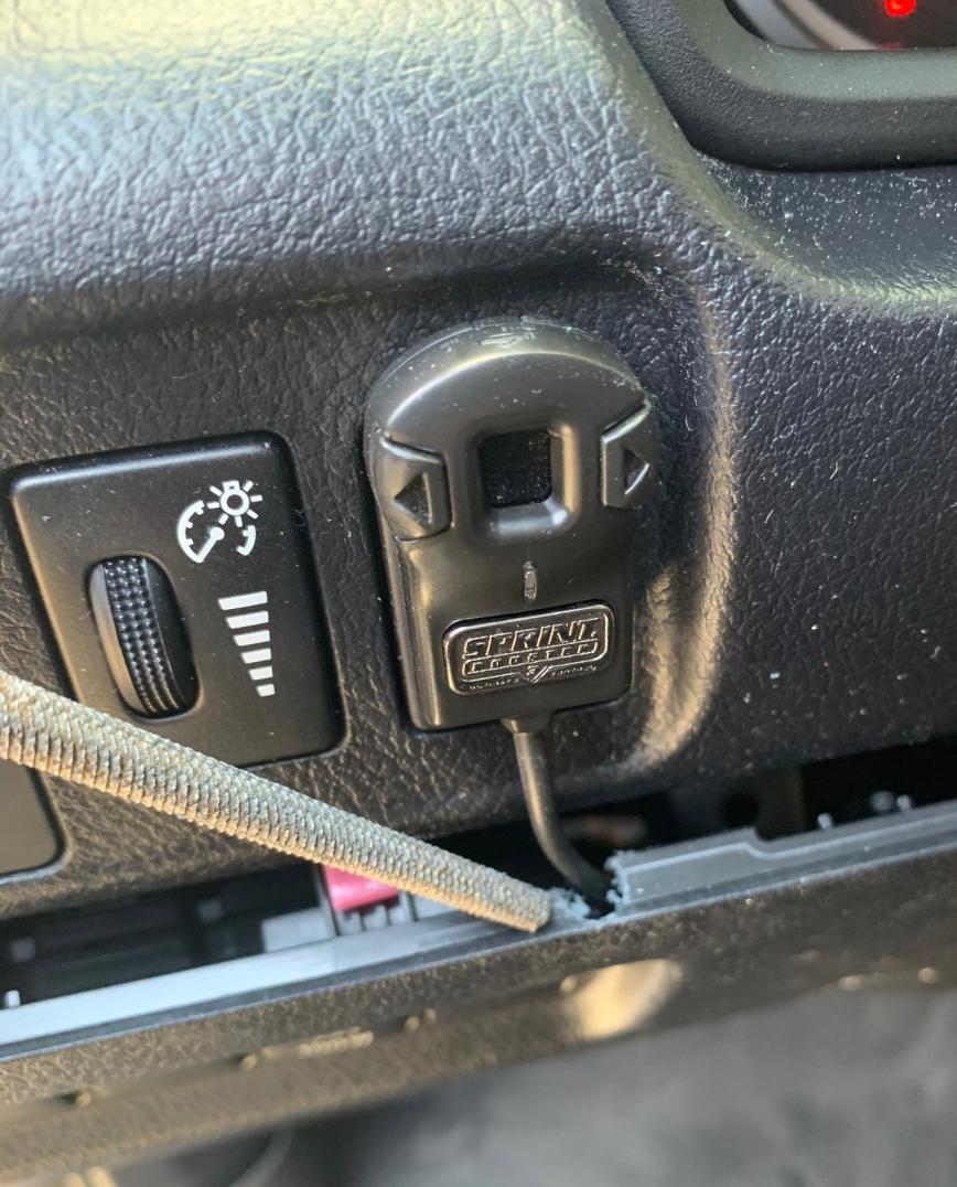

I had the same dilemma so I went up higher with it on the upper row and then used a small file to make space for the wire to run through the panel seam below as I didn't want to bend it at almost a 90. I'm sure it would be fine as most do that but this option seems good enough for me I'm never going to remove it from that location.

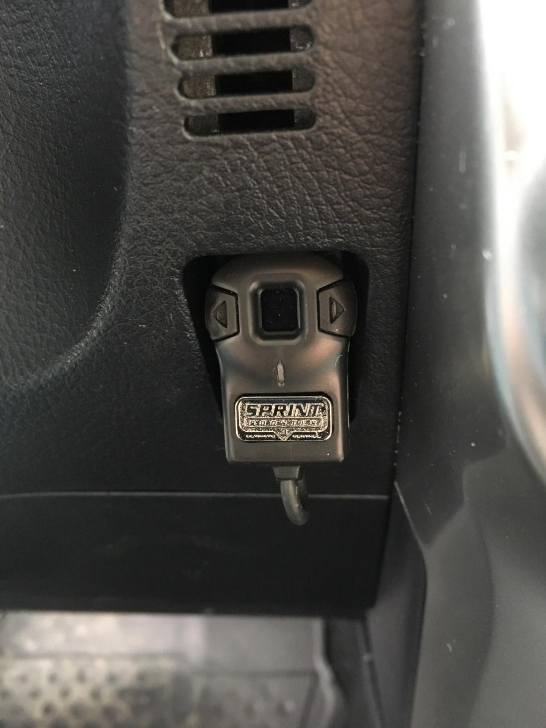

I just put mine in this morning. It took me an hour to make a mounting point for it because I am CDO like that. The actual Sprint Booster took 11 minutes, 10 of which were waiting for the CAN system to do it's thing. I just did a quick drive on Sport 5 and it is a remarkable change. Worth every penny!
