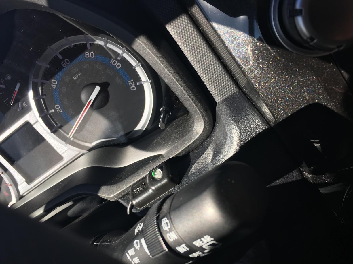

Got mine and installed it. Ran it up through the steering wheel...
love mine.
