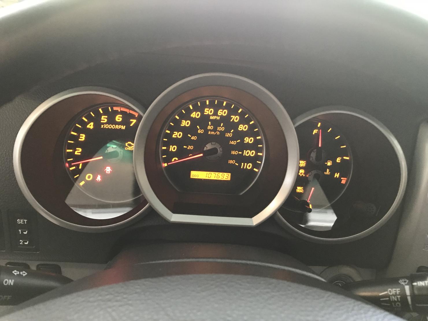

Honestly not worried about it, but is it normal for the check engine and VSC Off lights to come on after installing the URD Y Pipe?
All O2 sensors are back in the correct spots but the Offroad Y-Pipe does eliminate the 3rd cat which likely throws a code.
Just curious.

URD web site says 'no light'...
"The URD off road Y Pipe does include ports for the rear O2 sensors. It will not cause a check engine light from eliminating the rear catalytic converters. We also include and extra O2 bung for easy installation of an aftermarket wideband display sensor."
Did you disconnect the battery after install?
May have to call Gadget.

I pulled the EFI 20 fuse, but will see if disconnecting the battery works tonight.

Battery reset didn’t affect anything. I’m fine with VSC off. But still weird it’s throwing a code.

You'll have to pull the code before we know what's causing it. VSC off is pretty common when the check engine light comes on.
Code:
"P0031 - Heated Oxygen Sensor Heater Control Circuit Low Bank 1 Sensor 1" and P0031 came up 3 other times too.
Also had "C1223 - Malfunction in Antilock Brake System Control System", and "C1201 - Engine Control System Malfunction" which I assume are all due to the O2 Sensor code causing VSC to go off.
I also pinged Gadget as it isn't supposed to throw a code.
It's nice to have VSC off. Although I'd rather put a switch in to turn it off on demand.
