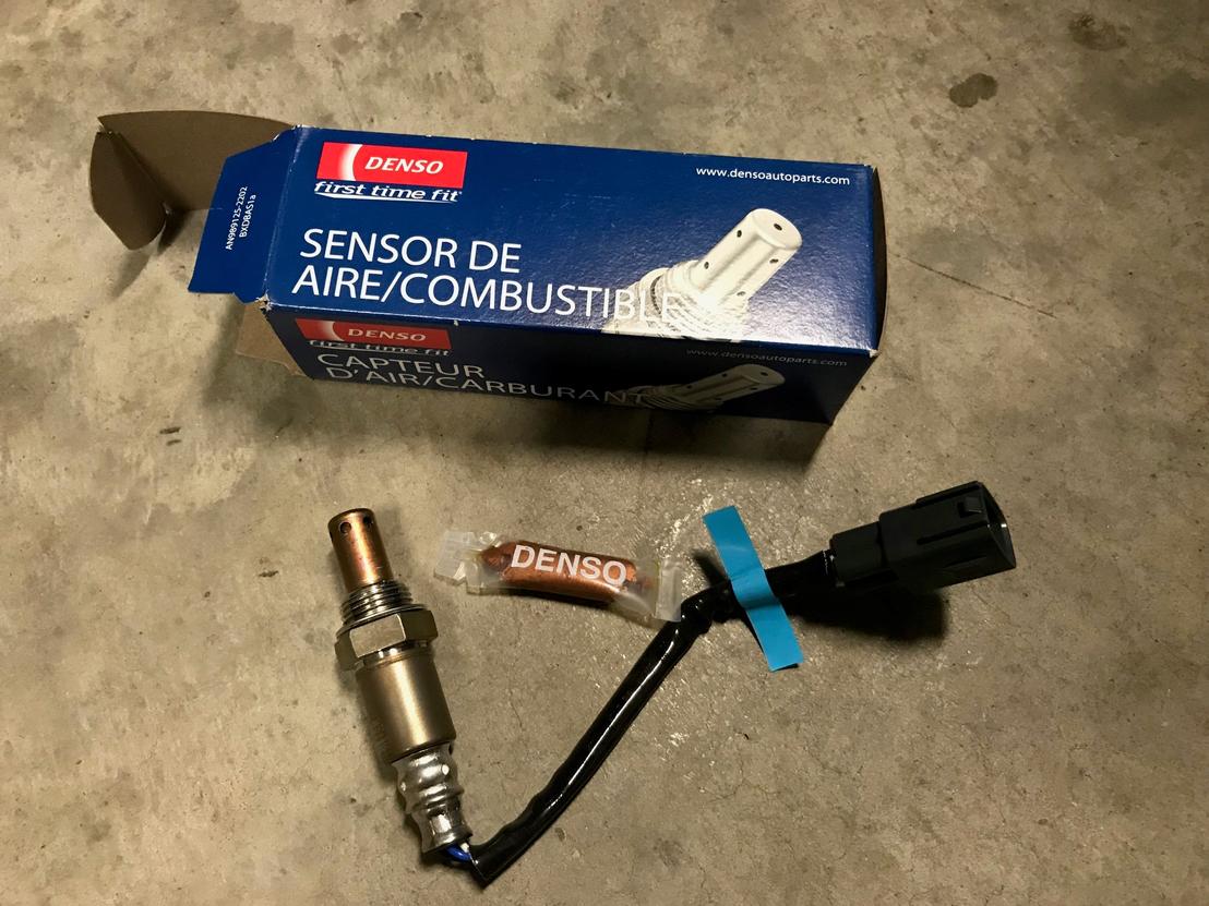

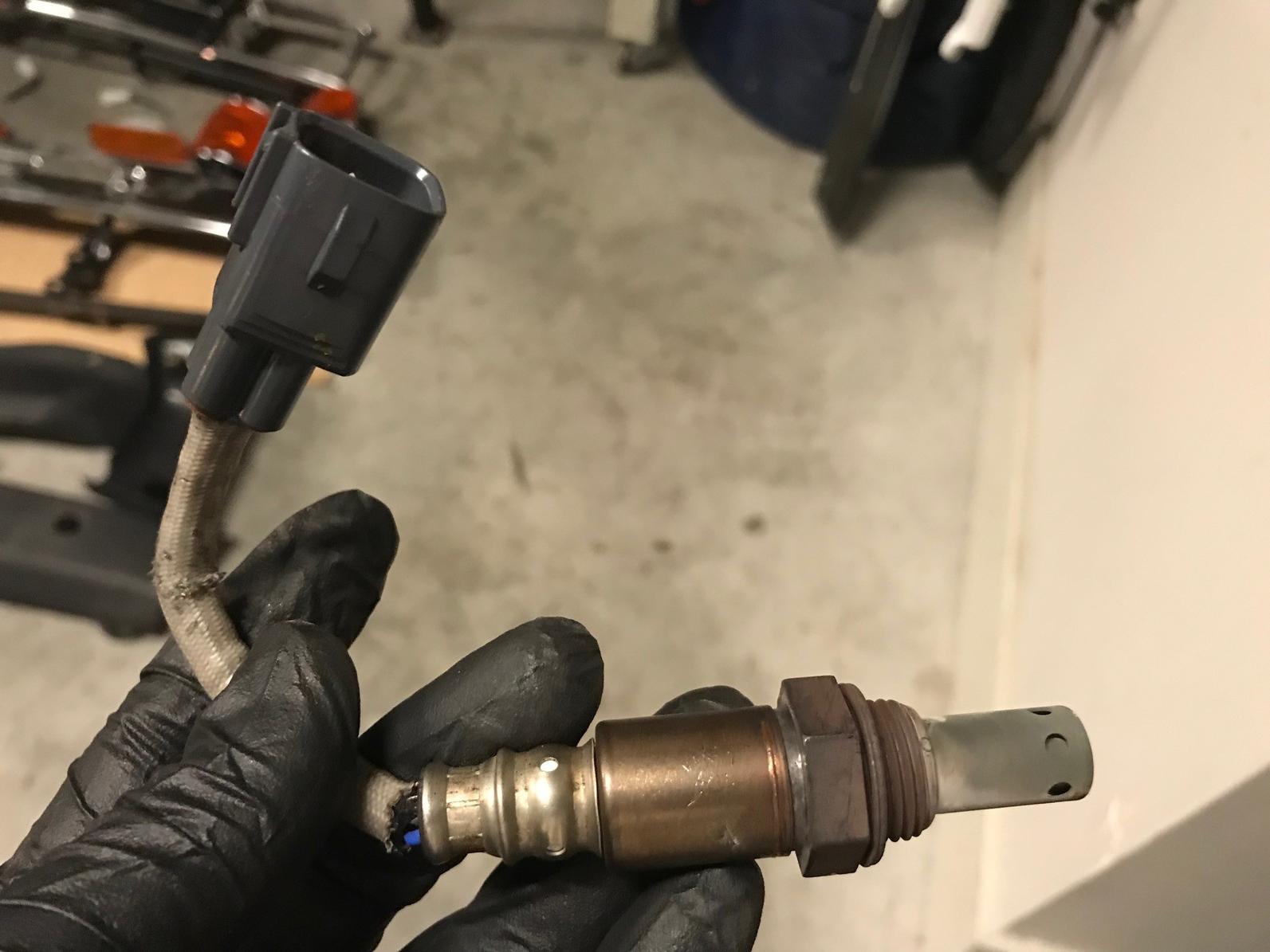

Code:
"P0031 - Heated Oxygen Sensor Heater Control Circuit Low Bank 1 Sensor 1" and P0031 came up 3 other times too.
Also had "C1223 - Malfunction in Antilock Brake System Control System", and "C1201 - Engine Control System Malfunction" which I assume are all due to the O2 Sensor code causing VSC to go off.
I also pinged Gadget as it isn't supposed to throw a code.
It's nice to have VSC off. Although I'd rather put a switch in to turn it off on demand.
Check all your abs wiring from the engine bay to the front wheels. The ABS malfunction makes me think you knocked a wire out of a harness since that and the VSC, and the engine control system are all on.
I'll double check the wiring, but I spoke with Gadget and he said it sounds like we might have damaged the heater element in the bank 1 FRONT sensor. He said if I used an Impact on the Y-Pipe, which I did, I likely damaged the sensor (supposedly they are very brittle) with rattling of the pipe.
Anyone know the Denso part number on this sensor?
I found this on the forum:
http://www.toyota-4runner.org/4th-gen-t4rs/103523-p0031-04-4runner-v8-part.html
"OK. Just wanted to update in case anyone has similar problem. On V8's, the sensors are marked as following: Sensor 1 is pre-cat. Bank 1 is driver's side. Bank 2 his passenger side. I think this is reversed for V6's.
The 2 front (pre-cat) sensors are the same on the V8's. The Toyota part # is 8946560150. I bought mine OEM from Conicelli (Conicelli Partznet | Used dealership in ,) for $121 including shipping. Easiest way to get to it is through wheel well. There is a rubber flap with a bunch of snaps. Unsnap the snaps and flap will rotate out of the way. The little baby is tucked inside there. Hope this helps."

Yes. Those are correct. That is what I ordered and they have worked great. I tried to cheap out and get ones off ebay and they were garbage imitations. Personally I would buy two and keep the one old one that is good for a spare. That's what did.

2) I knocked out a few small projects, including swapping in a new O2 sensor damaged when we did the Y-Pipe cat delete (this 4.7L V8 is really squeezed in there). The new sensor eliminted the CEL I was getting. I'm still waiting on the URD MAF Calibrator to arrive and will install my AEM gauges before we do final tuning.
