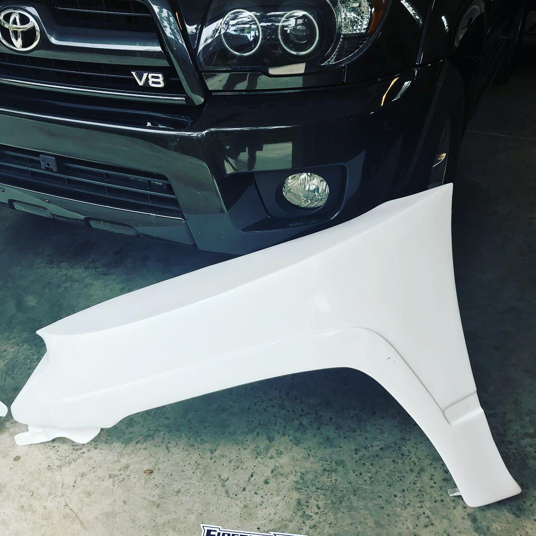

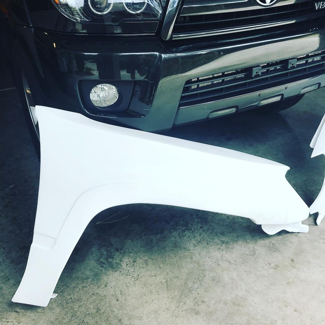

More parts arrived today! These Fiberwerx front Fiberglass 4.5” Bulge fenders will really help us for the 35s while keeping COG low. I plan on installing them when the salvage doors are ready (should be here next Wed).

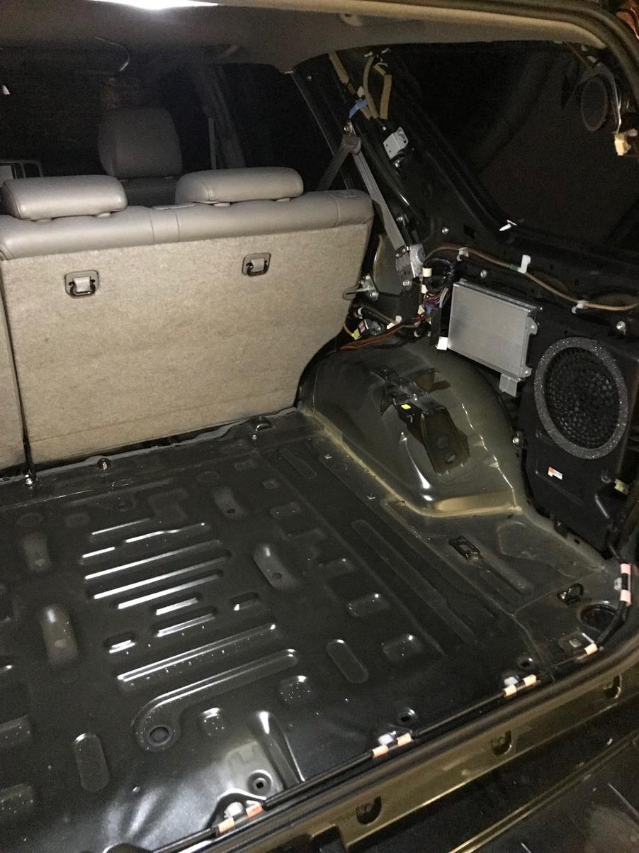

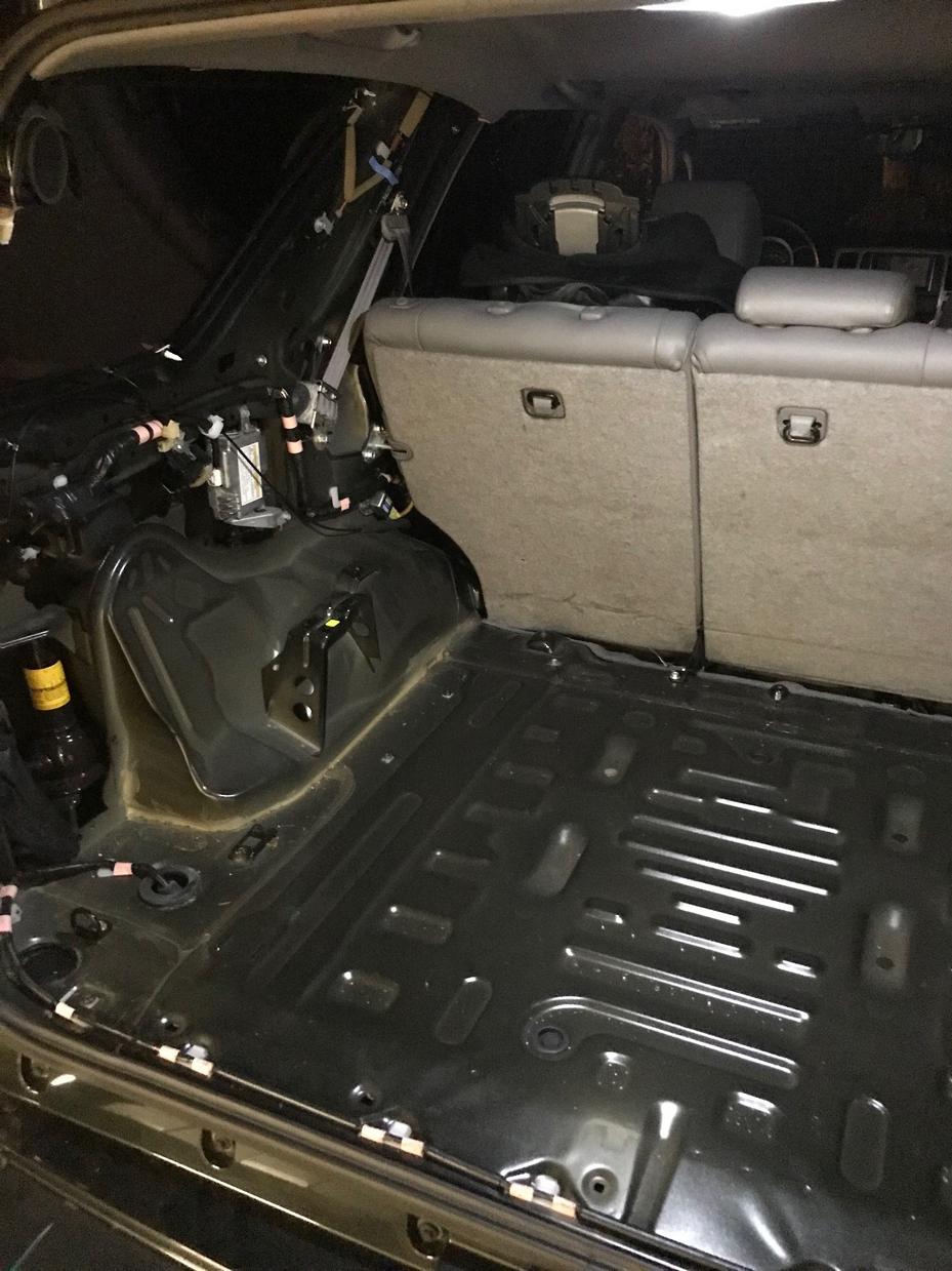

Took measurements of the cargo area stripped down for the fuel cell and spare tire last night. I'm thinking fuel cell on the platform just behind the rear seats today (removed for KOH) and spare standing straight up or slanted 45 deg toward the front over the rear portion of the cell.
The fuel cell area behind the seats is 42 W x 26 D.
The spare tire area behind the cell before the liftgate is 58 W x 14 D
Max vertical height 39" in center, min right at Liftgate 35.5" - will likely gain another 1" with full teardown.
We'll be using Alltech baffles - no foam. Researching fuel cells later today.

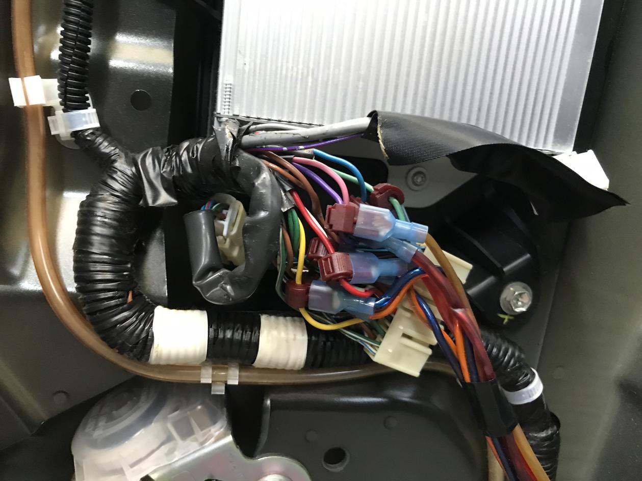

Just Curious - why would the Pioneer head unit be wired into the harness in the back near the factory JBL sub?
Saw it while tearing out the cargo area and had to ask.
I’m going to try and keep the head unit as I can turn camera view on full time, which may come in handy for a camera on the front bumper when we’re strapped in and can’t see over the hood.
