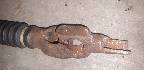

I replaced the intermitant steering shaft on my 4runner last fall.
Old one was seized on pretty good. Tried an air hammer to try & get it off the lower spline but no dice.
Ended up using a dremel with a cut off wheel to cut away small peices of it at a time till it broke loose with a few whacks with a hammer.

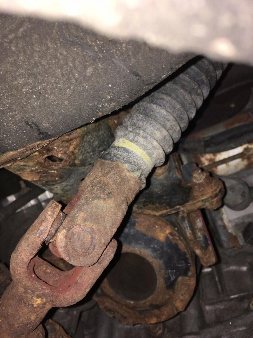

here is as pic of the shaft joint. hit it and the bolts with blaster. let it soak in. the yoke looks good. i keep hearing about three bolts. two for the upper connection, one for the yoke?
looks like a difficult access zone, even with the shields dropped.

There are 3 bolts that need to come off, one at the bottom and 2 in the upper yoke. You will probably want to buy new bolts and the upper yoke. I snapped off 2 of the bolts & rounded off the third trying to remove them and had to cut the upper yoke off since it was seized on same as the other end of the shaft.
I cut the upper yoke off by cutting it in half lengthwise using a dremel with a cutoff wheel and it was easy to do through the wheel well.

Here's what my old one looks like after I cut it out. Yours doesn't look too far behind.
