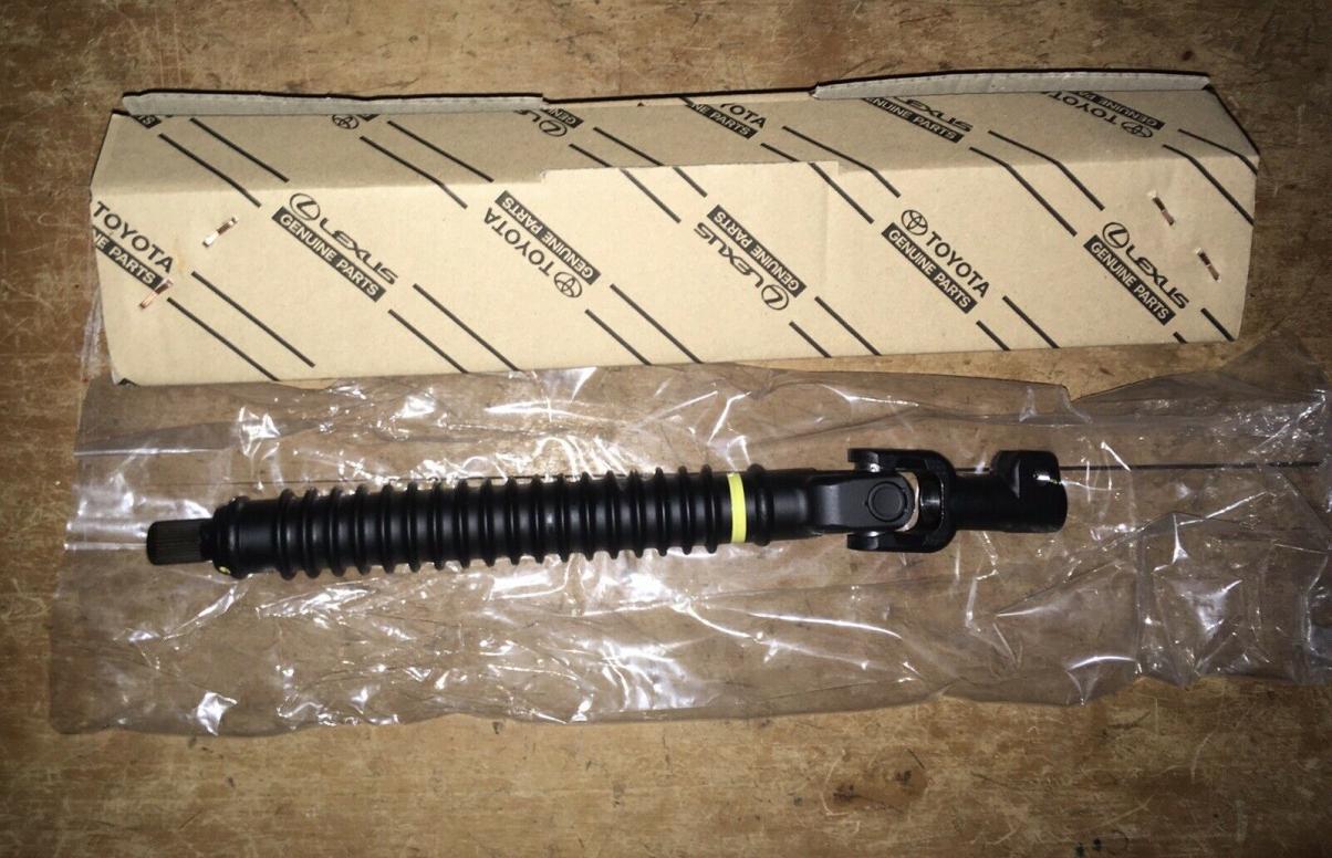

Wow! Bought the shaft from an online source (after the dealer tried to give me the shaft!). $137 shipped w/tax! bought on the 18th, arrived on the 20th!! best discounted dealer price i could find was $195, so big savings over even that good price. here is a good pic:
i honestly don't know why a shop can't do this replacement in a comfortable hour. three bolts and knock it out and in. i'm gonna carry the part around and go into couple of good shops and offer $100 flat labor for the job.

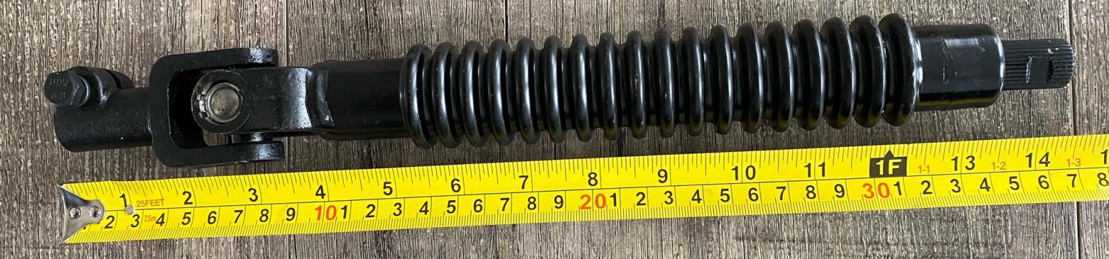

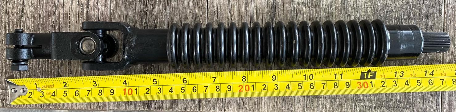

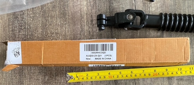

Hey guys I ordered the Steering U-joint column from Amazon for $60 and just received it. I usually buy OEM parts from Toyota but in this case the dealership here in Canada wanted $542CAD for the part. I can’t afford that right now, parts are ridiculously expensive here. Anyways after unboxing the part from Amazon I was amazed how small it was. For some reason I imagined it would be longer. Currently I don’t have time to do the repair to compare with the OEM part on my truck. It measures approximately 14.5” long (see photos). Does this seem right to you guys? I’m just double checking because I won’t try this repair for at least another couple weeks and I don’t want to miss the return window if this part is incorrect.
Thanks in advance.
Looks right to me. Air hammers are a big help to get these things off. I think I may have dremeled parts off the old one too. Not a fun job.
