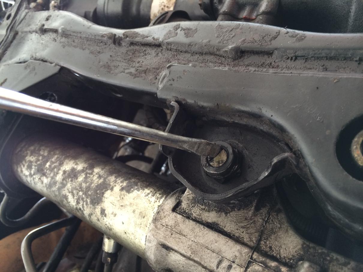

Best tip/trick I can give for this is to take your grinder and cut a slash in the center 19mm bolt. Save your knuckles from having to get 1/32 turns on a box end wrench from the top and turn it into a big flat-head screw.

geohil, that's ingenious. Never thought of that. But I knew Nelson would echo the same sentiment I have. If I tried that with any of my Runners, I'd be without a few screwdrivers or bits. There's a fair amount of torque on that bolt+years and any rust makes it redonculous. Thankfully, wife's '01 (which we had to put a new rack on) was born in TX and is quite clean underneath and my Canuck '98 came with a shiny new rack underneath. Cool idea, though -
