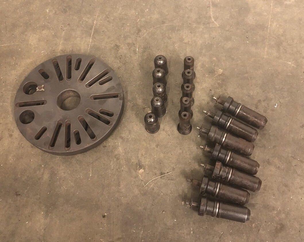

This info from research, not saying it will work for you.
The front ends on the 4Runner and Tacoma are super sensitive. If you have something just slightly out of whack you will definitely know it on these trucks. If you have a vibration and believe it to be cause be the wheels and/or tires, then you should not waste your time by going to a shop with old technology. If your time is as valuable as mine then you should find a shop with the needed Haweka adapter, a GSP-9700, and a technician that has a clue.
The easiest way to find what you need is to get a list of shops near you that has one. Next call the shops and make sure that they have the Haweka adaptor for your wheels. If they tell you that they do not have it or don’t need it, then hang up and call the next shop. Do not waste your time with them. If they are willing to spend $10,000 on the state of the art road force balancer, and not get a set of Haweka adapters to go with it then they probably are not smart enough to work the machine anyway. An experienced tech may index each wheel/tire.
When you find a shop that has both items make an appointment and have them do a road force variation work up and see if you need to replace your wheels or tires and then get a good old-fashioned balance. The combination of the GSP-9700 and the Haweka adaptor should cure the most common cause of vibration in the 4Runners and Tacomas. This combination will give you the greatest chance of getting you vibration problem fixed on the first visit as possible.
Every new 4Runner I have purchased, immediate trip to tire store, new Michelin LTX/MS. This tire has been updated by Michelin thru the years, new designation, Defenders. Not saying this is the best, just IMO.
Are our wheel actually hub centric??? Last I checked it was impossible to Center the wheel on the hub without the lugnuts. If it where hub centric it should just center when you put the wheel on... Can so actually proof they are hubcentric like... Paperwork or something. Because I'm 90% sure they are lug centric.
