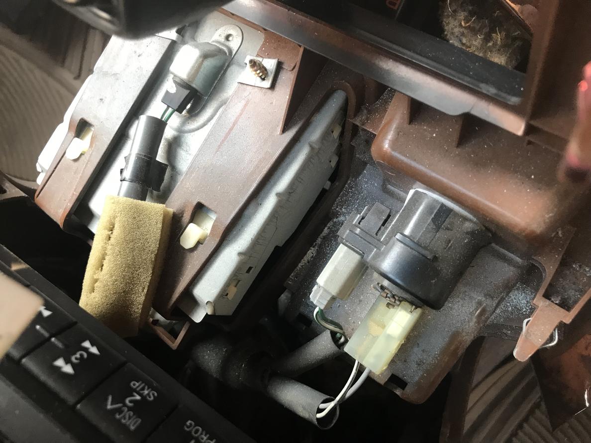

Do I unplug these somehow?
-the cable to the left may be twist off(ash tray).
-the middle cable(cigarette lighter) is removed by pressing on the clip.
-the cable on the right(cigarette lighter) may have a clip to the right or on the bottom if not i think it simply slides off.
TBH i dont think you need to remove the wiring from the center bezel though i think you can simply put the bezel to the side. There should be more than enough slack on the cables to do so.

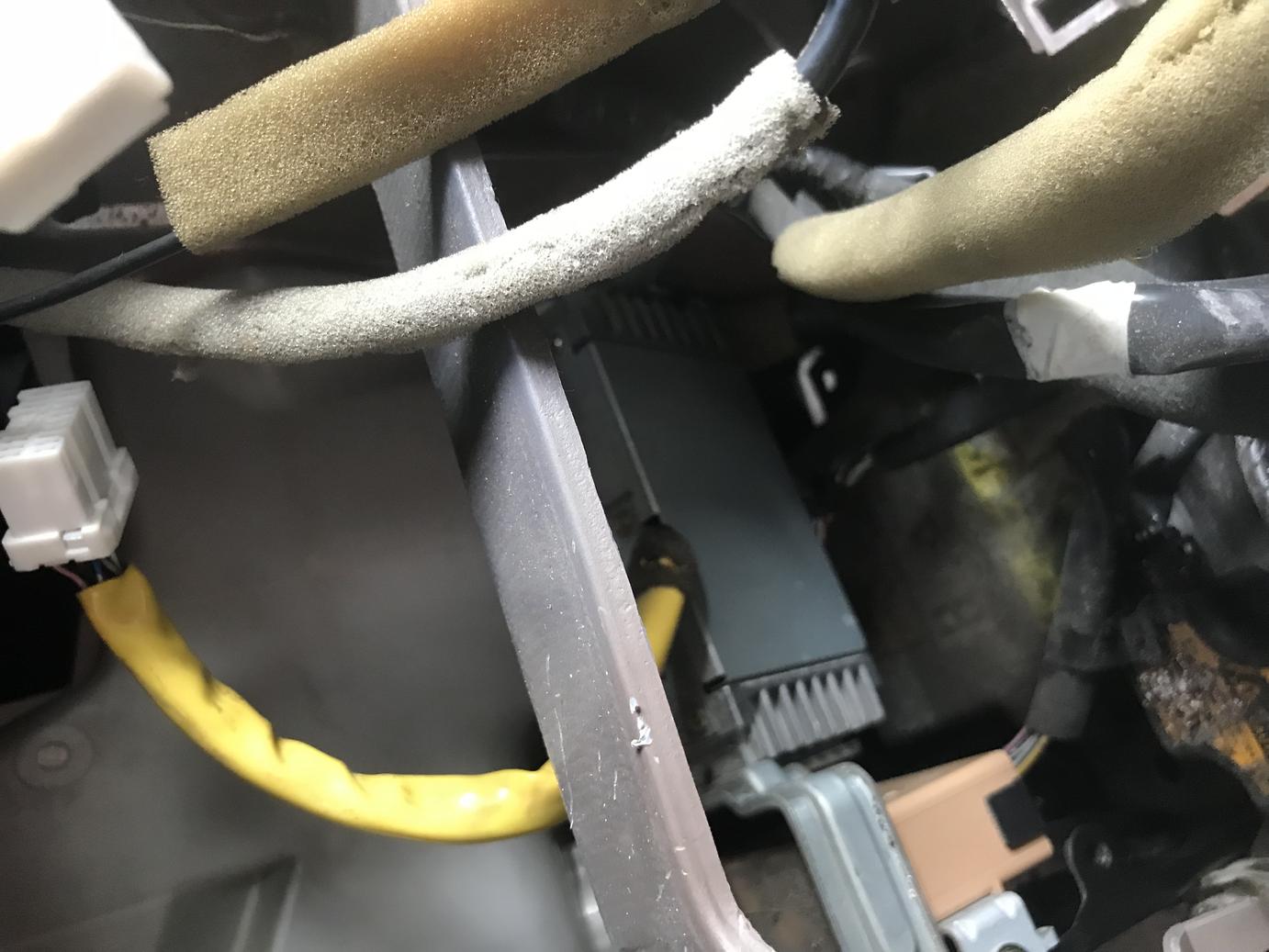

Now I’m here do I take this completely out? It’s the amp right?
Then this plug to the brown box goes into the new harness along with the bottom black one?

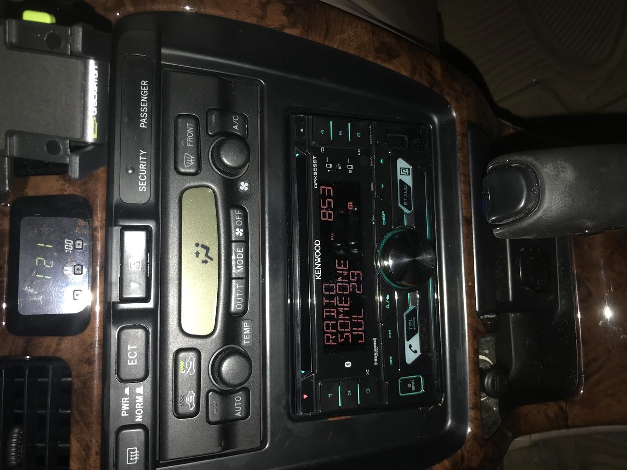

Sweet!! It’s in and sounds awesome!!
Thank you all for the help. Now to test the cd skipness.

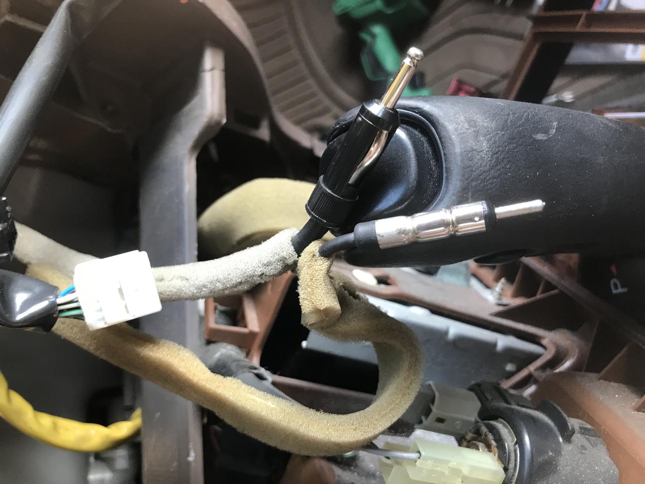

Is one of these 2 the antenna or speakers?
the leftmost black cable is the antenna cable
They're actually both antenna cables. 3rd gens have two. One in the front that is the motorized one and a 2nd one that goes to the back passenger window. It's what you see framing that cargo window. They make a Y connection that you can find on amazon if you want them both hooked up. Currently I only have the main line and most of the time it works fine. I do want to get the rear connected as the AM side can be weak at times.

One happy girl!! No skips flying 75 down chicago expressways or on the regular streets I drive on.
Kenwood Double Din bought n wired through Crutchfield.
Took me about an hour or so to install.
I did not know the regular speakers in the Runner were that good.
This truck keeps surprising me with how easy and awesome it is.
It’s now beer-thirty!
yeah after research i found out what you just stated thanks for the correction. a lot of people just use the one though so to my defense i wasn't completely wrong... :guitar2:
No worries. I was more adding to your response than correcting it.
