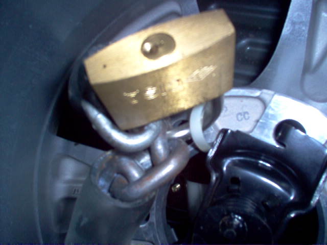

I do use something similar: a big thik chain covered in plastic which can be bought in any hardware store and a key lock. The platic cover is maily to avoid rattle and of course oxidation. I like your idea though of putting a plastic bag over the lock to keep water out.
Here are some pictures.
