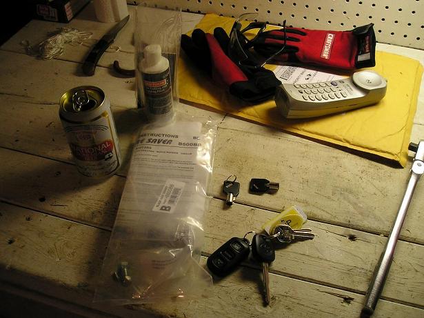

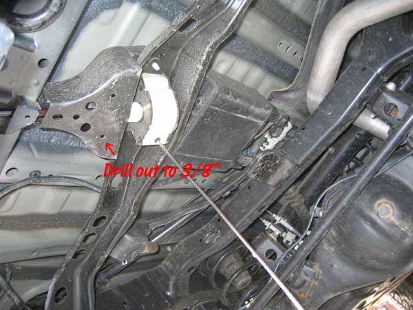

Installed my Winchlock. This is what you get.

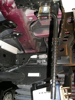

Drop the spare. Everyone should do this once, before you get a flat.

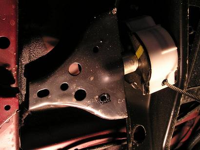

Drill out the hole on the driver side. I used some tap/cutting oil.

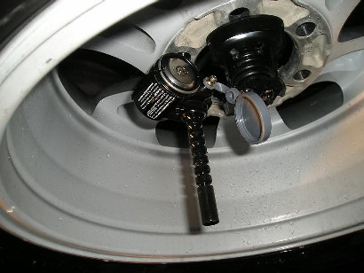

Locked up. You can't have the rod pass through lug hole where the guide goes.

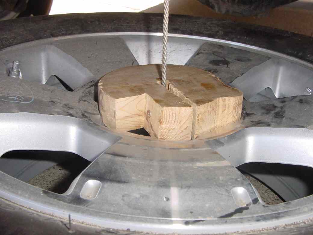

I took DanC suggestion and made a block from 2x6 cedar. It fits into the circular cavity and takes up precisely the available height to up the cable winch when the tire is cranked up. There still remains a small exposed section of the swaged end hex below the block that I addressed with U-nails hammered into the wood. Other ways to do this are left to your imagination.
Also, I noticed rust developing between the stainless cable and the steel end hex. This is the old problematic galvanic cell corrosion of stainless against carbon steel. If you see this, put a small amount of oil or grease to seal off water.

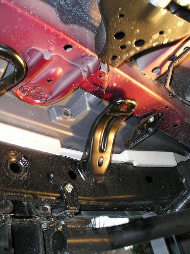

After reading this thread, I decided to order one. I think it was about $25 with shipping.
Here's my install...
