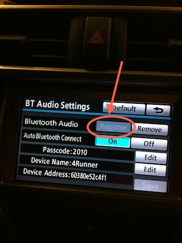

I had to register my iPhone 4 both as a phone and audio device separately to make it work.
