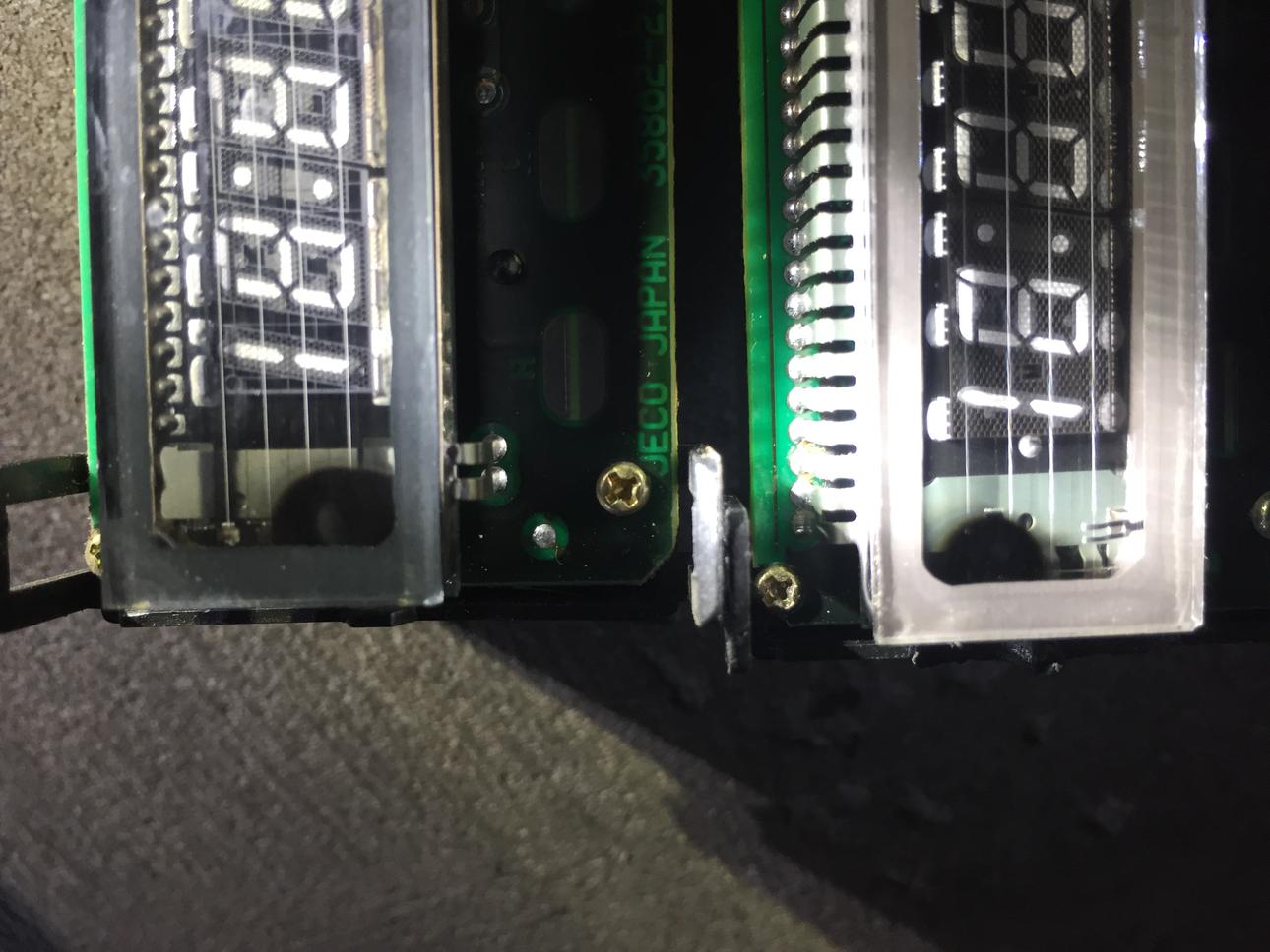

I have never had my clock work in the 6 years I have owned the 4runner. I have followed the diy clock fix twice with no luck at all. I got a clock from a friend parting out a truck who said it was working when he drove it recently. Plugged it in and no luck. Check the voltage and I was getting power on both the blue and grey power leads when on and just the grey with the key off. The green ground always worked but the white ground did not, I spliced a ground to it and now it works as it should. Plugged in the clock and nothing. Are these clocks that sensitive? I am wondering if I blew up both clocks because the one ground was not working. Becoming kind of obsessed with getting it working

I have pulled the original clock apart twice and soldered it. I am pretty sure my problem was the lack of ground on the ignition powered leg was blowing something on the board. I will pull it apart again and take a good look. A member on this forum was very helpful in sending me another clock (thanks Nissan) so I am hoping three times is a charm. I probably have spent more time trying to get the stupid clock to work than I have on most other mods to the Runner!

I finally have a working clock! Took too much effort and energy but it works. Thanks again to nissanh for sending me a working one. For those interested the white/black ground wire was not working so I would blow out the clock as soon as it went in. You can see on the two displays the burn mark in almost the same place. One is my original clock which no amount of my crappy soldering was going to fix and the other is a used one I put in last week
