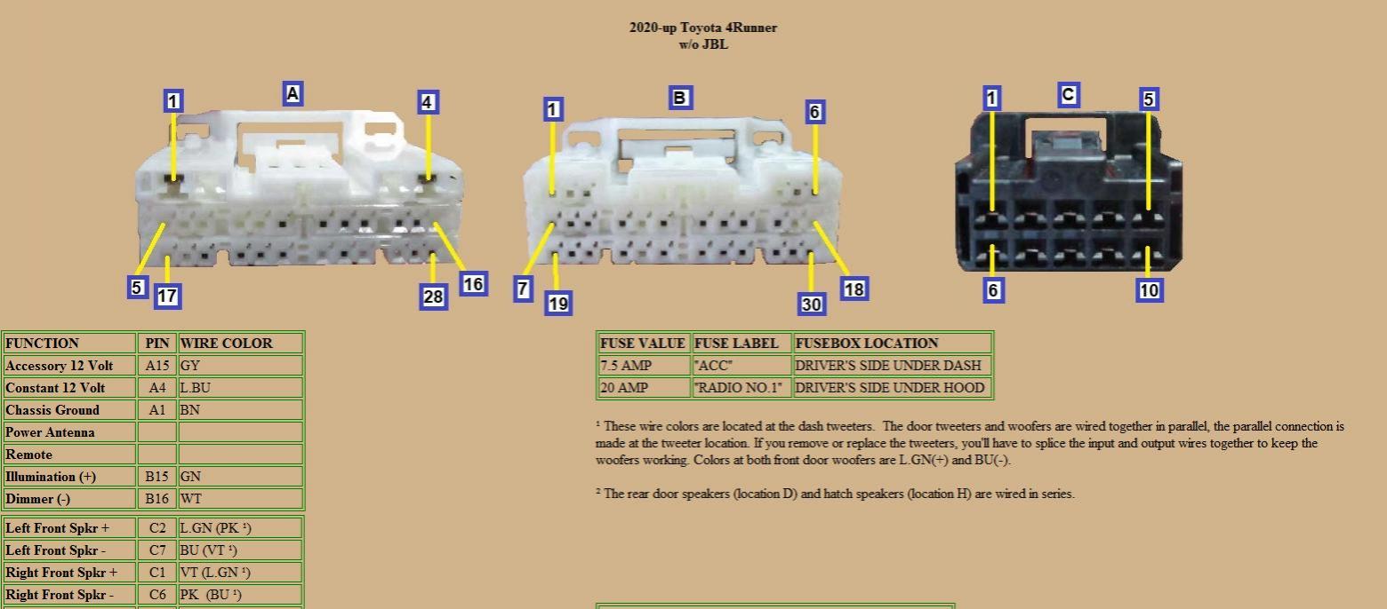

I found this pinout diagram on the forum from luppercut, but I don't believe it shows the rear speakers in this diagram. Do you know if the Front speakers are a full range speaker that would work ok for the LC2i to tap into and grab the lows needed for the amp and subwoofer?
Also - is it worth buying this kit from TacoTunes or just splice and roll with it?
I can't speak for that kit but I really liked the PAC harness in my wife's Highlander. Tons of options if you end up adding an amp to the other speakers. PAC LPHTY02 LocPro Advanced T-Harness T-harness for adding an aftermarket amplifier to select 2018-up Toyotas without a factory amp at Crutchfield
Many report the dreaded bass roll off/all pass filters from the stock signal. The accubass function of the LC2i should help somewhat but to what degree I can't say.
