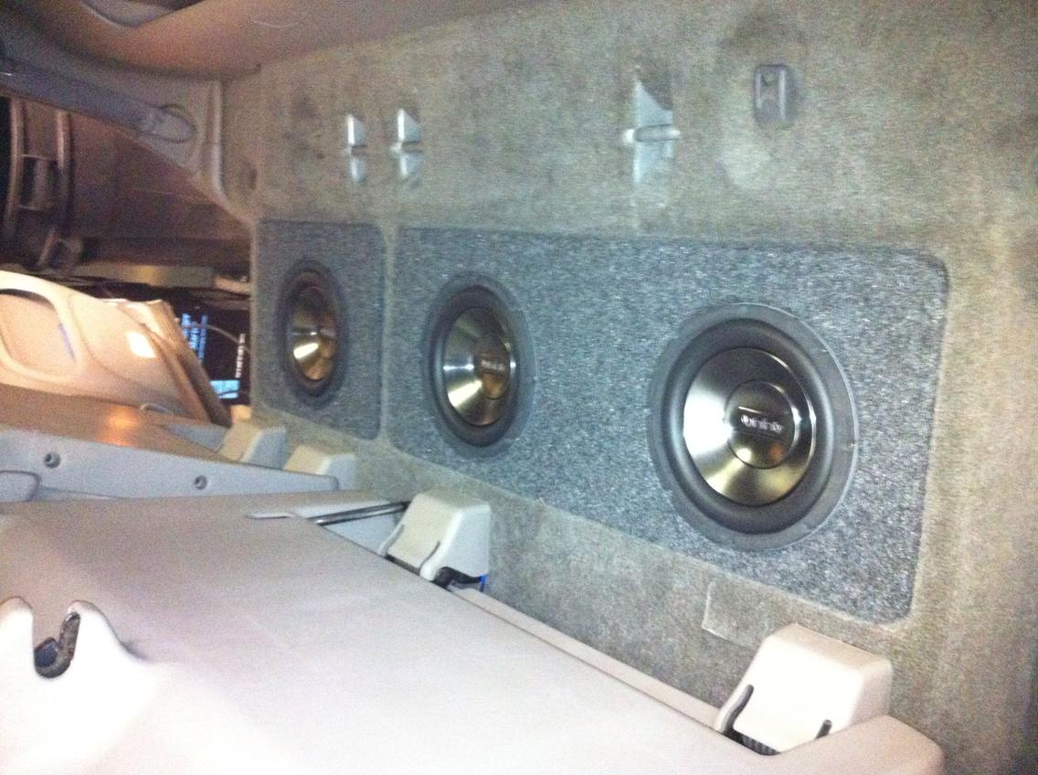

I haven't seen one done on that location but i don't see why you couldn't make it work. Although I wouldn't recommend mounting the amp in there due to lack of airflow. Your amp will cook without being able to breath. I myself don't care for the "boom". I'm more about clarity. I did sorta the same in my tundra in the compartments under the rear seat with 3 8" infinity's and it sounds great.
Wow that looks real clean! I bet that's got a nice kick to it. I'm inclined to just try it out and see what happens.
Thanks man! Give it a shot but try cutting a piece of ply instead of your factory panel like I did in case it doesn't sound right. That way you could always go to plan B and not have a big hole cut into the cover. You might have to find an alternative way to mount it but it's worth a try.
