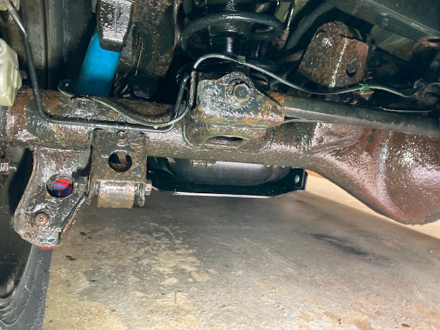

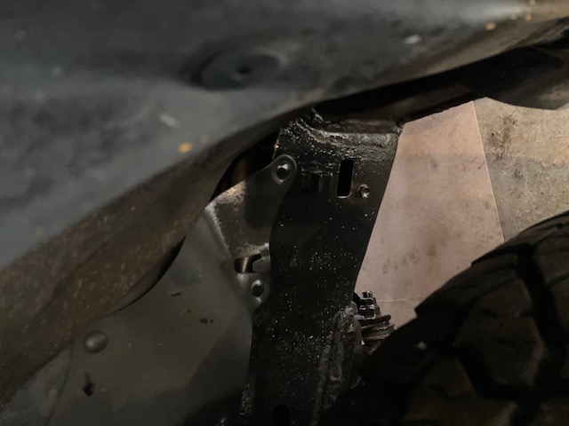

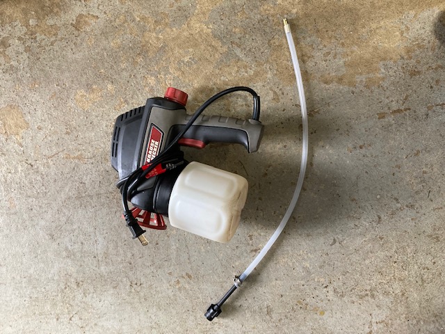

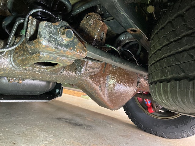

Last year I used NHOU on the frame and a year later, it looks like nothing was done. The surface is dry and rust again.so I ordered another gallon this time to reapply. Wouldnt you know it? 2 days later, I find some videos on Blaster’s Surface Shield. From all accounts, it seems to stay put for at least two years. I ordered up a gallon from Amazon. Comparing the two products, the NHOU is like peanut butter vs surface shield which is like a latex paint in thickness. +1 for Blaster. Harbor freight had a sale on their airless paint sprayer $19 down from $40. I bought one and used it to apply Surface Shield yesterday. Worked awesome. I used a full spray bottle on the undercarriage. I recommend using a fan to blow the overspray away from you. A mask and goggles for good measure.

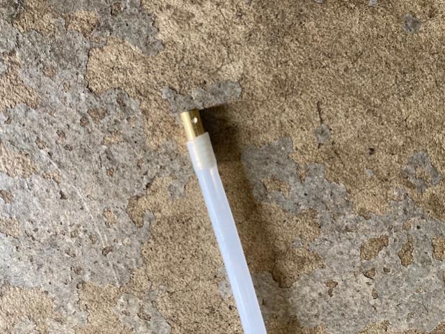

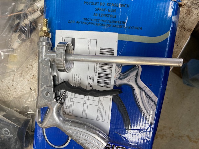

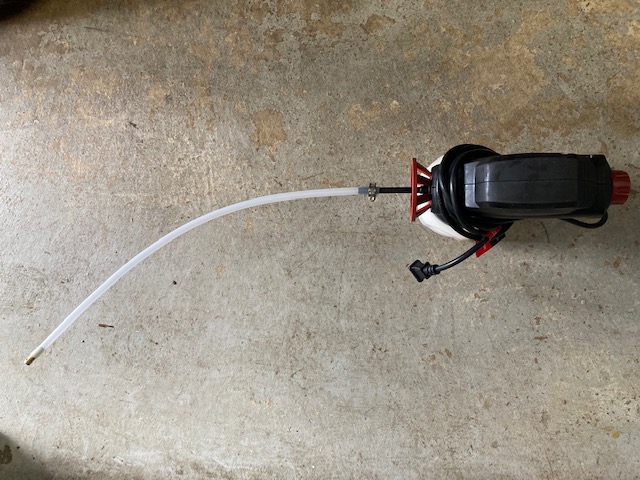

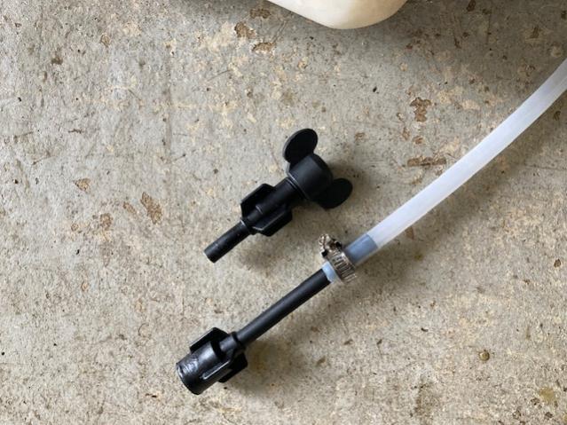

In the process of looking for a sprayer to apply it, I found a air undercoating spray gun on ebay for $15 shipped. The air sprayer looked like it would aerosolize the coating too much. But I was able to use the 18” flex nozzle on the harbor freight sprayer with a small conversion of the extended nozzle. I cut the end off and slipped the flex hose over the solid nozzle, hose clamped it in place. I plan to coat the inside of the frame rails next weekend.
Search out Surface Shield on youtube. Still lanolin based but guaranteed to stay for two years. For now Its wait and see but it sounds like a better product.
