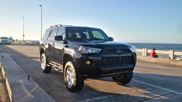

read the stickies up top all the answers you seek are there. I run 5100s, stock coils up front and SAW 1.5 coils out back and LOVE the setup!

Hey [MENTION=131488]ST1FLER[/MENTION] I love your lift setup!
