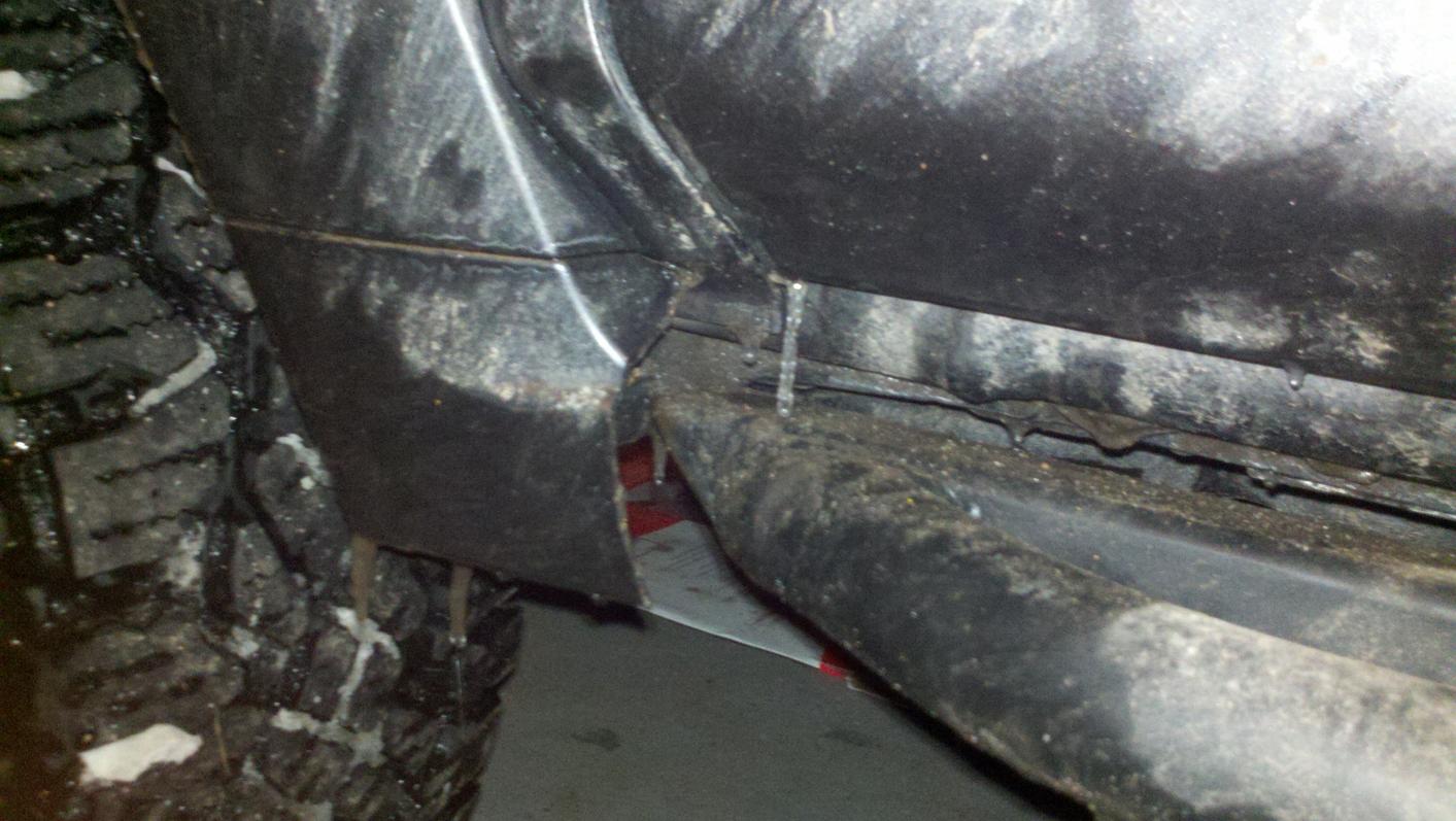

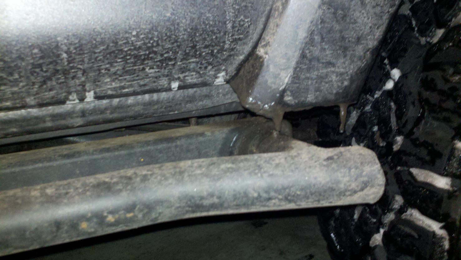

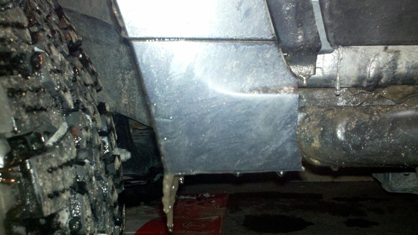

Here are a few pictures of my rockers w/sliders (little dirty from the snow the past couple of days) . Pretty much just took off the entire rocker and then cut the front couple of inches off and reattched that piece so it would still looked finished up. The piece is pretty flimsy, so hopefully if it hits anything the plastic will just bend.
Awesome that's perfect thanks so much!
