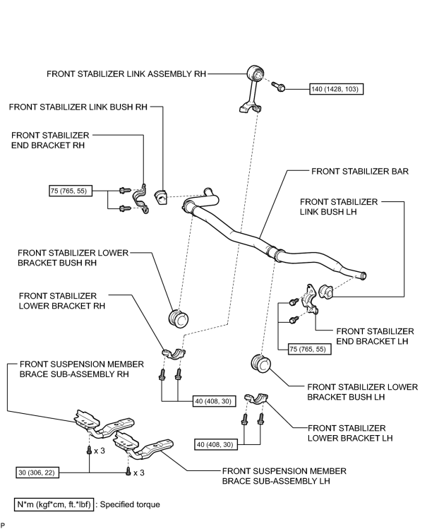

Does it have KDSS?If it does then the brackets attach the sway bar to the LCA's(lower control arms).
With non KDSS ,it can't have a sway bar on at all if the brackets are missing as it would be flopping all over the place.
Thanks for getting back to me. Yes, it has KDSS.
Does that mean the brackets need to be attached?
Your are talking about the front sway bar correct.
TE sway bars aren't like conventional sway bar brackets. They attach to the LCA's rather then the spindles.And Yes ,you definitely do need them and they were a pain to get attached when I lifted a KDSS TE. I hope they didn't just give up and not attach them.
See if you have these.......There's 2 end brackets attached to the LCA's 2 lower brackets that attaches the link and the hydraulic actuator.
This is the KDSS front sway bar.

Are you talking about the sway bar relocator brackets by chance? I don't think those are needed on KDSS models. Pics would really help.
I take it that unlike ICON, Toytec still needs (or at least benifits) from relocation brackets with KDSS.
Aftermarket sway bar relocator brackets are not needed on any lifted KDSS equipped TE ,regardless of coilover or spacer manufacturer as the design of the sway bar is completely different.

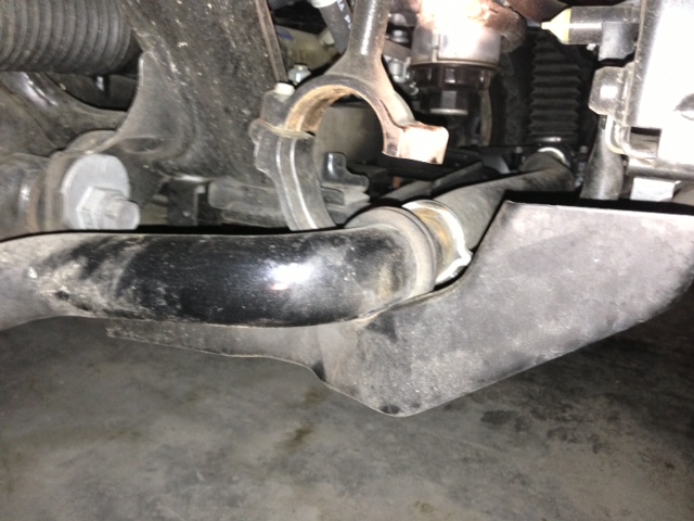

Here is a photo. It looks like they didn't attach the front stabilizer link and lower bracket. I assume this is not a good thing? Will it still fit with the toytec in place or does it need an extension of some sort?
Thank you all for the help.
You definitely need that bracket attached .There is no extension as it just needs to be jacked up into place and the bolt installed.Check for damage as it kind of looks like that bracket is bent from not being attached.
Be extra careful around corners driving it like til it's fixed.

That strap is a cast piece and has failed. Either the shop did not reinstall the bolt or they did not tighten the bolt enough and it rattled loose. Once that happened, the swaybar deformed the strap. I would not re-bend that strap, get a new one. Sway bars see an incredible amount of force.
Good luck.

Just got the truck back from the dealership (after they ordered the wrong parts twice). It is now working great. I've been driving with it busted like that for longer than I care to admit. The difference in cornering is very noticeable.
The aftermarket shop that installed the lift said they didn't take the bolt on the bracket out and that it must have been loose from the factory. And of course Toyota said it must have been the shop's fault. We will never know. But $90 later all is well.
