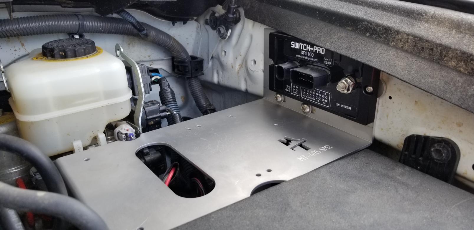

Here is a photo where I took the rubber/plastic and just put the Mount Tray under it. You would want to either do this or cut out around the Mount Tray as you definitely would not want to install it on top of the rubber/plastic cover. I did reply to the inquiry about the hood shock, it is close, but room is tight under there. I'm trying to work out getting a picture from inside with the hood fully closed, but thats complicated, lol.....
Do you happen to have any more photos of this tray? Perhaps a shot further back showing more of the engine bay? Thanks in advance.
Does this photo cover what you were looking to see ?
Thanks for the questions, keep them coming !

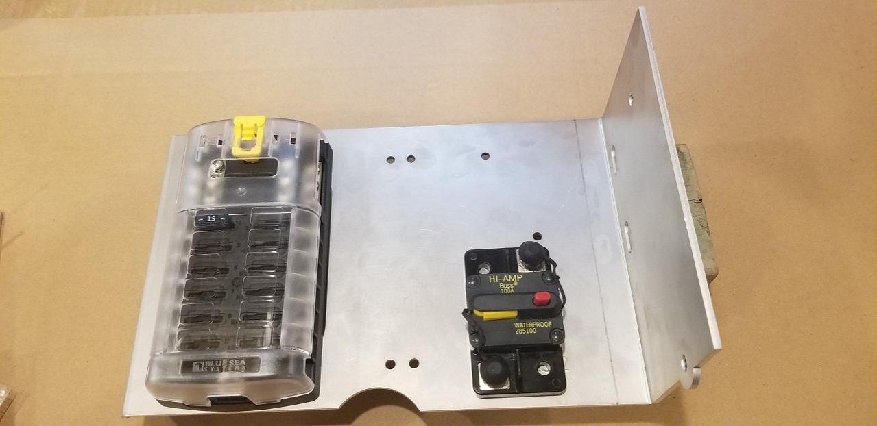

12 Circuit Fuse Block
I like this but would like space for a fuse block. Curious if this would fit an FJ as well? I have the SwitchPro in the FJ, not the 4R.
Here is an example of the possibility of installing a Blue Sea 5026 - ST Blade Fuse Block - 12 Circuits with Negative Bus and 1 or 2 circuit breakers on a different version of the Mount Tray. Of course, this eliminates the BusBar and Terminal Block. The slot in the Mount Tray would be between the fuse block and the circuit breaker. Any thoughts or input ? Is this something of interest ?

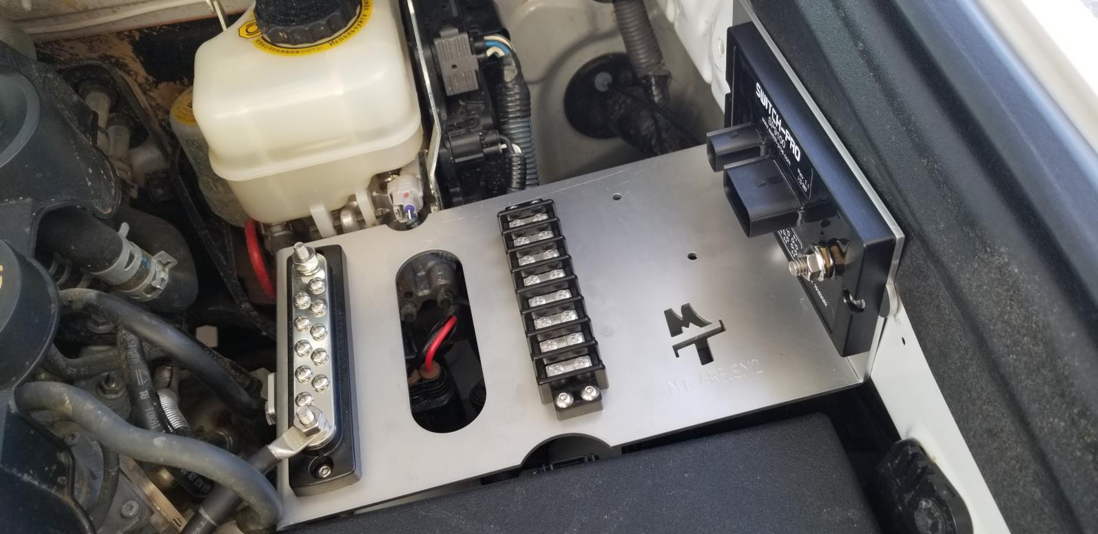

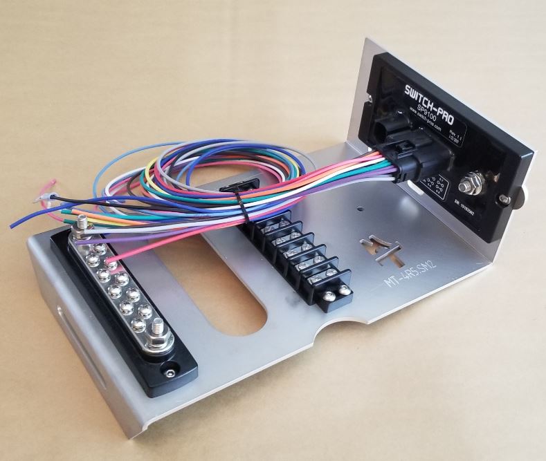

Final Install
I did the final install of the Mount Tray this weekend along with my assistant DJ Rouge, less the wiring of the SP9100 itself. I've been working on dialing in the MT itself that I've not spent any time on the main objective.
I did end up leaving the rubber fender lining behind the SP as it did not seem to need to be cut, in fact, I decided that I actually wanted it there.
Really solid, stable and sturdy install. I'm really excited to see people post up pictures of their setups.
Here are a couple more photos, although they do not look much different that what I've posted already. Thanks everyone for the positive feedback. As soon as I get the rest of the details set up (payment options), i'll post up a for sale in the classifieds as I think that's how I need to do it to comply with forum guidelines. I'm not expecting that to take long, but hoping to be able to ship by Monday next week at the very latest. I have 20 units ready to go.

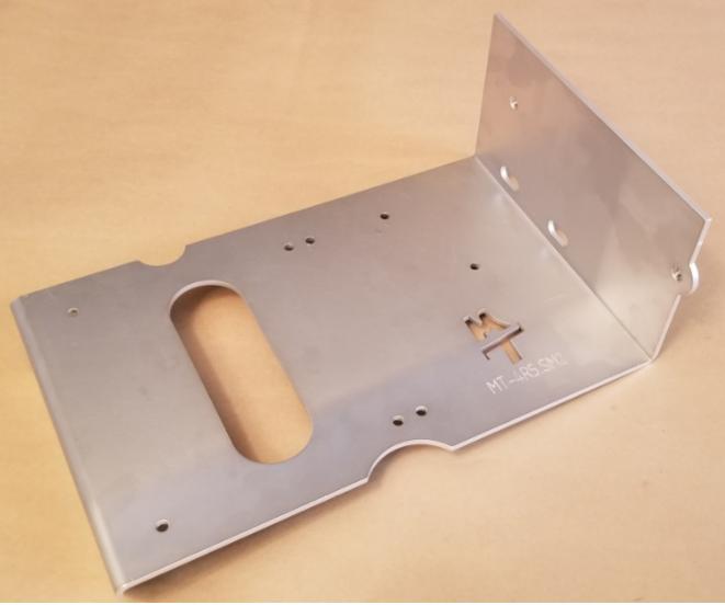

Mount Tray Ready to Go !
Finalizing some backend administrative details, but thought I'd post a pic of the Mount Tray that's ready to ship ! Holes predrilled for the Blue Sea 2300 BusBar and Terminal Block 2508.
Forgot to mention that the other two holes above the MT logo are for a Blue Sea Circuit Breaker.
Switch-Pros SP9100 mounting holes on the side for the vertical mount of the Power Module.

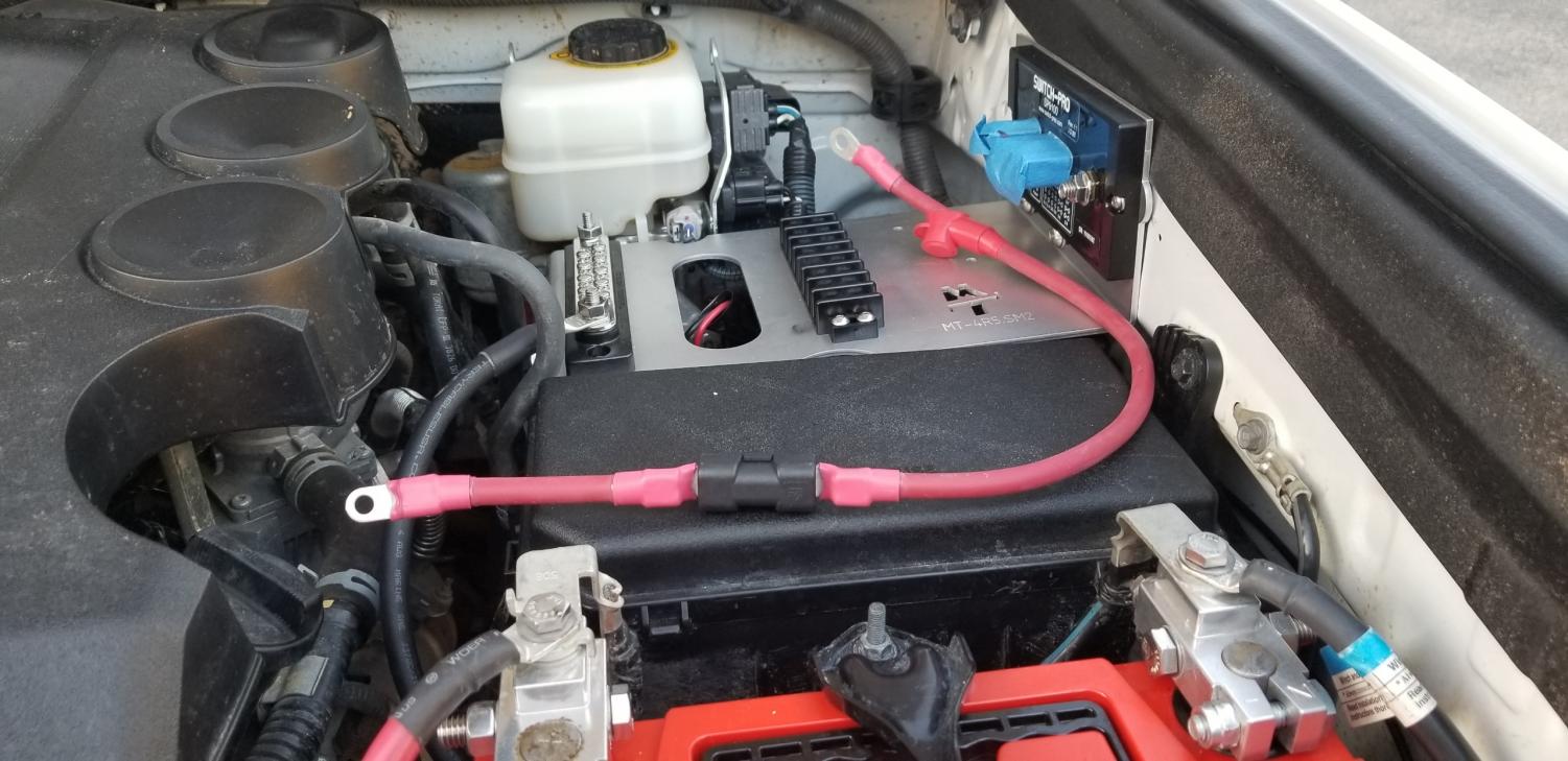

Switch-Pros SP9100 Power Cable
I had an inquiry asking if the power supply cable that comes with the SP9100 kit reaches from the battery to the stud on the Power Module... By a longshot it does, here's a pic:
BTW, as you can see, its not installed. Its not time yet, but when I do, I plan to run it down the side of the fender, fuse box and battery, and there is still plenty of length.
Someone posted on another thread that you need to use the power supply that came with the SP9100 or it voids your warranty... Just like the horizontal mounting of the Power Module - Switch-Pros says that it can void your warranty which is why I came up with this vertical mount....
Questions are good, it educates everyone, please keep them coming...
