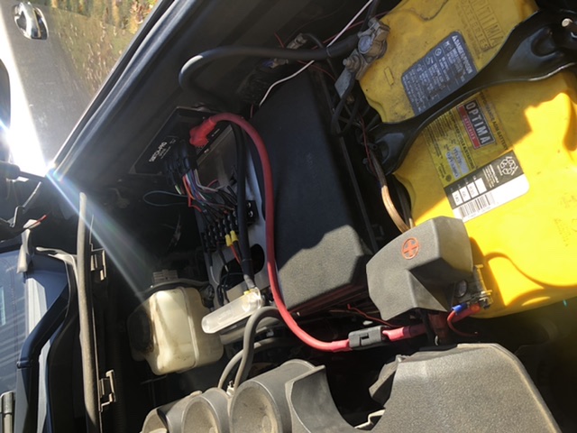

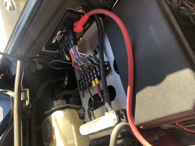

My install
Here are a few pics of my install, I still have to tidy things up a bit and reroute the battery and ground cables but all in all it came out pretty good. Install was very straight forward and pretty easy. I would definitely recommend this plate to anyone with a switch-pro.
Thank you for the pics, you did a great install. Very Clean !!
