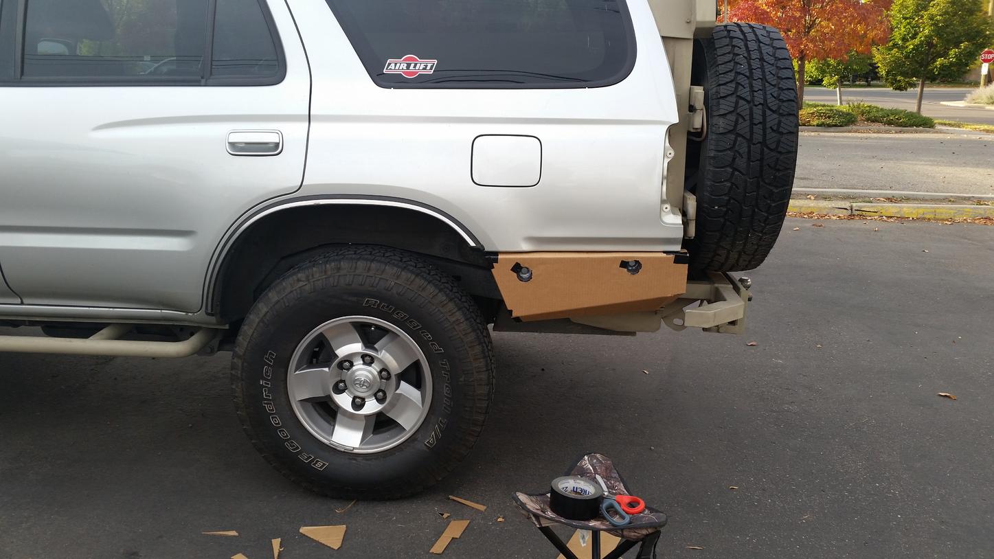

Here's the cardboard pattern. I'll reverse it for the other side and add bolts for a ladder.

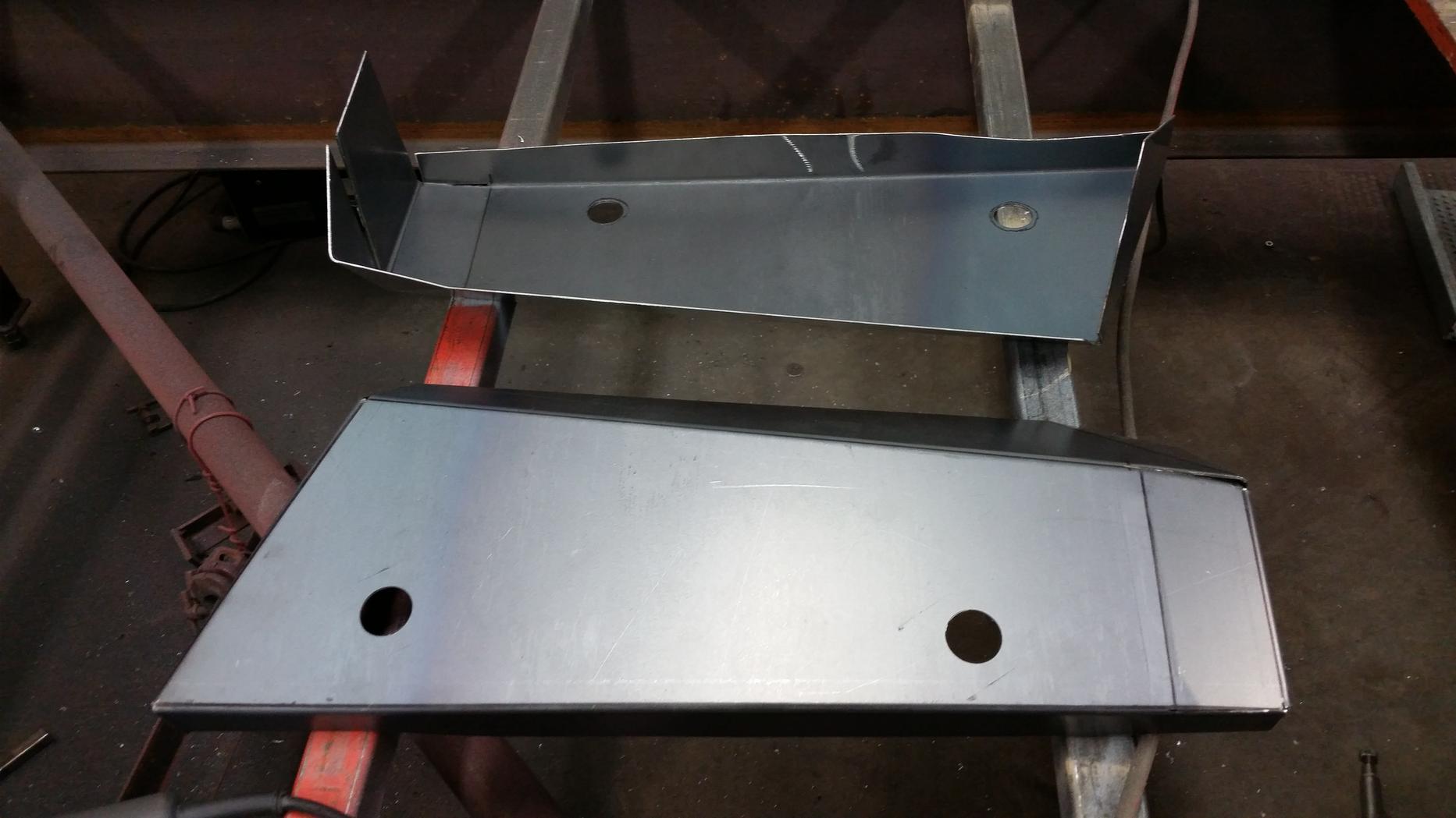

Rough steel origami is done for both sides. Holes will get bigger when I verify exact locations.

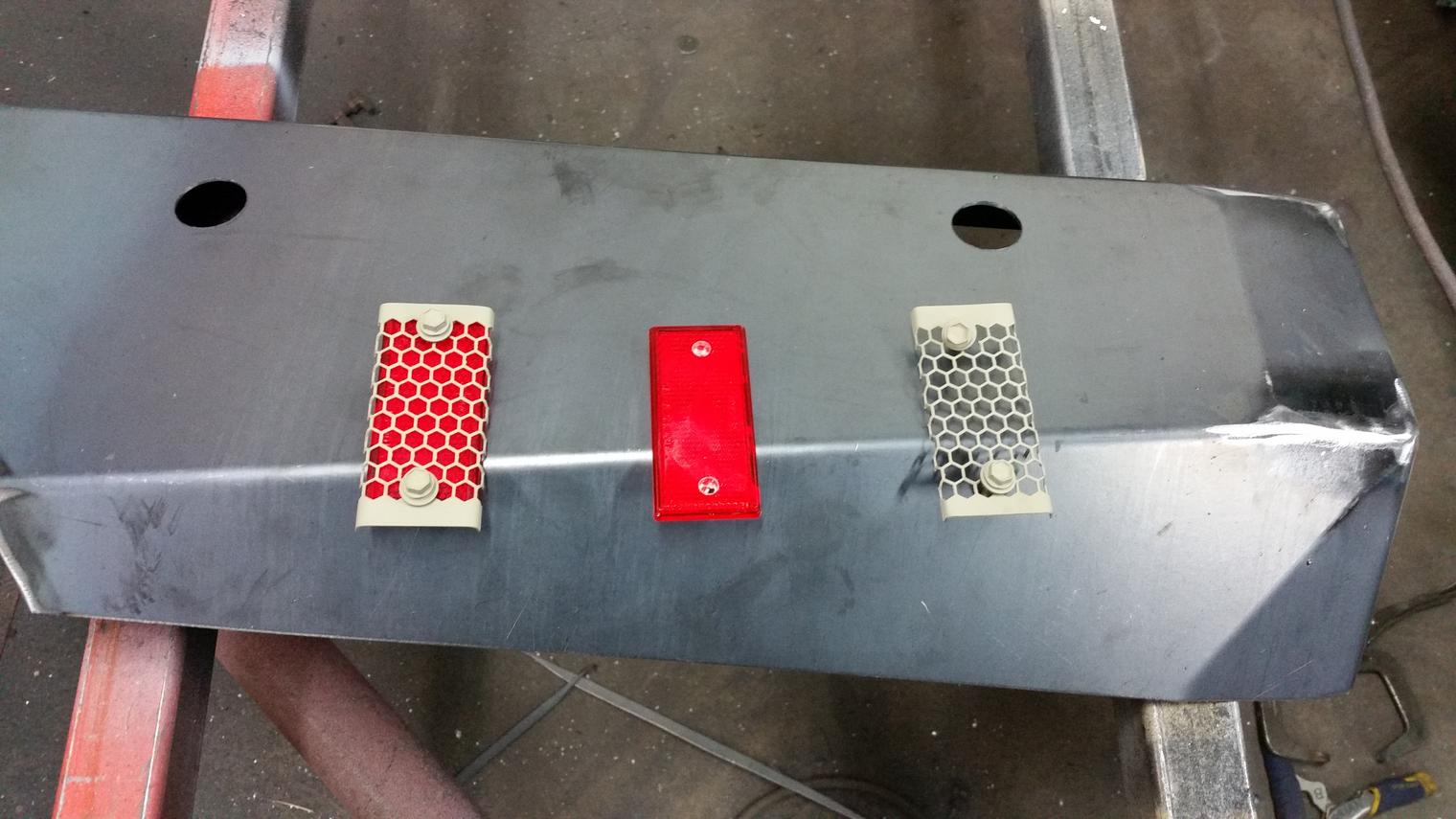

I made up some custom reflectors for the ends. Bought cheap stick on one's then made the mesh covers. They were a little too plain looking and I like little details.

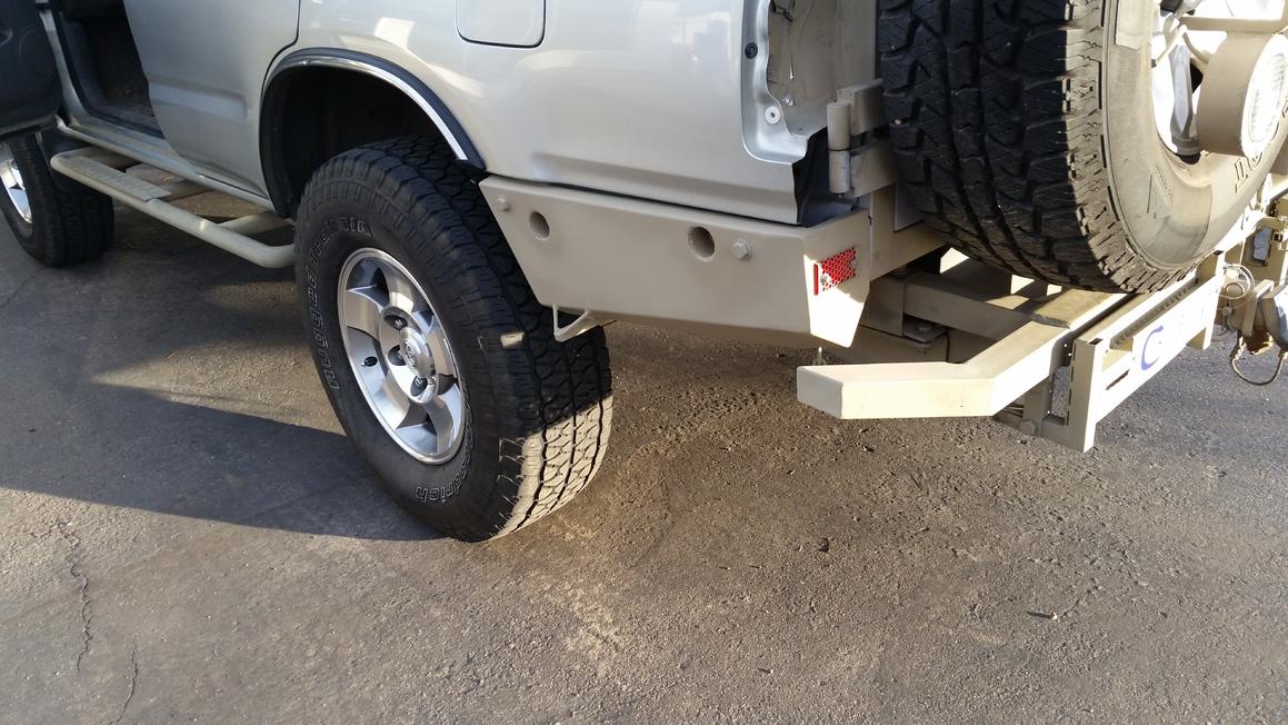

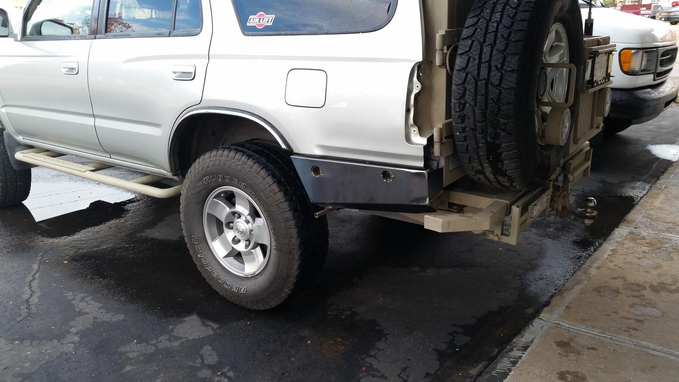

The back end is finally getting trimmed at the bottom. Just finished painting and undercoating so I bolted them on. The brace rods are for mud flaps. They will be custom cut clear vinyl so they're unique. I welded short chains on the back to tie them up when off road. That way they don't get ripped off when backing up against hills or large rocks.

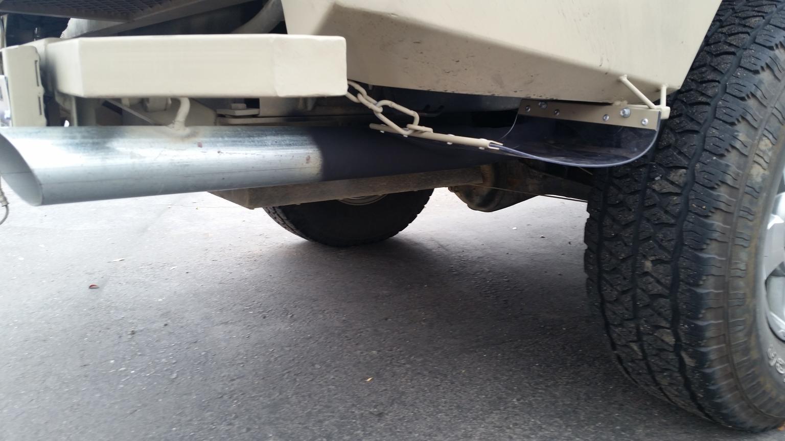

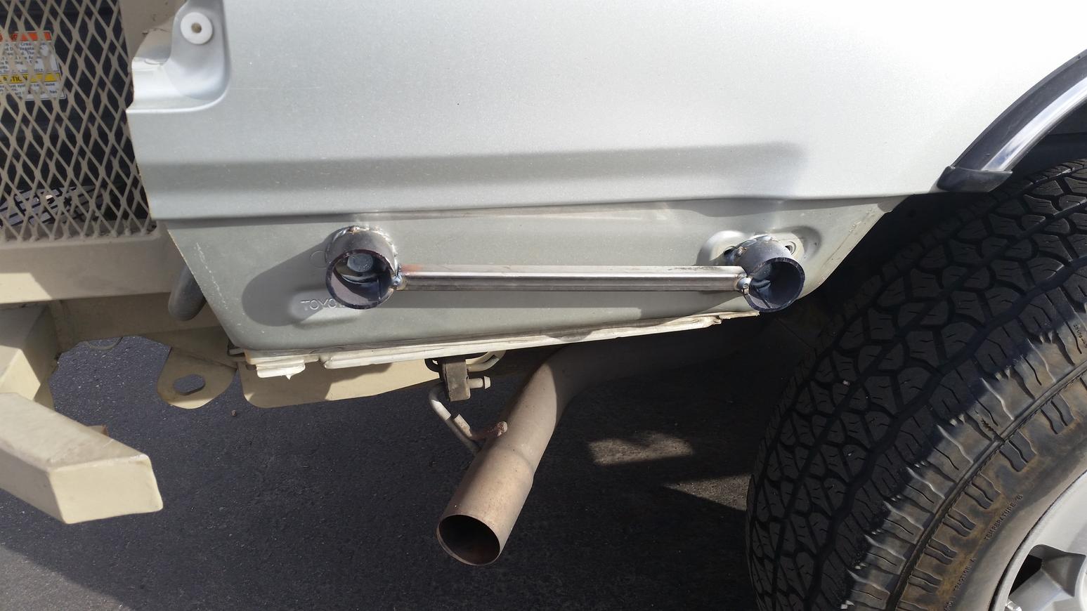

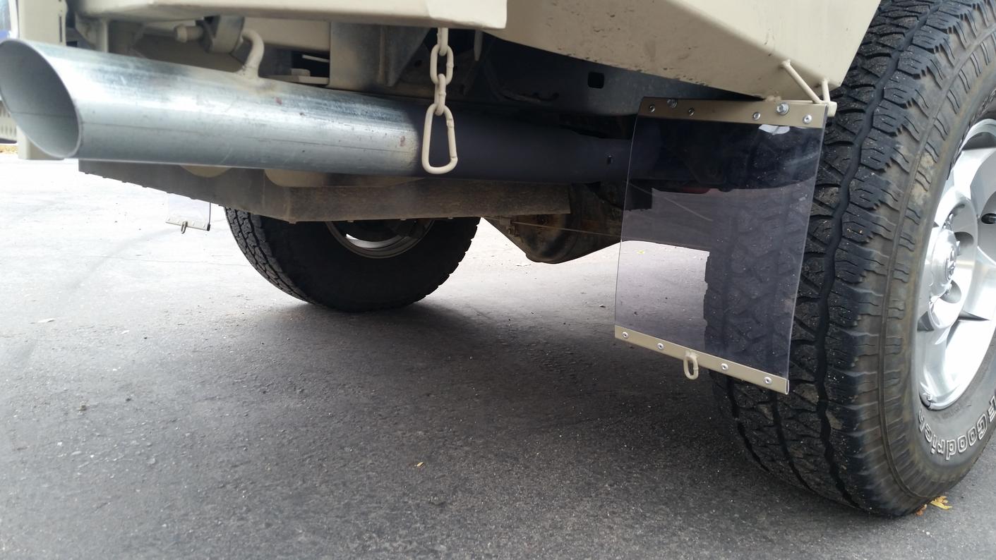

Finished the mud flaps. The stock exhaust was in the way, so I whipped up a new one I'll replace when I do the muffler. First pic is street mode, second is off road mode for clearance. So now there's steps and mud flaps that change for the trails.
