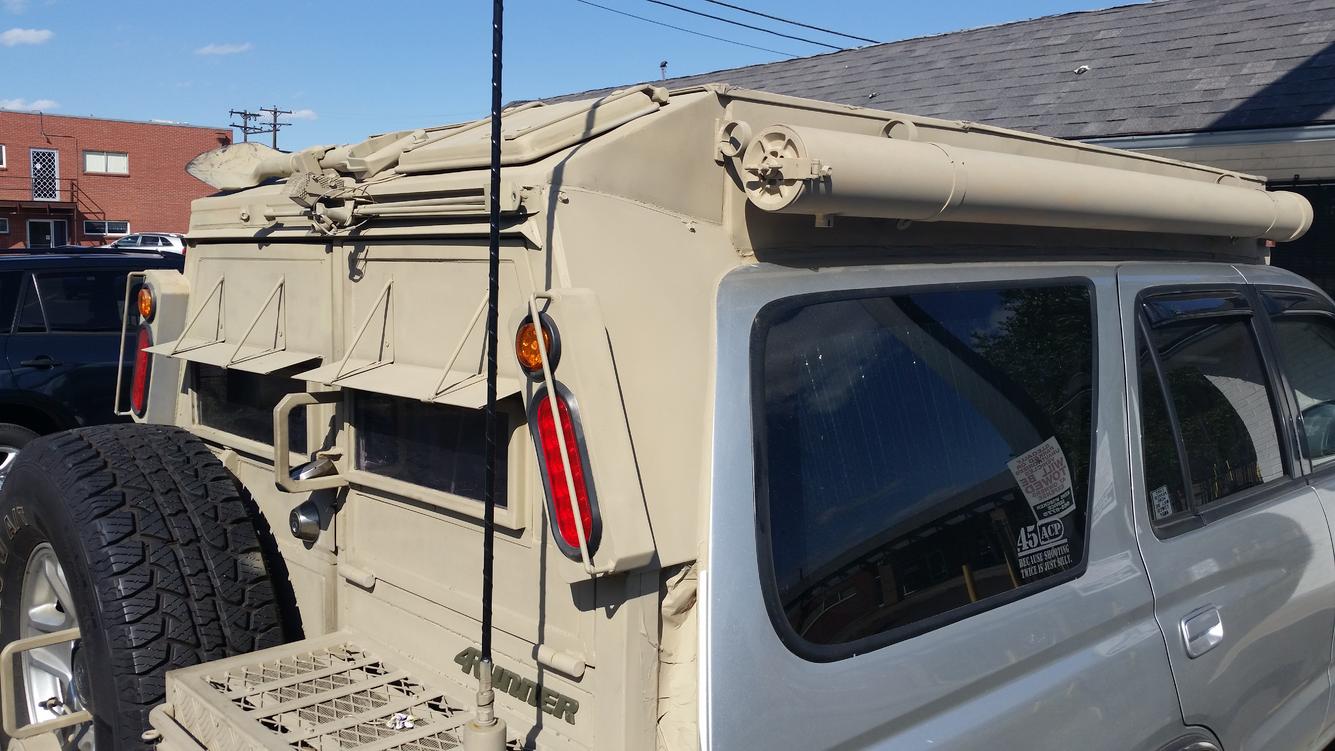

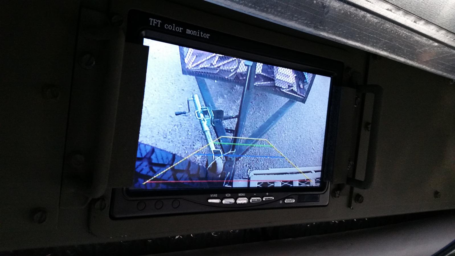

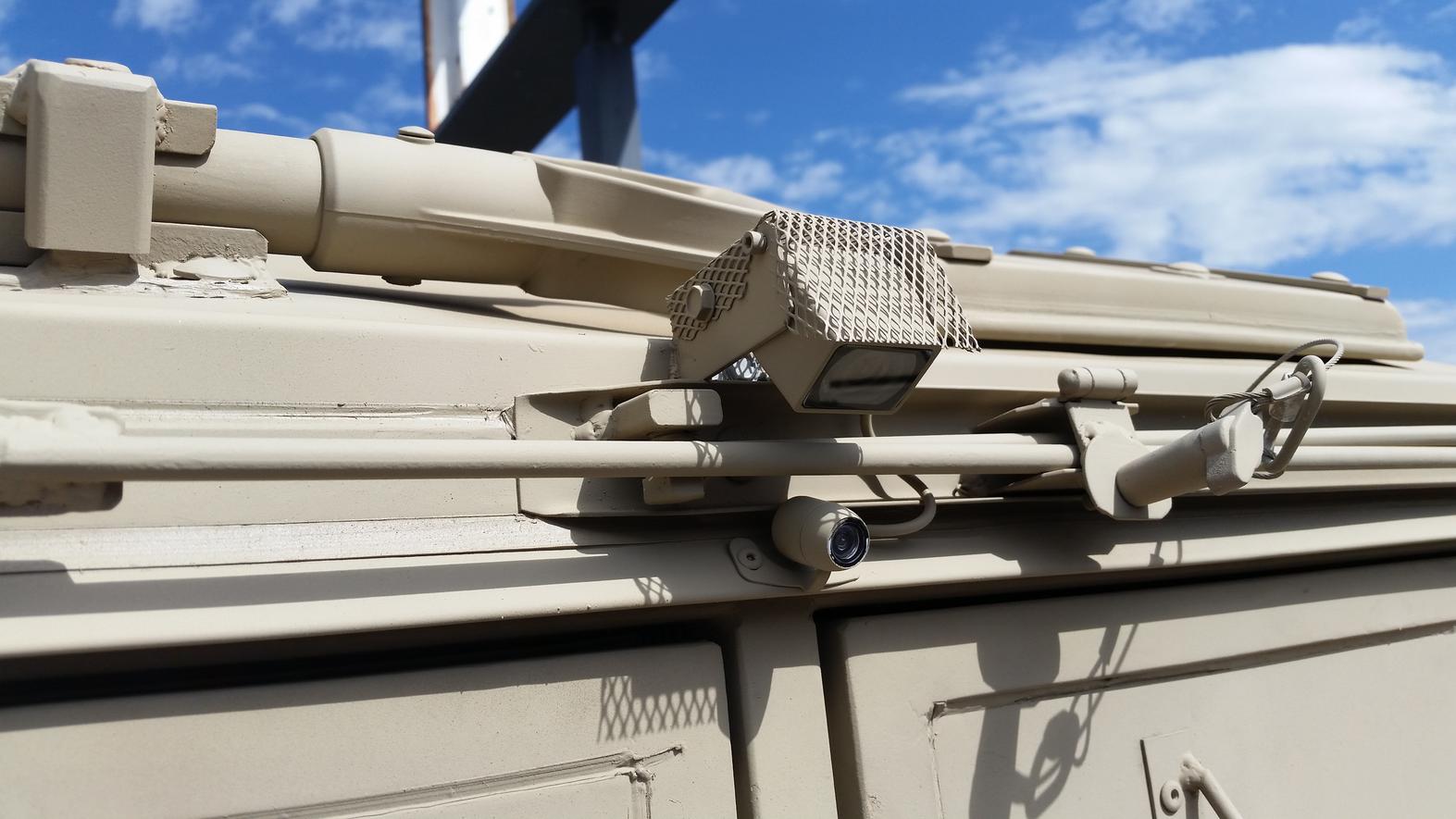

Actually, it has been really nice. The small camera is a wide angle for seeing behind while driving and backing up, the one pointed down gives a better idea of how close something is while backing up since the wide angle makes everything look far away. Also, being high up, it shows the trailer hitch so I can hook up a trailer in one shot without getting out until it's perfectly aligned.

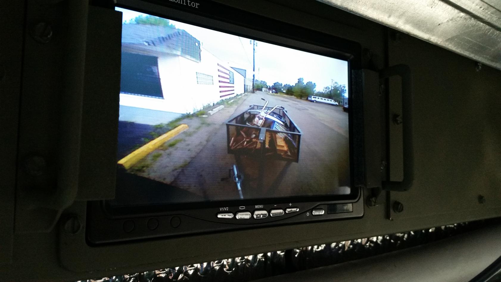

Got a shot of both views pulling a trailer today.

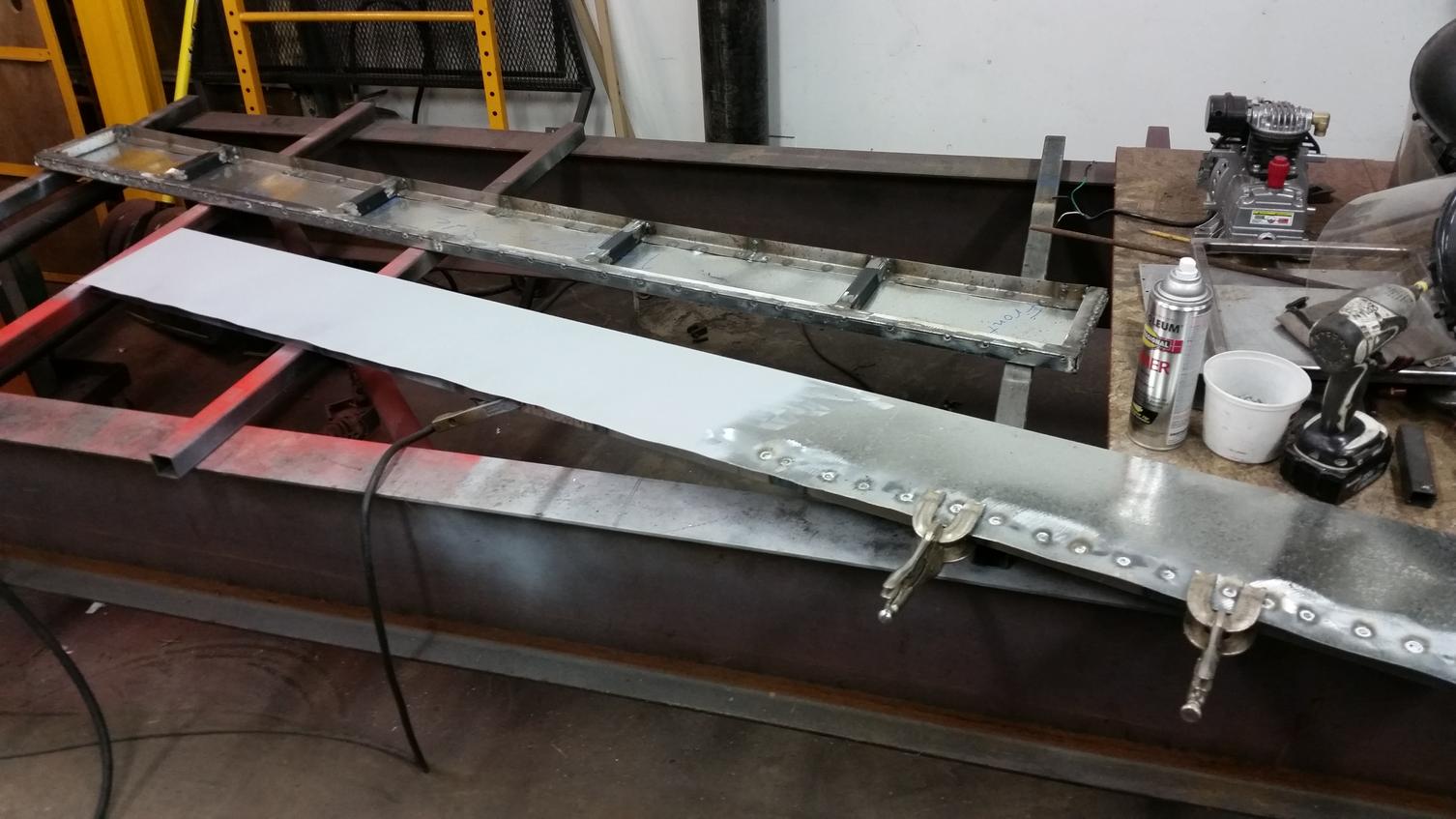

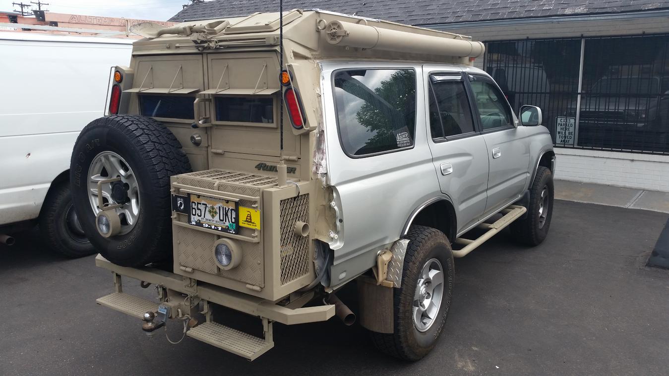

Started laying out the sides of the roof. Now I need to weld up the frames inside and paint. Hope to put them on this week. They look flat but most of it will be covered ultimately.
Made some official mounts for the storage tube. And I've realized you can never have enough tie down rings.
Made some progress on the roof panels this morning. I'm using scrap material so it looks a little rough.

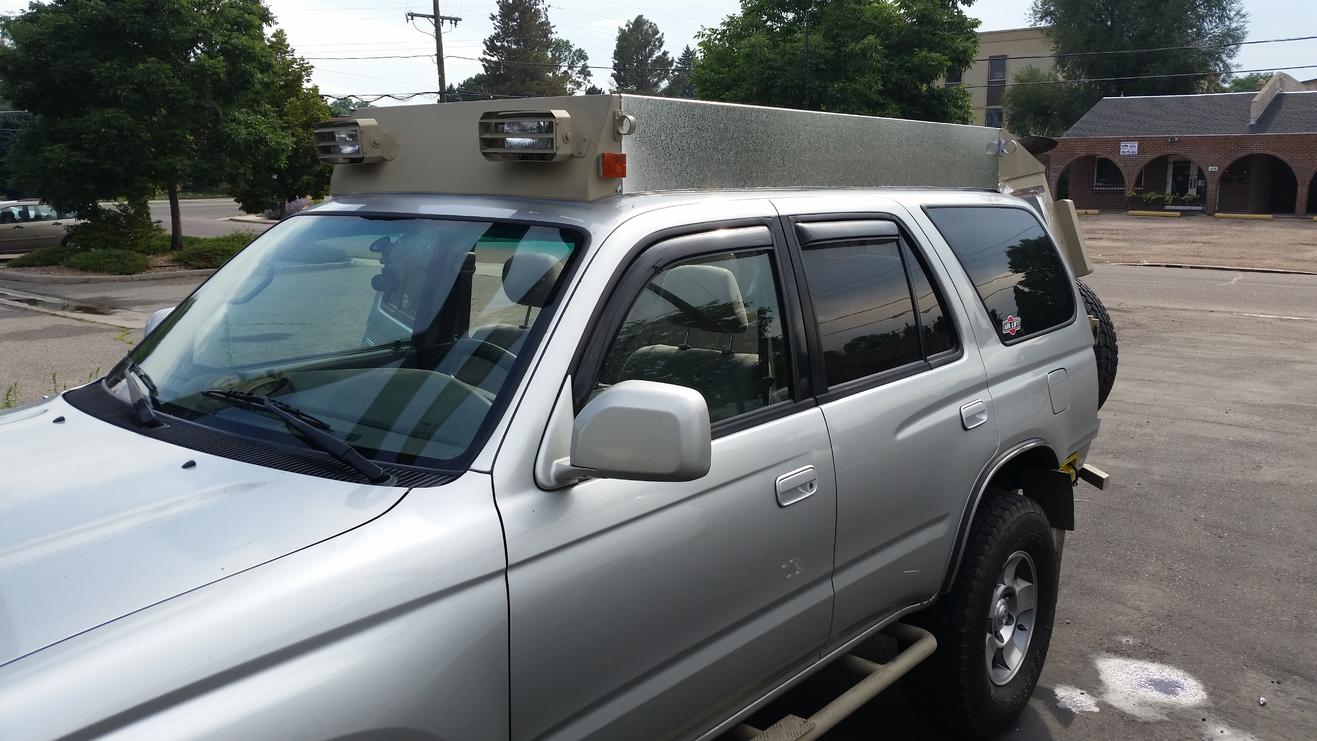

Got the sides on... then the rain came so I threw on plywood. Still have to make up cross members and the top, but it feels great not looking at galvanized sheet.

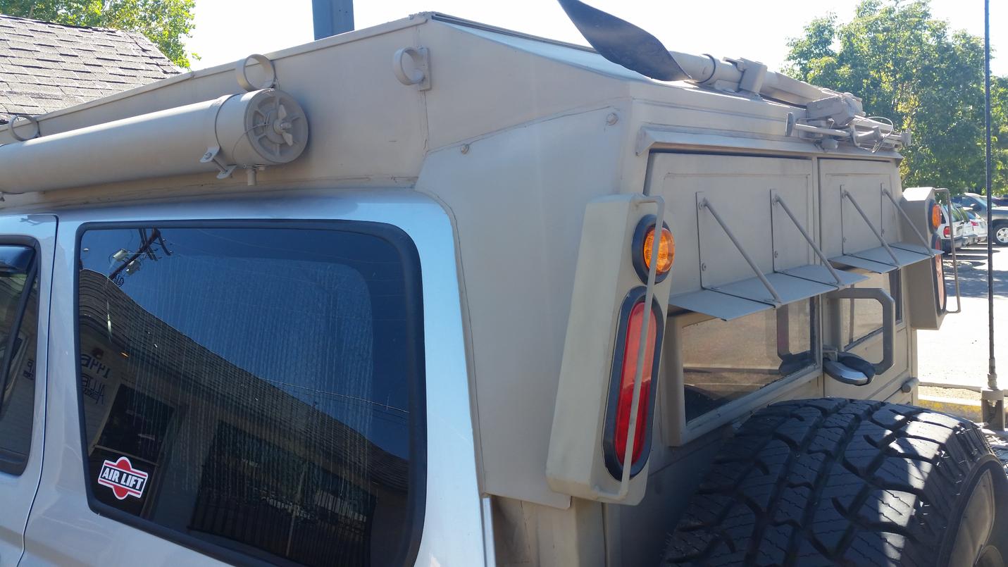

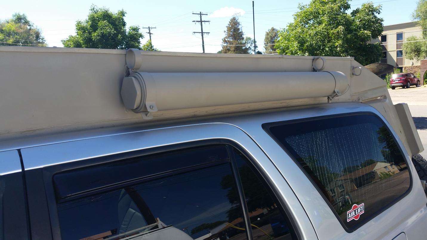

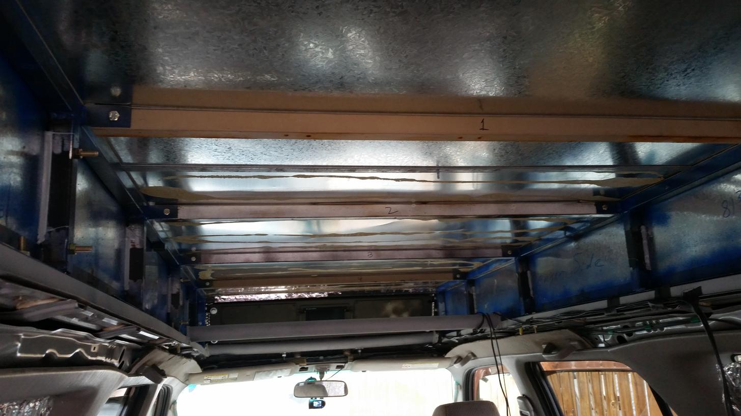

Put in the cross members and a temporary metal roof. It rained today and didn't leak, so I'm happy. Also got the storage tube on.

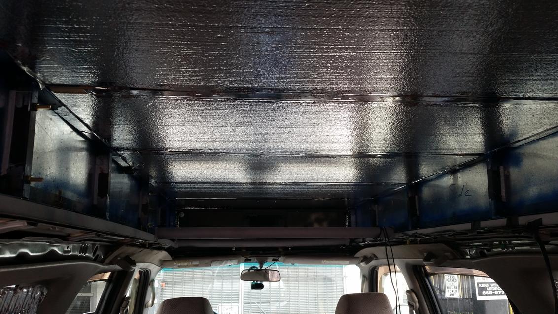

It gets hot inside since it's a metal box in the sun, so I cut foam sheets and it's much cooler now. It's also a lot quieter when it rains.

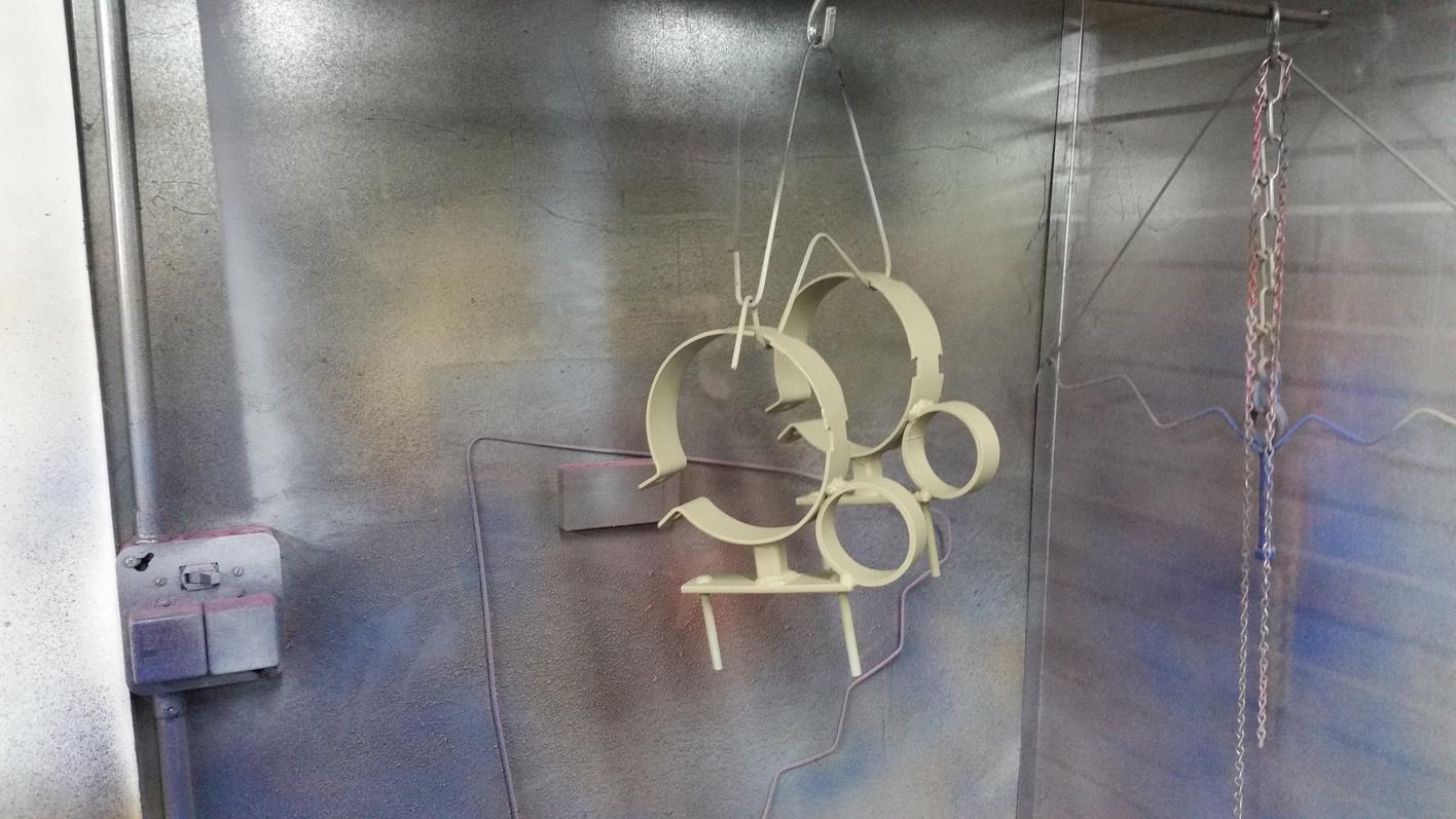

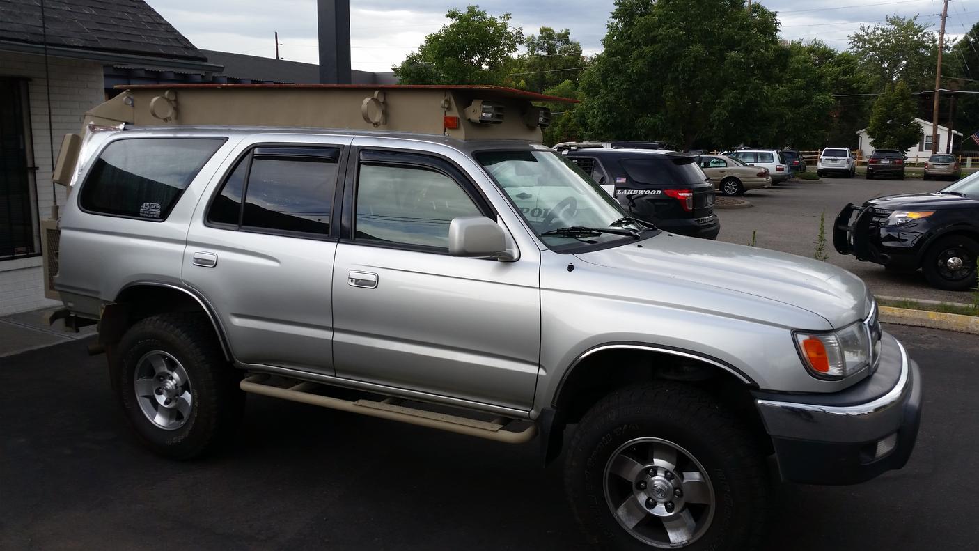

I added another smaller storage tube on the drivers side. I'm thinking about using it to store a small folding chair. End caps are almost eight dollars, so I got inventive.

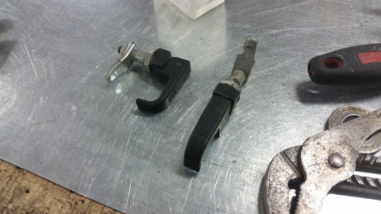

Found these on a large rooftop unit I'm parting out. They'll look awesome on one of the access doors. Also, my battery died so I have a new one with more cranking power. I definitely notice the difference.
