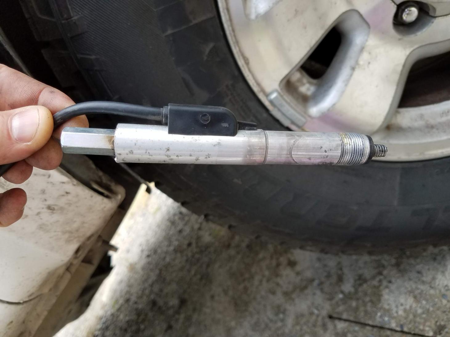

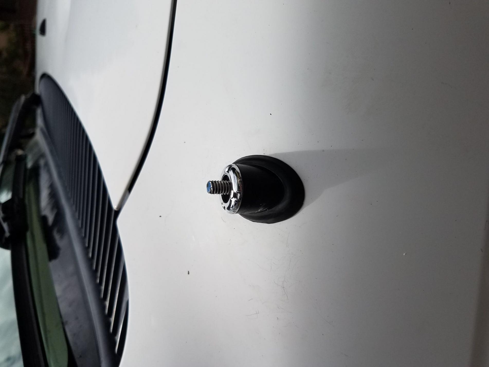

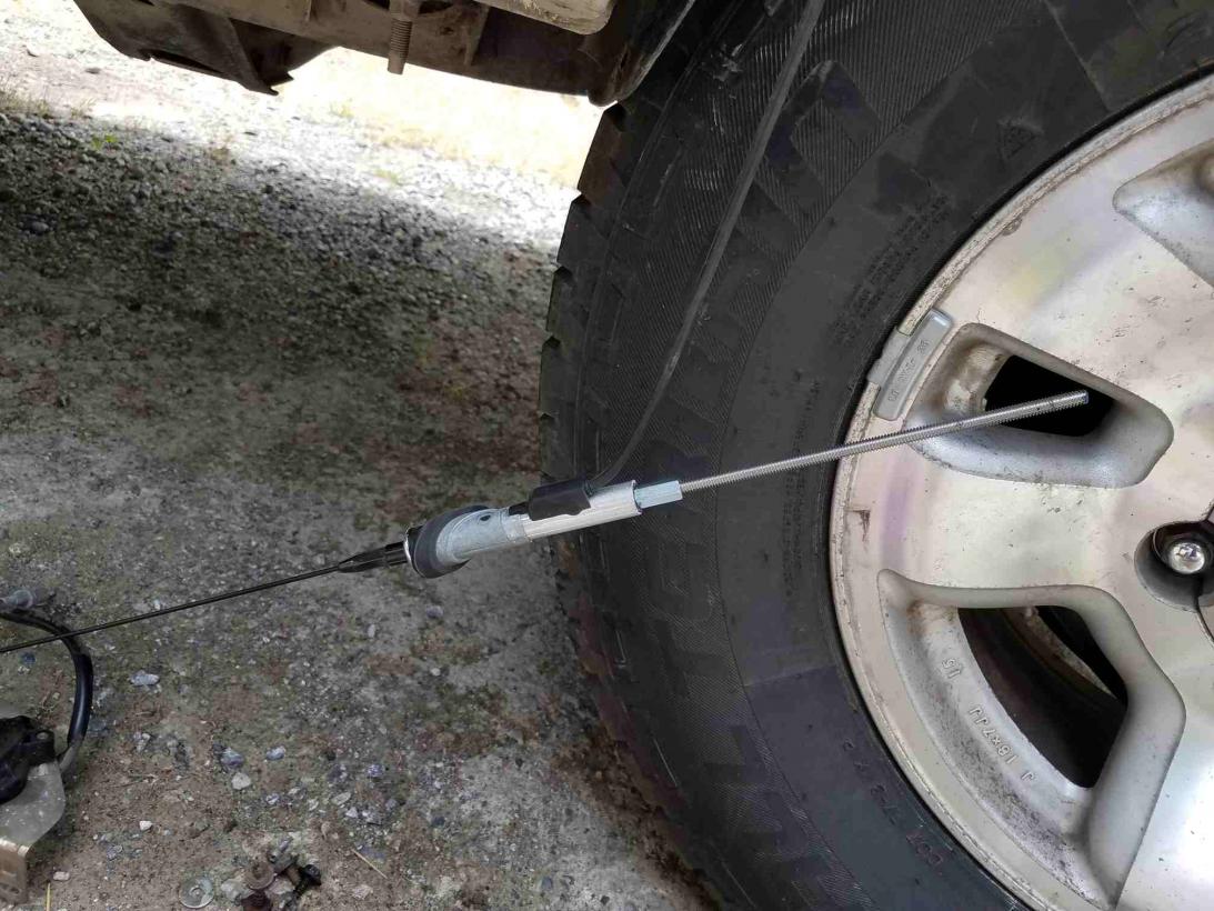

My solution to the power antenna mast being MIA, no radio frequency, and the power antenna motor driving me nuts.
This did not require any new wiring to the radio.
Theres 2 couplers with the edges ground down in the middle to make contact with the antenna wiring and the bottom/middle couplers tacked in place. Its a tight enough fit that I had to tap it into the sheathing with a hammer.
The result is an antenna mast that will take any 1/4x20 thread or adapter. Seems to work exceptionally well.
All in all... $2 for the allthread, $2 for the couplers, and $11 for the shorty antenna with adapters.
First photo was test fitting and checking reception. 2nd photo is of the allthread cut down and couplers tacked on place and after tapping with a hammer into place in the original tube.
