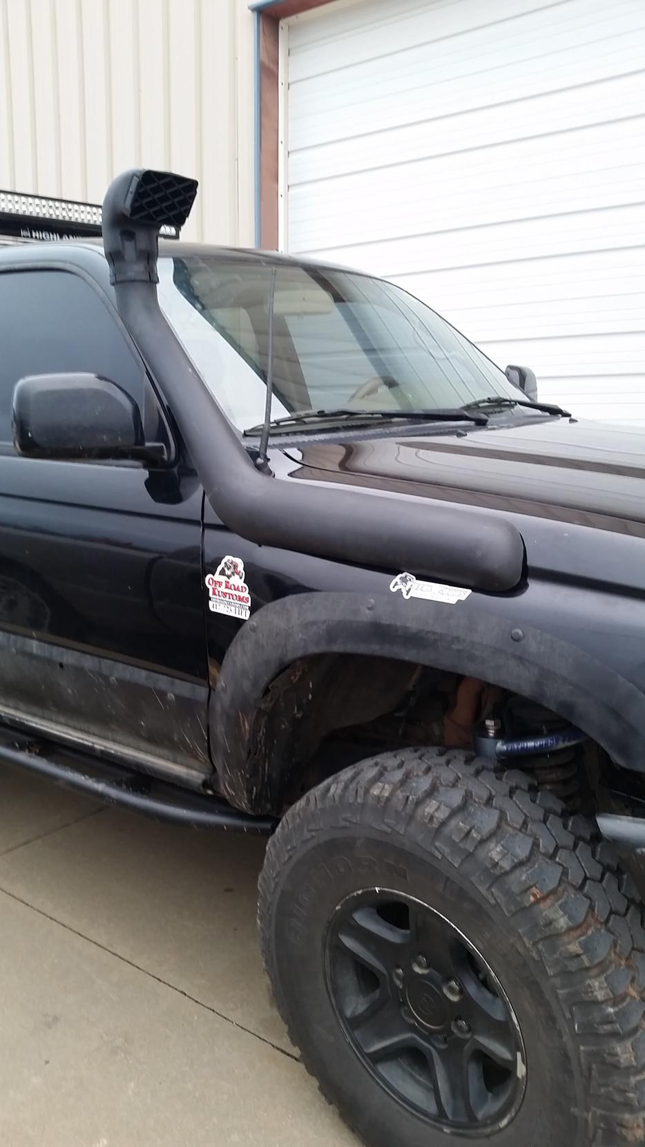

Not sure what the "Taco Whip Mod" is but I disconnect the quarter panel and removed the motor and antenna. Then I installed this whip. Got sick of them breaking out in the woods.

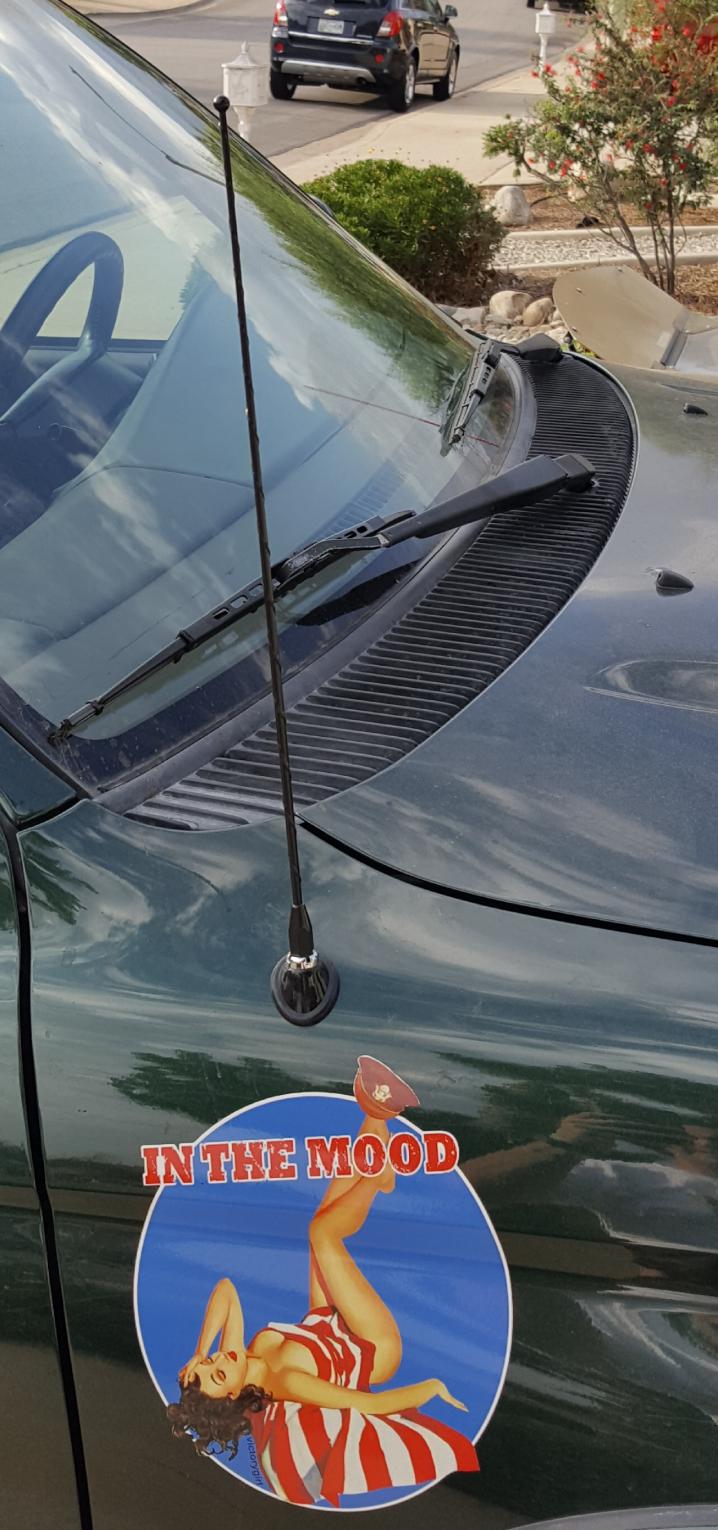

Just finished this the other day too. Toyota base and a 15 inch whip. Looks much better and reception is great. I listen to am/fm and Bluetooth radio adapter (stock radio for now).
