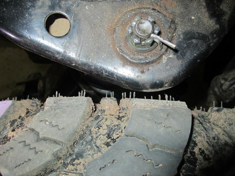

Interesting that you were able to run that wheel & tire combination post lift with no rubbing. I have the same wheels with 235/85R16s and would not be able to run any thing wider without spacers. My center of hub-fender measurement is right at 22". Whats yours ? 001 (800x600).jpg You can see the rubber whiskers are brushing the control arm.
