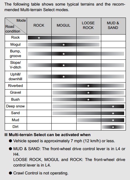

I know right, damn Toyota for being so elusive with this crap and hiding it in the manual of all places :caked:

Too bad the rear diff lock only works in 4L. At least the Mud and Sand function works in 4H, but that's the only mode that does.
i know all of what you posted.. i want to know when do the elec. systems kick in.. a higher speed slip vs lower speed in each mode aka what does each mode offer systems wise that the other mode doesn't offer.. does it hydraulically allow the sway bar to move around more in one mode vs the other?? etc.. i'm not an idiot i know the basics people, and i know most of you don't know the answers either. THAT'S what i wish Toyota would leak out for us enthusiasts to know.
