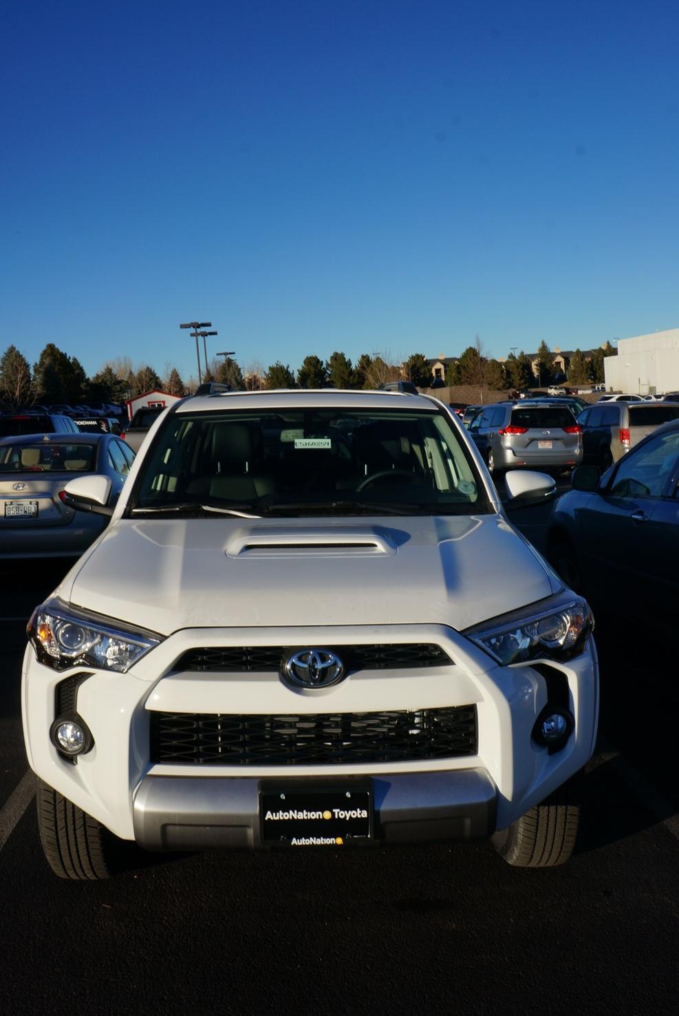

Well took your advise and came home today with a Brilliant White TE Premium! Looking forward to projects ahead, possibly including painting/plastdiping black the flares / silver chin.
