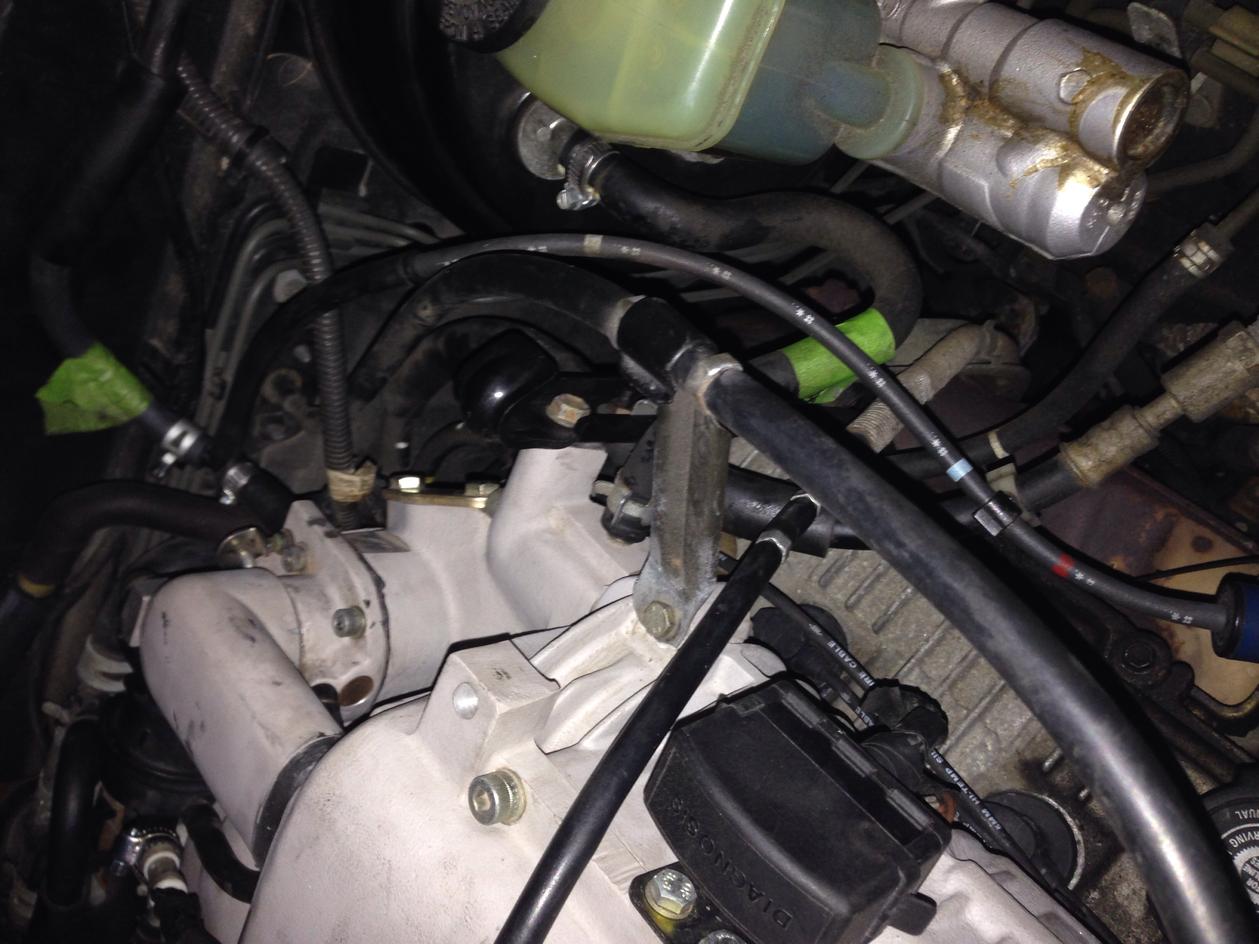

So is it confirmed that the manifold spacer is not needed on the first gen supercharger? "On a 1st gen sc you do not need the manifold spacer... Their is not space. The bracket just attaches to the sc" lhsoulrebel said that and I don't mean to be rude and act like I don't trust him but I would like to hear other opinions because I don't want to be stranded without the part during the install I want to have all my i's dotted before the install.

Ok, not a great pic... But see the grey bit sticking out attached to the long vertical black bracket... That's the where on the later gen sc's your needed a spacer. So no spacer needed on the first gens

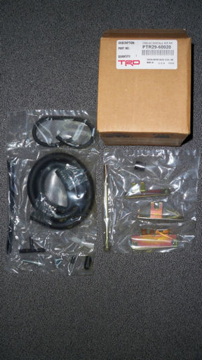

Also when looking at the supercharger instal kit link , I have 170mm bolt and the 3 brackets but I do t have the black piece I see in the picture? Is that a spacer? Now do I need that and if I do where do I find it ? I really don't want to but the whole install kit when all I'm missing is that little black piece

i think your talking about the spacers for the support bracket. you can fab something up or just stack washers like other have said.

im talking about the black piece in the top portion where the long bolt is and the three brackets are. in my bag there is 3 brackets the long bolt and black zip ties? im sorry to be such a pain but i just need to make sure i have all the pieces together

yes its a spacer for the support bracket, it should go on the side of the supercharger. you will see when you take the old bracket off and go to install your supercharger.
That should already be on your truck... Manifold brace maybe... Forget what it's called.
I don't have that piece, so where can I get that ? Sorry to be such a pain
If you have the 1st gen sc, the only bracket you need is for the throttle cables... I didn't use any spacers. The rest of the brackets and cable holds should already be on your truck.
