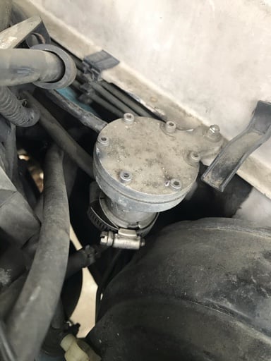

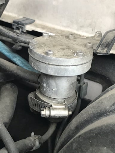

Anyone have an idea of what this is
I’ve never seen it before on another runner
Connects to the intake and fuel return line ?
Just wondering if it would be worth swapping it over or just deleting it. ?

Guess would be an additional fuel pressure regulator. To my knowledge, earlier systems by TRD didn't know the stock FPR could increase fuel pressure under boost (pressure) So basically, stock pressure regulator connects to a boost/vacuum port and it works just fine. I know on the later (black) SC's that's how it gets plumbed. Shouldn't be any different overall on older (grey) ones.
Wanted to show where I read the thing about the regulators. Fuel Delivery
If you scroll down pretty far he talks about fuel and such and how he moves the pressure regulator vacuum hose to a boost port and it increased his fuel pressure naturally.

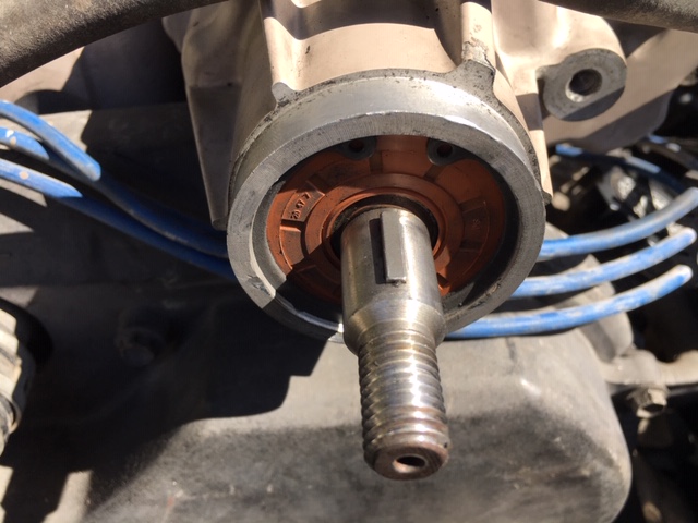

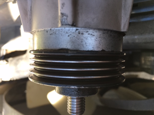

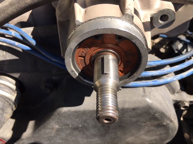

Rebuilt supercharger...now the pulley wont go on
So I got a used gray top 1st gen blower, rebuilt it with the nose cone and rear bearings replacement, and did the mod to the cover.
It all pressed apart great, and when putting it back together, First potential issue I noticed that the nose cone bearings dont "press" into the housing, but more just fell in, and I could easily pull them out with my hand. I figure ill just put it all together and hope itll just tighten up when I finish, so I put the shaft back together and finish assembly.
Now...the shaft is tight on the bearings, however the shaft moves in and out easily within the housing...the whole bearing moves within the case in and out.
Also...thinking this would tighten up with the seal in place and snap ring...nope...
And finally...the pulley rubs against the housing when torqued down. The S/C wont spin at all with the pulley on...and the shaft doesnt seem to pull any more forward when I try to bring it further forward.
Any input? Maybe I missed a washer somewhere? Maybe I got fluke bearings?
Here are the pictures, you can see how far the shaft moves in and out, and the pulley hitting the housing
