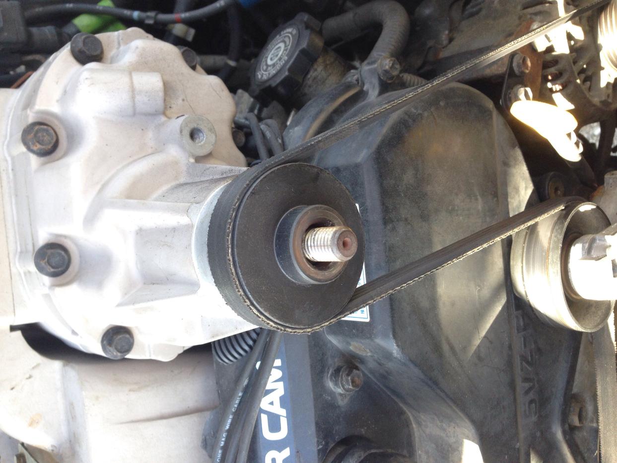

So, I was checking some parasitic battery draw today when I noticed this. See below. Don't know how that happened or how long ago the nut came off. Supercharger seems to be running just fine (I'm not driving it anymore, until it's fixed). My questions are, where do I purchase said nut, can I tighten it with out any special tools, and to what torque setting? Thanks!
My shaft was broken clean off flush at the pulley. The PO said he still ran it like that. I was not sure about that so I drilled, tapped and put a fat washer and bolt in it to holy the pulley there.
Also hit up SC RUNNER, he rebuilds nose cones and might have a nut laying around.
I used an impact gun and 18mm socket, but you do need to use a fair bit of "finesse" or it'll end up like his!
I see that there is loctite on the stock nut, so use it.
The stock nut id 18mm wrench size and looks like coarse thread metric I suppose you could get a nut just about anywhere if you measure the tread and pitch.
P.S. I don't know the torque value but it can't be that tight, it came right off of both TRD blowers I have currently with ease using my 1/2" Makita cordless impact.
(and NO, I don't own 2 superchargers, I am just in the middle of doing another install for a friend)
