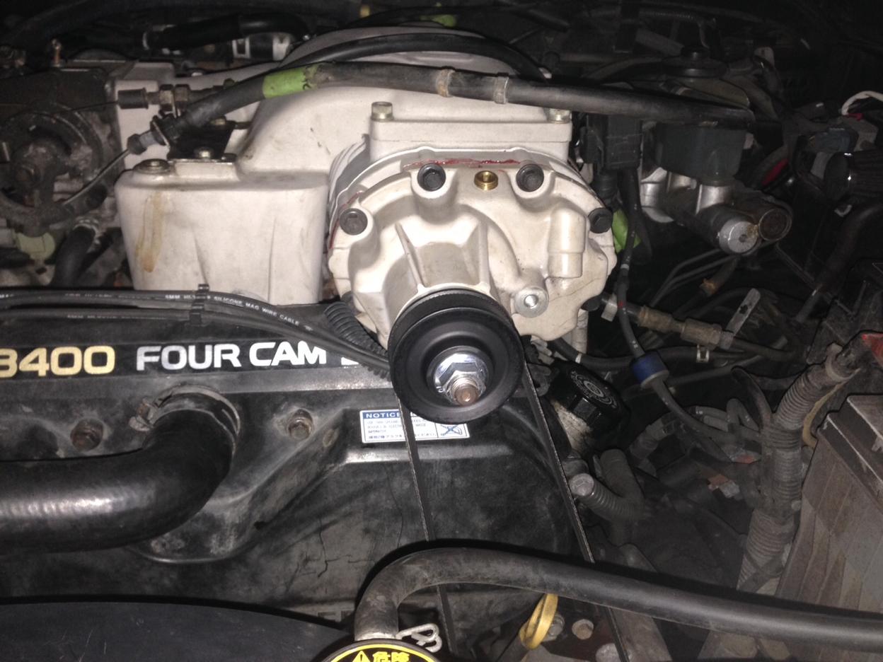

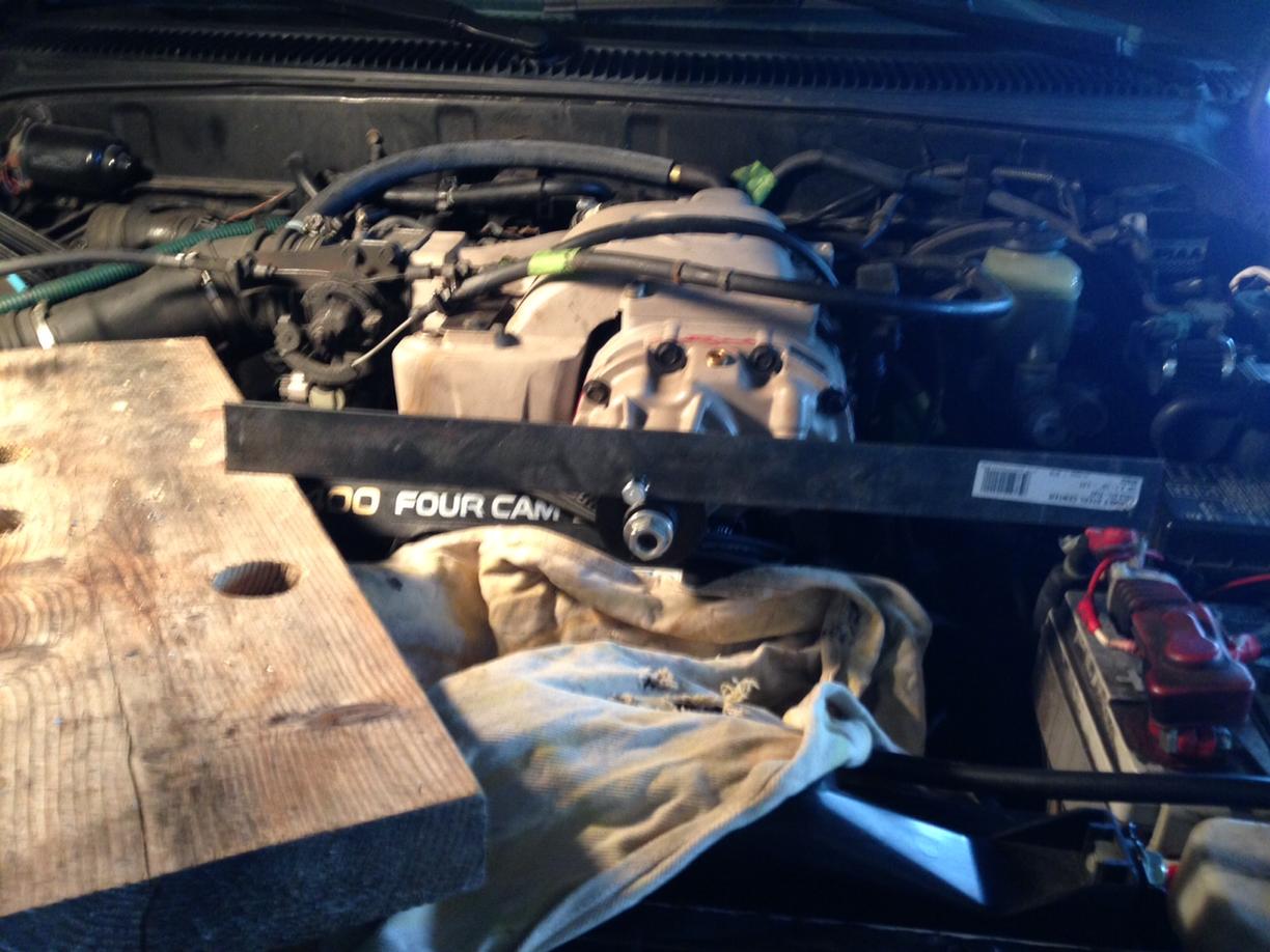

My pulley situation update
I known you guys were all dying to figure out how I resolved my rattling pulley problem ;). So, no one on the forum seemed willing to part with their old stock pulley...I get it, a back up is always nice.Therefor I Spent sometime trying to figure out how to order a stock pulley. TRD wouldn't sell me one with out ordering an entire new nose cone... which wouldn't work for me even if I wanted to spend that kind of money... In fact, the only way I could order a new stock pulley from TRD for the Grey supercharger, was by ordering an entirely new supercharger.... effectively making the pulley $3500! I called magnasun, and they wouldn't sell me one either, as TRD has proprietary rights to their products... they didn't even want to talk to me about it! I didn't want to do any fuel mods, as I had the stock pulley running well with out pinging. So I ordered the closest size I could to stock from pullet boys...2.3". Anyway, I'm happy to report that its running great with out any additional fuel mods!! I'm getting about 8-8.5 psi ( I know that, because I finally installed my boost gauge). I can tell its leaning out a bit at high speeds and high rpms, but no more than it used to with the stock pulley. I don't have a way to check AFR's. Because everyone wants to see pics, see below... I did have to invent a tool to remove the pulley nut... what a stupid design!

Ok... I'm running out of ideas. Trying to get the nut off of the supercharger pulley but the thing is on there really tight. I tried heat, oil, oil filter belts, but it's stuck on there really good. Problem is I can't hold the pulley tight enough to torque the nut off. Even used rubbing alcohol to clean the rubber and metal surfaces for extra grip to no avail.
I do not have an impact wrench or access to one, but not sure that would help since I can't hold the pulley still.
Just saw your post, but it looks like you put a hole in the pulley or something? I have to re-use my pulley again though.

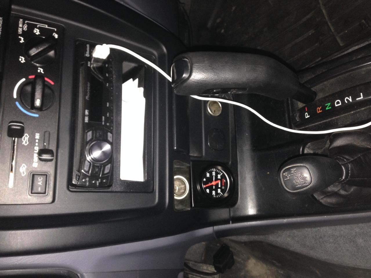

Couldn't have waited? I installed my 2.2 a couple weeks ago. Haha.
How are you getting 8? I'm only reaching 5. And 6 when my 7th injector sprays.
Keep the belt on it. Wedge something soft I between the pilot and belt (don't want to brake the belt or cause a tear.)
Use a rag and wrap it around the pulley with a death grip.
Be expensive and get an impact or have a shop just brake it loose for you then hand tighten it back on. Then go home and change it.
My stock pokey needed pullers to take it off (even heating the thing). But the urd aluminum one slid right on perfect fit.
I drilled 3/4 of an inch into it... The pic tells the rest of the story. I could still use the pulley if it wasn't messed up to begin with. But if you are tring to reuse it, try all the other methods first... Worked like a charm for me though... And I was struggling like you.
Ha ha!! Yeah, the noise was driving me nuts, and I was worried the bearings might be getting damaged from the wobbly pulley. I'm getting 8-8.5 psi, because the pulley is 2.3" v 2.37" that's what pulley boys advertised, I was skeptical, but I feel it, and the boost gauge confirms it. It's running well, but I may add a meth kit in a year or so.... I'm trying my best to avoid tuning!

I couldn't get it off :( I will see if someone has an impact wrench I can borrow at work or if my shop will do it if I stop by. Sucks because all the other threads and how-to's just say something like "just hold the pulley and the nut comes right off". Sure it does!
