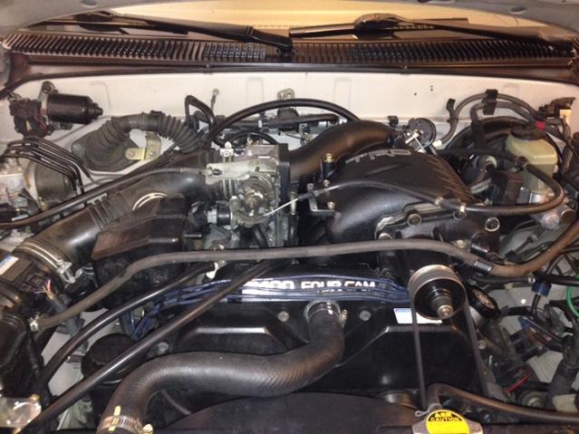

It's alive! And THAT SOUND!
Before:
Six hours later:
All pictures from this point on are sideways. Sorry. I can't stop it.
Honestly, the most irritating part was the power steering belt. And the AC belt. And the SC belt too. Basically, to hell with belts. Also, due to Reasons, I had trouble relocating the dipstick. But as it happens, a dremel is the answer to a lot of problems, so now my dipstick looks like this:
And it FITS, like it SHOULD.

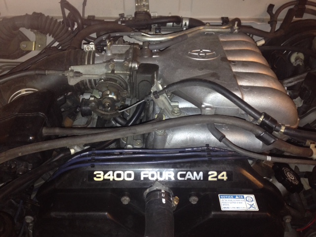

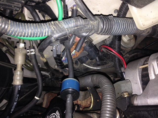

One big unanswered question, though: what's this, and what should it be hooked up to?
It was connected to the fuel pressure regulator before, via the hard line that runs across the lower intake manifold. It runs down to a junction below the fuse-box. But now that regulator is connected directly to the SC, this one is left-over. It's capped right now and everything is working, but I can't leave it at that. I'll go crazy.
Aside from a tense moment at the start (I forgot to hook up the MAF, so the engine would turn over and promptly die), it's running just fine. And that sound it makes when you goose it is going to badly damage my MPG. I swear it sounds like the DeLorean from Back to the Future. I grin like an idiot every time it does it. Strange days ahead.
I'm not running fuel mods yet, just the 170 thermostat (temperature readings are sitting pretty at ~181 so far) and 92 octane gas, but I'm going to play it by ear. MTD's exploration into AEM FI/C modding interests me terribly. I have a set of Denso IK22's ready to go in, but I figured "one big change at a time."
@Oxfded, I have the same question?? Do we cap it off, or do we need to "tee" into a vacuum line and attach it??

No it's vacuum for your 4wd. Try it. It won't engage or disengage I can't remember. I'll get you all pictures in the morning.
I thought that too, but I switched in and out of 4WD a few times during my test drive, no issues. It may be that it just happens to be working without the vacuum assist, of course.
It's vexing because that line isn't on the routing diagram under the hood, and the closest thing to it on the supercharger install manual is a T-junction to the "4WD VSV", which clearly points to it being essential for the 4WD. It would be a relief to hear that most SC installs just T that line from the SC to the PWM-VSV (which doesn't appear in the SC install manual) and connect up this one, but I have enough doubt that I'm still digging around.
Thank you Sir! Yeah...I kinda want to keep my 4x4 working!!

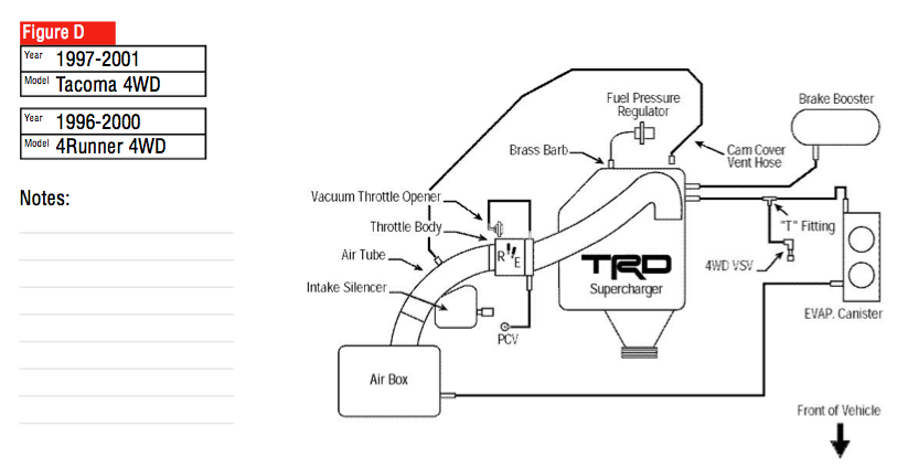

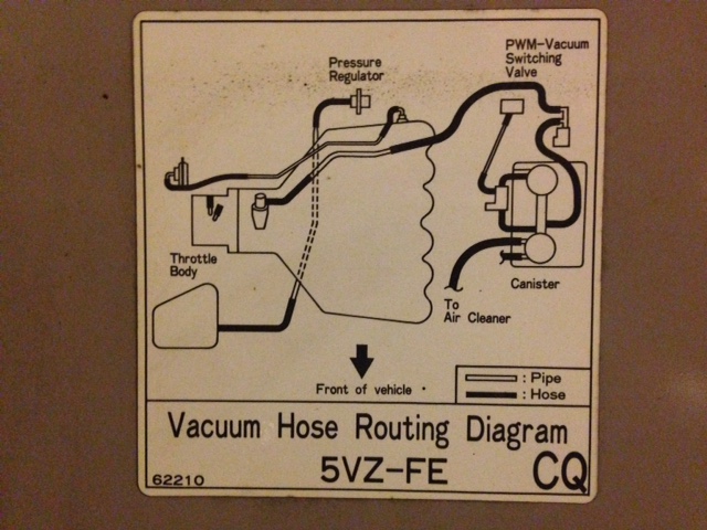

The routing diagrams in question. From under the hood, the stock routing diagram:
And the diagram from the SC install manual:
Note the PWM-VSV in the stock diagram, which is in series with the Evap and missing in the SC diagram. I ran a line from the SC to that, instead of direct to the Evap (like the SC diagram shows.) Something told me, perhaps mistakenly, that the T in the SC diagram actually is that PWM-VSV. I think that's why my 4WD is still working.
The extra bonus line isn't on either of those diagrams, which made me wonder if I was looking at some aftermarket leftover from the PO (which is not without precedent, but it sounds like Russ has it too, and THAT would be a hell of a trick.)

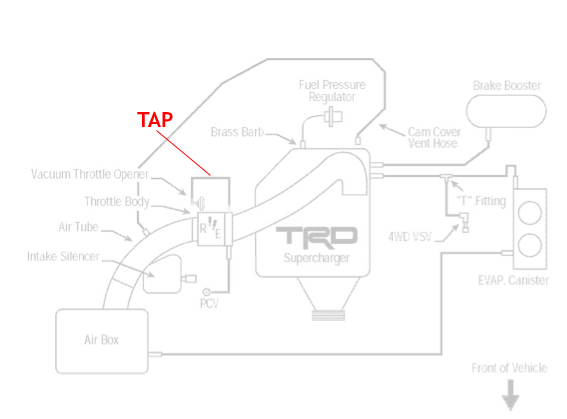

Much appreciated. So you figure this is the 4WD VSV line, and I should tap into the line from the SC to the PWM-VSV?
Yes it is the 4wd line. As you can see it's so much smaller than the large hose that goes on the side of the super charger by the brake booster. I just put a T in where the smaller line goes to the back of the supercharger after the throttle body. Be sure it's not the boost line that connects to the FPR. YOU WANT full time vacuum on that line. The diagram u posted here it shows it with the T but it's much smaller than the line it attaches to

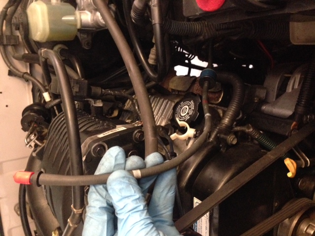

Roger that. To be clear, you're saying I should tap here:
And run the line around the back, which I think I can just make out in your picture.

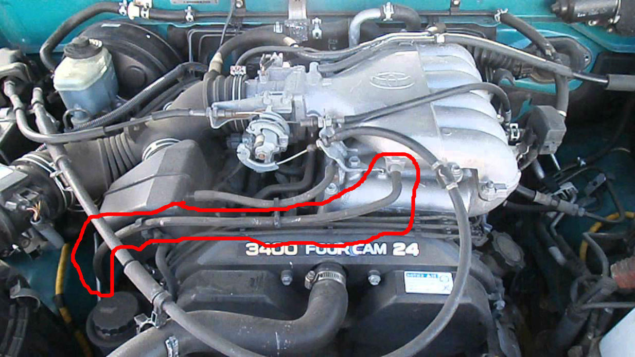

I know the intake silencer is capped off. The line I'm referring to is circled in red on this photo. It runs from the back of the Power Steering pump and used to connect to the upper intake manifold. Just don't know what happens to it now.
Where does the fuel pressure regulator hose now connect? Before it connected to the upper intake manifold. Does it connect to the nipple on the back? I thought that was the boost gauge line? The line currently feeding from the fuel pressure regulator is a bit short and so I don't have it connected at the moment.
I
This is most definitely your rough idle problem... You are basically starving the motor for fuel when you run it without it getting vacuum. It is also where you tee off for boost. I suggest getting a boost manifold from eBay or amzon so you can tee off as much as you need in the future. For example I have my FIC, boost gauage, and FPR off of it now and I will also have to pull for my meth kit from there in the future.
