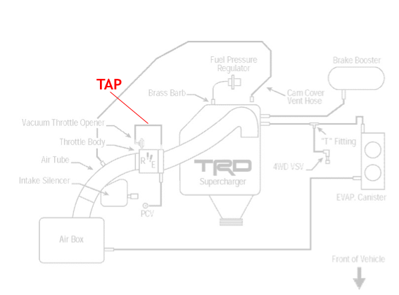

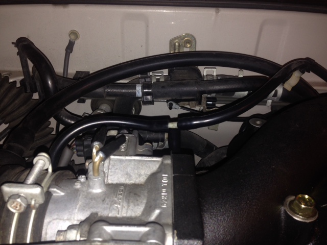

RussToy, is this what you're asking? I took some pics. Hope it helps.

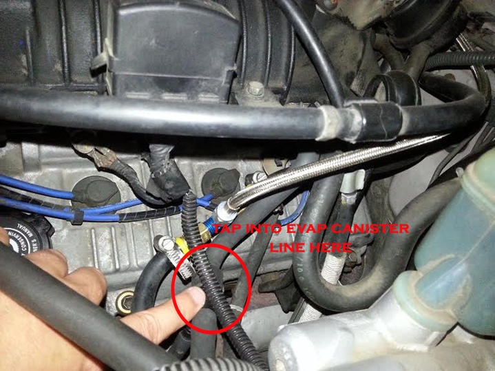

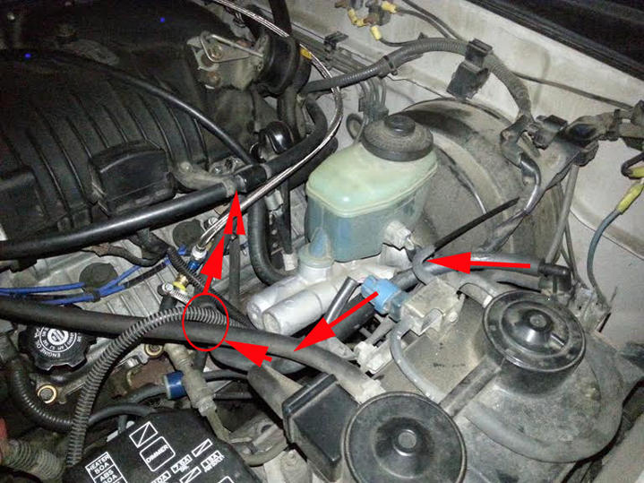

[MENTION=88079]afg10000[/MENTION] Thank you for responding. That's awesome how you can put the arrows and circles on your pictures!!

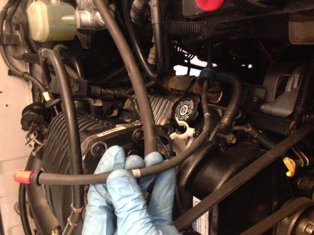

Now the area you drew on, I understand that part...which is in the installation directions. My question is: what do I do with the line that is in his hand? Thank you
No sweat. Pretty sure that's the 4wd vacuum line. I could be wrong but it has to be hooked to a vacuum line somewhere. Originally it plugged into the side of the stock intake. My impression is if that has no vacuum, your ADD won't work. Don't quote me on this but I know it needs vacuum.
You T that line into the line coming from the evap system. Check out page 17 of the install manual. http://www.parksoffroad.com/tacomamods/miscinfo/TRD34LSCInstal.pdf

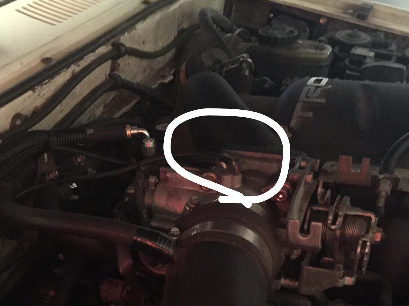

All signs and knowledgable minds point to it being the 4WD VSV line.
I actually followed shootmymime's tip and tapped into the vacuum line here instead, since it's the same diameter and I had a T of that size handy:
It's off the little line you run between the throttle body and the nipple right on the SC:
This choice was largely motivated by the size of the T connector I had on hand, so doing it stock (as afg10000 and SCRunner12 recommend) is likely the better route if you have a T connector of the correct size handy.
And if you don't have one handy, capping it worked fine for me until I made the switch. Didn't affect the SC operation whatsoever.
Totally agree. Every 4WD model I encounter in the shop, that line is simply vacuum supply for the entire VSV (vacuum switching valve) and ADD setup. Mine is a stranger build but I simple ran mine off of what appears to be port "E" in the diagram. The entire system uses a check valve as well as a vacuum storage tank so realistically any vacuum source should suffice.
