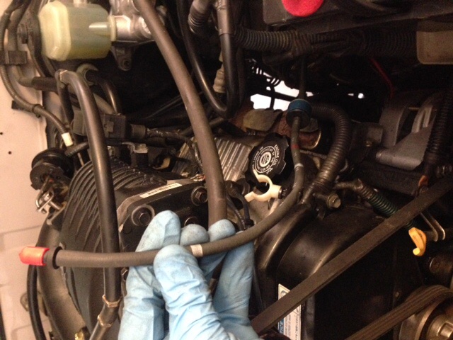

I know the intake silencer is capped off. The line I'm referring to is circled in red on this photo. It runs from the back of the Power Steering pump and used to connect to the upper intake manifold. Just don't know what happens to it now.
Ah, got me stumped there. On mine, that manifold connection was where my mystery line was connected, which shootmymime identified as the the 4WD VSV. If yours is connected to the steering pump, well, that's just interesting.

Thanks for all the help everyone. I discovered that this hose is only on 96-98 4runners. The later generations don't have a hose there running from the power steering pump. They actually have it capped off.

Ok, figured out what I'm going to do. Will run the power steering hose to the intake silencer and remove the vacuum plug that TRD instructs to cap off.
Originally that ran to the fuel pressure regulator so it should work for the PSP.

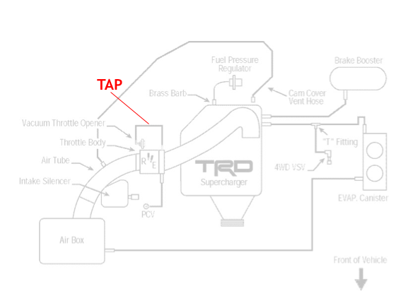

Roger that. To be clear, you're saying I should tap here:
And run the line around the back, which I think I can just make out in your picture.
@Oxfded...I guess I got totally confused :wacko: Just want to make sure I know what I'm doing before I get started....I'm truly hoping for a "no issues start up" :pray:
So, in your above attachment...is this where you ended up "T"ing into for your 4wd VSV line (pictured below)? Or...did you go with a vacuum block attached to the large brass barb that the fuel regulator attaches to?? Or...can I do it either way?? If so, is either way better than the other? Thank you for clarifying this for me! As soon as I get this figured out...I can start my install. Which I'm hoping to do this weekend :dance:
