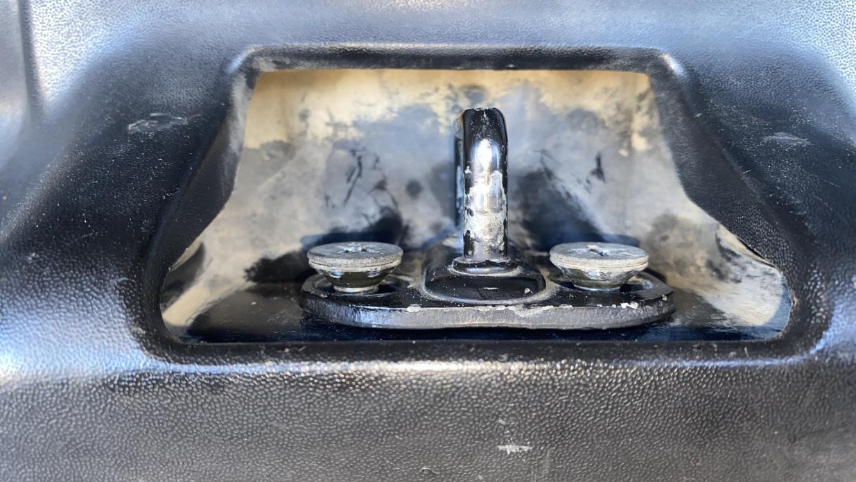

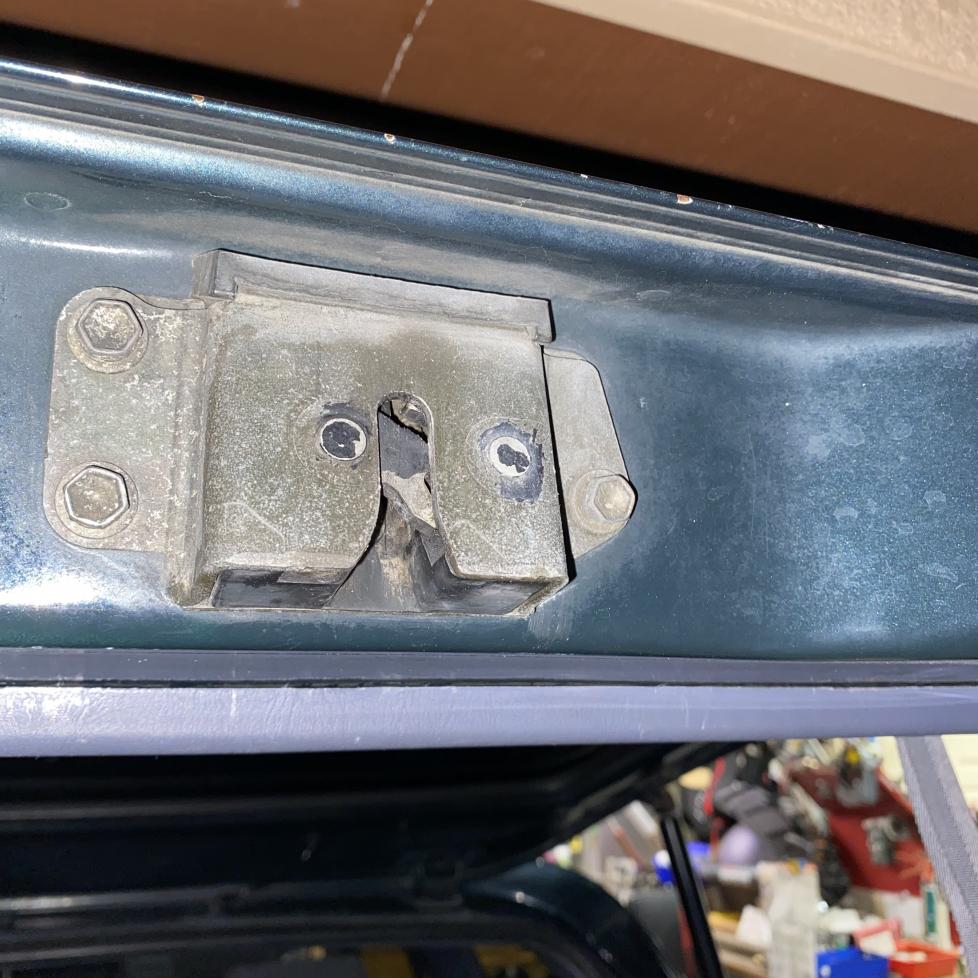

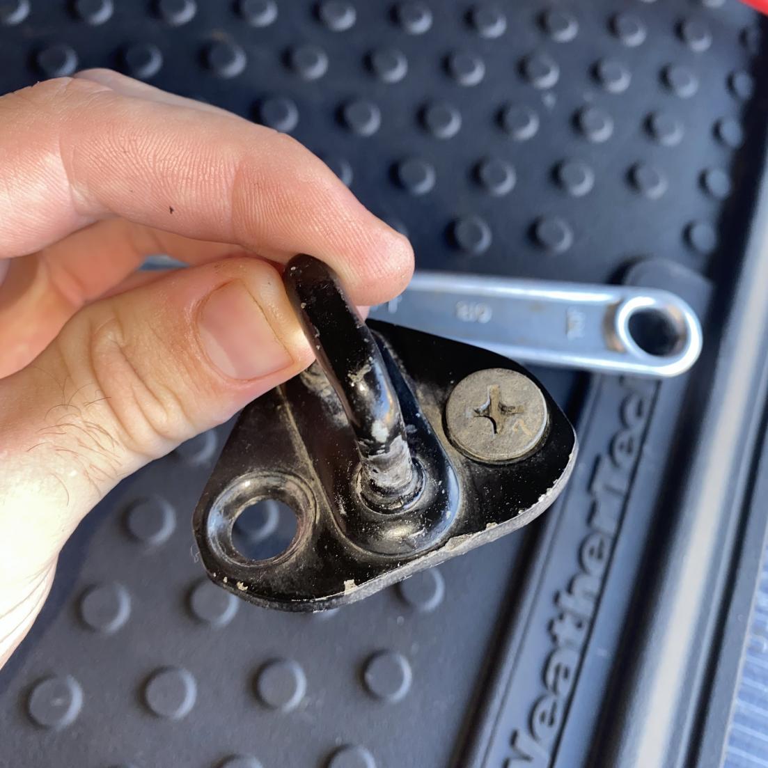

Hard to close liftgate
Hey guys,
Lately I have been having some troubles closing my liftgate. I have to hold it and slam it pretty dang hard for it to actually close. I have seen others close their liftgates & they can just kinda let it come down and it the weight of the liftgate closes itself with ease. It's getting annoying since every time I open it I usually don't do it hard enough for it to close the first time and then I have to it again and close it. You have to kinda do it just right for it to close. I don't like the feel or the sound when I have to slam it, it's even worse with the liftgate window down too it rattles hard. Anyways. So my question is, since it's so hard to close what part would I probably need to replace? I'm guessing the latch would need replacing but I'm not 100% sure. Lmk what you guys think. I tried to lube it up too but it didn't really help
Thanks,
-GH

Hey guys,
Thanks,
Move the striker in towards the weather stripping a little.
Just went out to my truck right now to try that. The strike plate uses counter sunk screws on the top of the plate so no matter how you move it it ends up being automatically centered by the counter sunk when you tighten it down, basically there is no way to adjust it the way your suggesting. The plate always goes back to the same position. The latch operates fine but it looks like the rubber is all worn off so not sure if that has anything to contribute to it. :banana:
Tighten the screws snug not overly tight and tap it with a rubber or plastic mallet.
