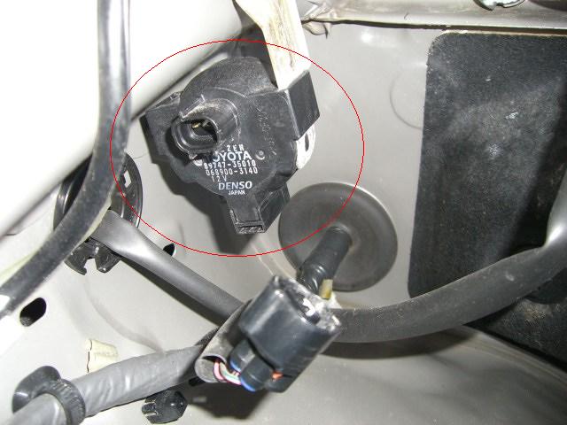

Does anyone know of a quick way to determine if a 2000 SR5 came equipped with key fobs? The vehicle in question only came with 2 valet keys.
Look for the "chirper". It's in the rear corner, passenger side of the engine compartment, on the inside of the fender. (Answer valid only for '99+ 3rd gens.)

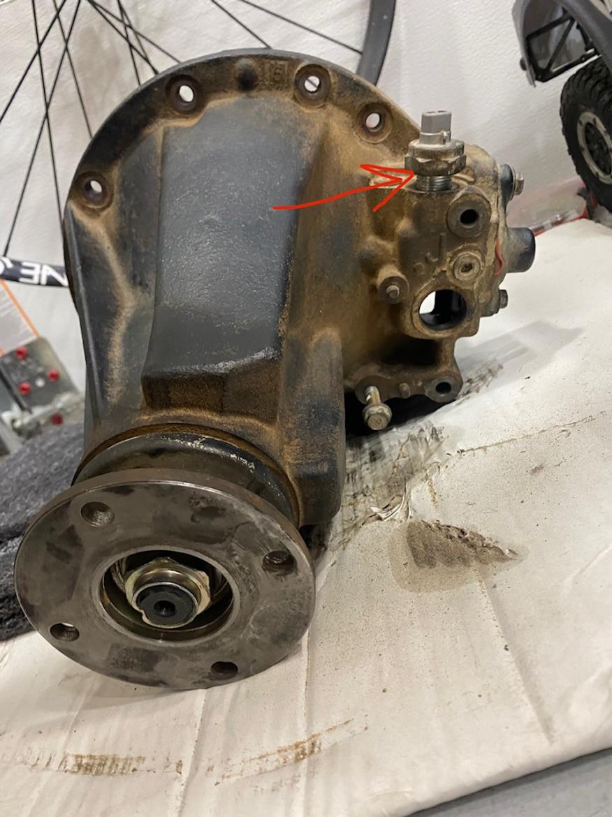

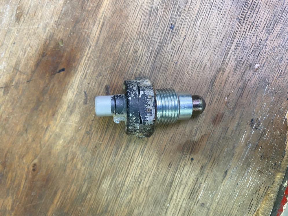

Hey there guys,
I recently pulled a e-locker rear end off this guys rolled 3rd gen so I can swap it over to my 1998 2WD. I've been taking notes / part #'s of things I want to replace. One of the things I want to replace is the sensor that sits on top of the 3rd member. It looks like a knock sensor for the engine. It's the switch / sensor that tells the computer that the e-locker if it is on or off. I asked my local Toyota dealer guy for the part number and he provided #84222-12010 saying that it is the right one I am looking for From what it seems like, the same switch is used also on the transfer case as the 4WD switch. I was going to just buy an aftermarket dorman switch since it's not a crucial part & it's easy to replace if it ends up being no good, so no need to shell 88 for an OEM one, yet.... My question is should I be fine just using the 4WD switch for my e locker. The switches look identical and they are both 2 prong switches.

Should be fine if the plug matches.
