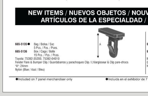

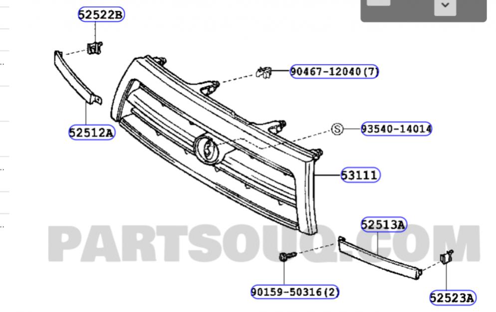

Trim Clip Question
ANSWERED!
PART NUMBER IS 52523-35030 $6.47 AT MY LOCAL DEALER.
IT SLIPS OVER FENDER BRACKET AND HAS DOUBLE SIDED TAPE.

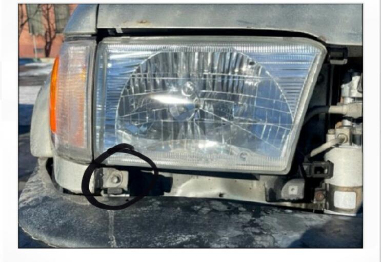

Hey Guys, Got my runner Wrecked in the front end and in the process of putting it together. I was curious if someone could tell me how the Headlight Molding trim is secured Left and Right toward the grill in the middle and left and right near the fender? Yes I have looked at parts Fiche, But it doesn't clearly show how the trim is fastened to the grill, or on the outside left or right sides.
My fenders are a bit mangled where they bolt together near the headlight housings. I do see there is a clip (Attached) that secures the trim below the headlight. But does the Clip pass through the Molding, then snap into the grill? Is there a bolt for the far left and right sides?
2000 4runner Fat lip.
Thanks in Advance.

Remove the front grill and you will see a bolt holding that piece. remove it then swing it out gently about 90* don't force it, then lift it and it should release.

Ok, do you have a photo of what the part it swings out looks like? Again mine is wrecked and I may have to get creative and create a home for the clip to dock into.
I can't get a photo right now.
The headlight bottom trim is attached on the front grill side with a bolt and a clip towards the corner light.
