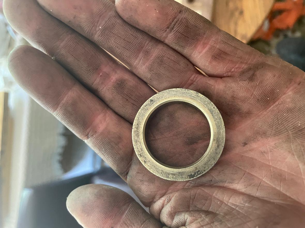

Hey folks,
My question is what is this part?
I did the CV axles on my 2001 4runner 4WD today. After removing the old CV, I moved the hub/knuckle assembly to the side and this part fell to the ground. No grease on it. I can't figure out what the heck it is.
The strange part is in the meantime I did the CV on the other side and found nothing ressembling this part.
Any help would be appreciated! I feel like an idiot.
