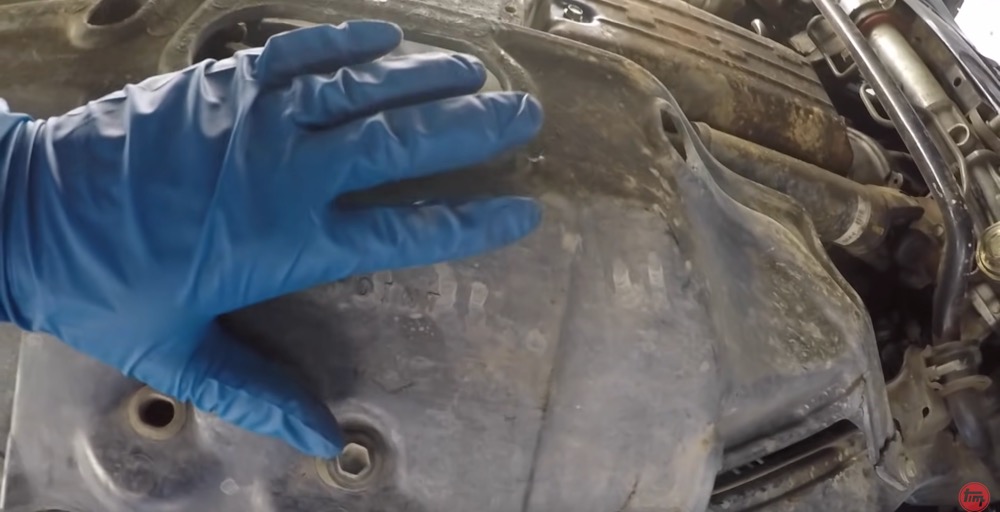

Is there supposed to be cover over the fuel filter on a '96?

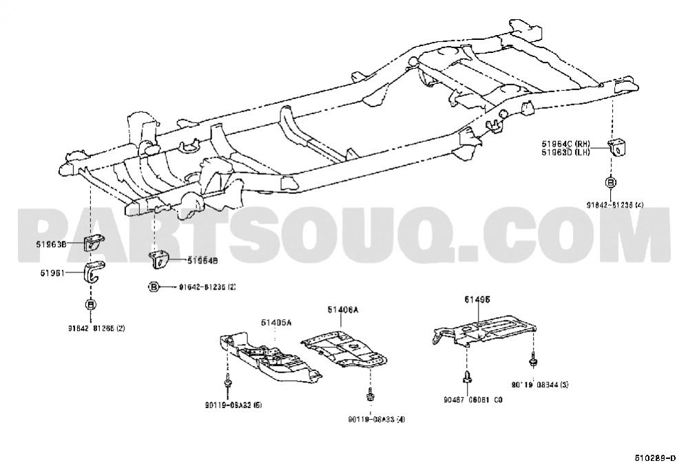

I changed the fuel filter in my '96 SR5 4x4 last year and at the time I thought I might be missing a cover that I'd seen in Tim's video. I finally did some digging but haven't been able to find a definitive answer. Nearest I think I've gotten is this diagram at PartSouq (51495) but they don't even give it a name and it's not linked to anything on the site.
If a cover is supposed to be there, does anyone have a part number? I'd ask Josh Young but I detest using facebook.

I've never seen a cover on the fuel filter, I can ask Josh for you if you like
Thanks man but I can stomach facebook long enough for this!
FWIW, it's more than just a fuel filter cover, but it does cover the fuel filter.
There was a plastic cover/shield over the fuel filter area, but most have either been broken off or left off. There’s really no reason to have it unless you want it. It’s too flimsy to provide any protection in my opinion.
51495 - COVER, TRANSMISSION UNDER
51495-35010( 1 ) (08/1997 - )
It's listed as available 08/97 = 98 model year.
