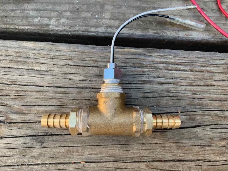

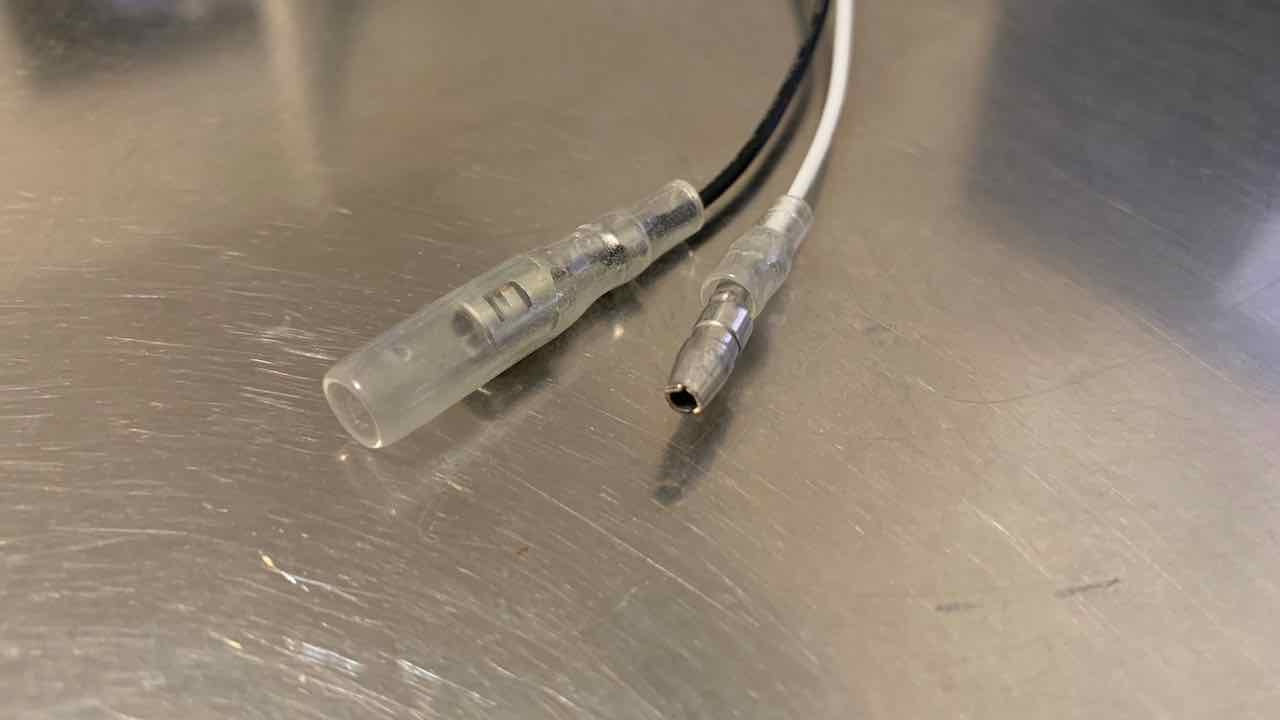

Got the interior wiring done for a tranny temp gauge but I'm missing the "supplied" male/female connectors for the sensor wires.
Two Autozones and an O'Reillys and nobody had anything.
What's the proper name for these connectors - barrel, bullet, something else?
More importantly, this being a temp sensor, is there anything special about these wires or could I just cut them off and use my own connectors? Wanted to ask before I cut, just in case.
there only there to make sure to don't mix up the connections, u can cut and put any connector u want...
I figured as much since there's nothing special about the wire between there and the gauge. I'm not above looking like an idiot just to make sure. But you guys already knew that.
