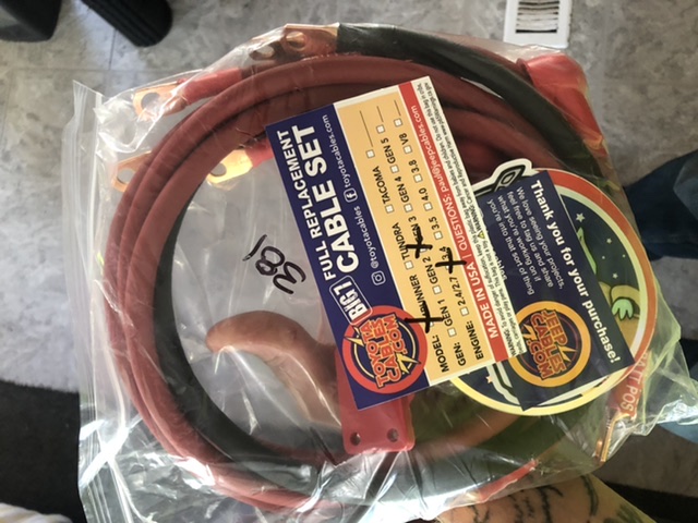

Not a bad price for what you get there. Especially considering its all premade and crimped to the right length. Seems worth it to me just due to the amount of time to build all of these 7 cables.
Yes, not too mention copper wire is getting stupid expensive too. And copper lugs are ridiculous if you buy small quantities.
Just came in. They are beefy
