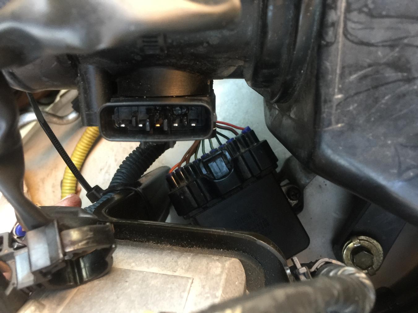

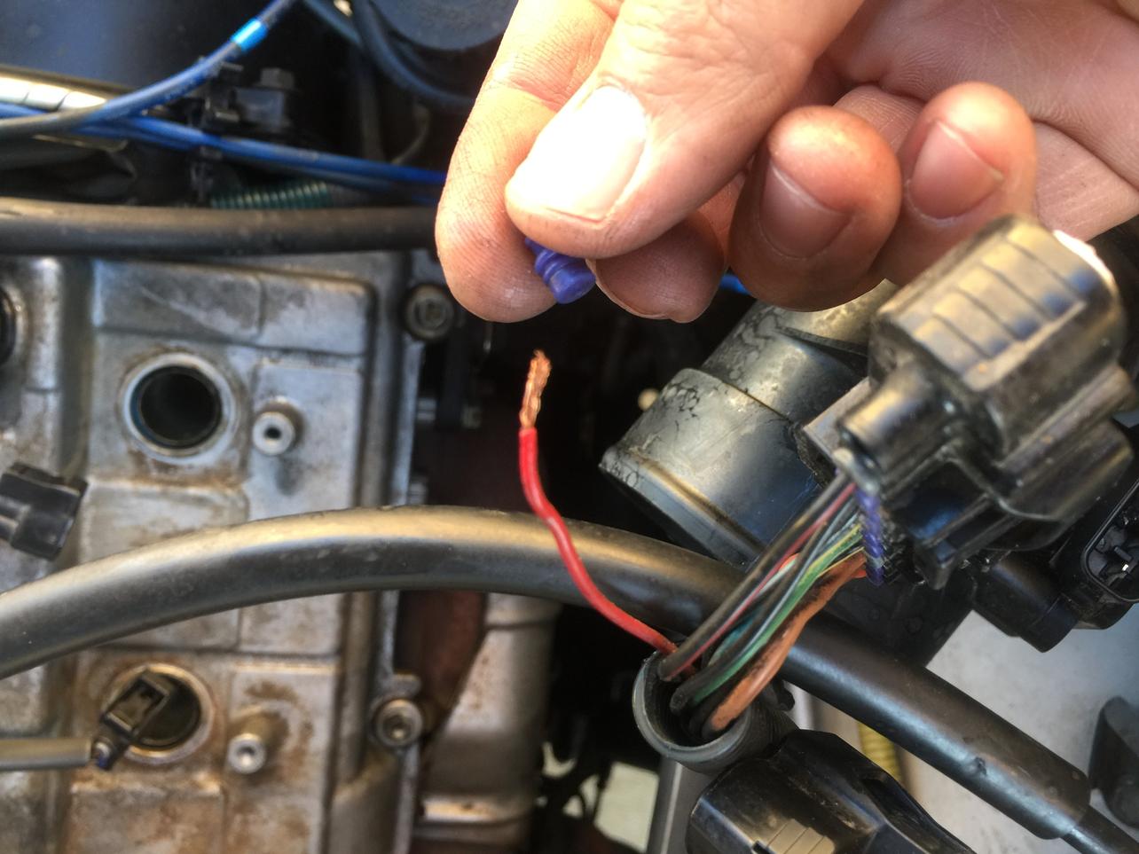

Like you I went down the troubleshooting list according to the FSM. I found a faulty ignition coil and corroded spark plug wires, leading me to believe that was the primary issue. While I waited for both those items to come in, i decided to clean out all connections electrical plugs. Like you, I found the red wire coming ever so slightly out of the plug that goes into the ignitor. I was able to re secure the wire back into the plug and zipped tied the wire-loom that leads to it to the bracket next to it. I suspect that the constant moving of the wire caused it to pull out of the plug. After fixing that wire and installing news coils and wires and clearing my codes, I'm happy to report no more P1300 CEL codes.
